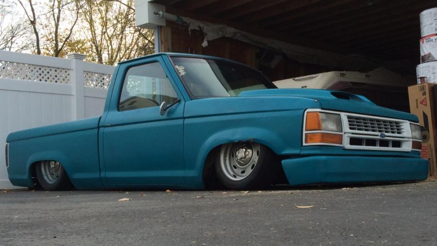

I have a 92 ranger that is bagged and body dropped so that it lays rockers on the ground I was wondering if I can put a 99 front clip on it fenders hood everything I already have the 99 but just want to make sure it is possible to do before I try it any advice would be great thanks ahead if time
No disrespect, but if can butcher up the suspension like that, slapping a few body panels on it shouldn't be any kind of a challenge.
