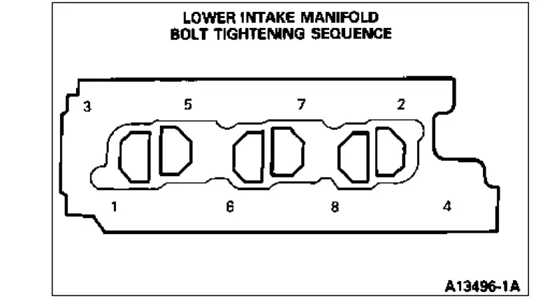

Whats the intake manifold torque sequence and specs for the 86 2.9? I can't seem to find the sequence anywhere and a lot of places say conflicting torque specs
Nevermind, I got it. 6 FT lbs at start, then 11, then 15, then 18, then finally check and retighten after warmup and this is the order.

What did you get that from? I thought just about everything worked from the inside out, but that way works it back towards the middle
When actually doing it, I realized I'm dumb and thats for a 4.0, so I just did criss cross middle working out
