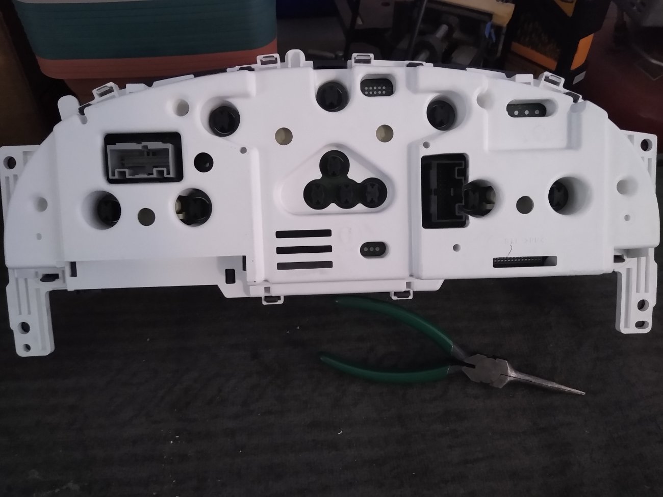

Thank you all for these wonderful helps. On this topic. I found on my 2005 Ranger that with rubber gloved fingers, I could remove the bulb from the Toshiba V-2 base. I just wiggled the bulb and pulled, and they came out (2 bulbs were burnt out). I purchased a couple Sylvania 2721 bulbs (12V, 1.2W) for $8 at local auto parts store, and they went in and worked.
