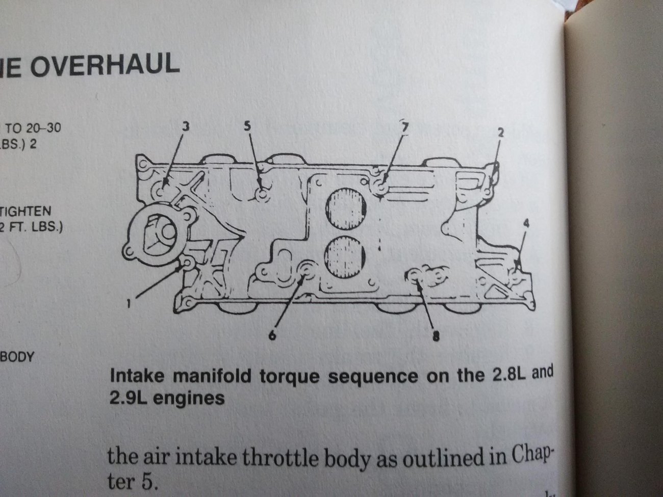

Here's what Chilton gives as the torque sequence:
To me this seems goofy, I've always thought that with manifolds and heads you start from the center and work out toward the edges. I'm wondering if I I'd be better following this sequence for the first one or two torque-down steps and then going 5-6-7-8-4-3-2-1 for the higher torques. Chilton has it this way for the 2.9 and 4.0 engines but basically opposite for the 3.0. Since my gasket has no preinstalled sealant I'm also thinking about first installing it dry at low torque and leaving it overnight so it gets used to the shape and location where it needs to be and I don't smear sealant everywhere when I'm doing the final install.
What have I missed, and am I out to lunch somewhere? Many expert members here, and I'd very greatly appreciate any tips, guidance, or feedback people can offer before I get started.
I would follow the instructions and not deviate much from them.

Many thanks, I'll take your advice and follow the torque instructions. If I deviate from it at all it won't be until the final torque after a few warm-ups.

I have seen where you start in the center and work out and the way you just pointed out in Chilton. I would go with the manual on this one but don't think center to outside would hurt you either. I would recommend getting the blue Fel Pro valve cover gaskets when you get to the point. A little more pricey but so worth the money in the long run. Been a long time since I did the lower intake so not much help there.
