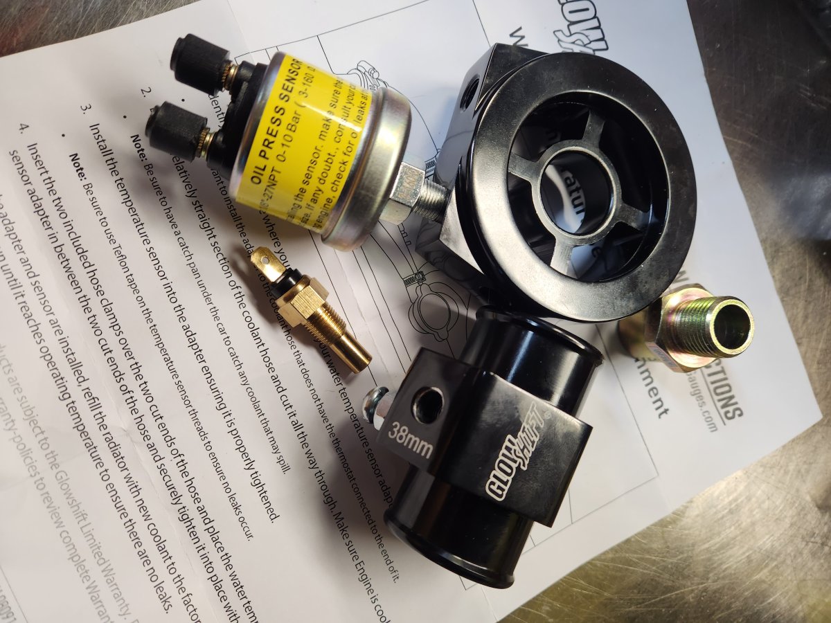

I went with oil filter sandwich adaptor and a hose adaptor fir temp. I've used Glow Shift adaptors... get them on Amazon.

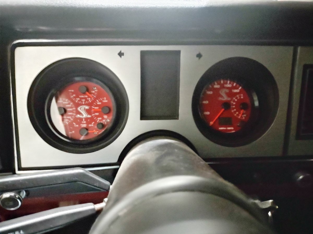

I like Autometer gauges but prefer to mount them in the dash and eliminate the factory gauges rather than have duplicates. It's more work but it looks way more finished and it puts them where they're easy to see, not below the dash. I also buy gauges with letters, pointers, and backgrounds colored like the originals.

I run a direct oil pressure gauge. Don't trust electric. I would love to see how you mounted gauges in the dash, any pics?

I agree! More work but way better looking
