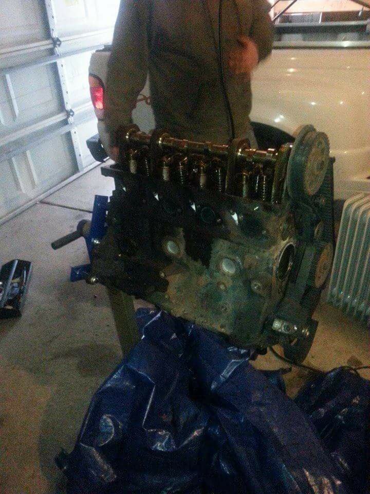

I’m ready to drop in my salvage engine on my 96 ranger, for you have have done this, how much of the motor can actually drop in all put together? The wiring harness has me a little concerned, do you plug in everything on the motor before dropping in? I have most of the motor together minus the throttle body and upper intake

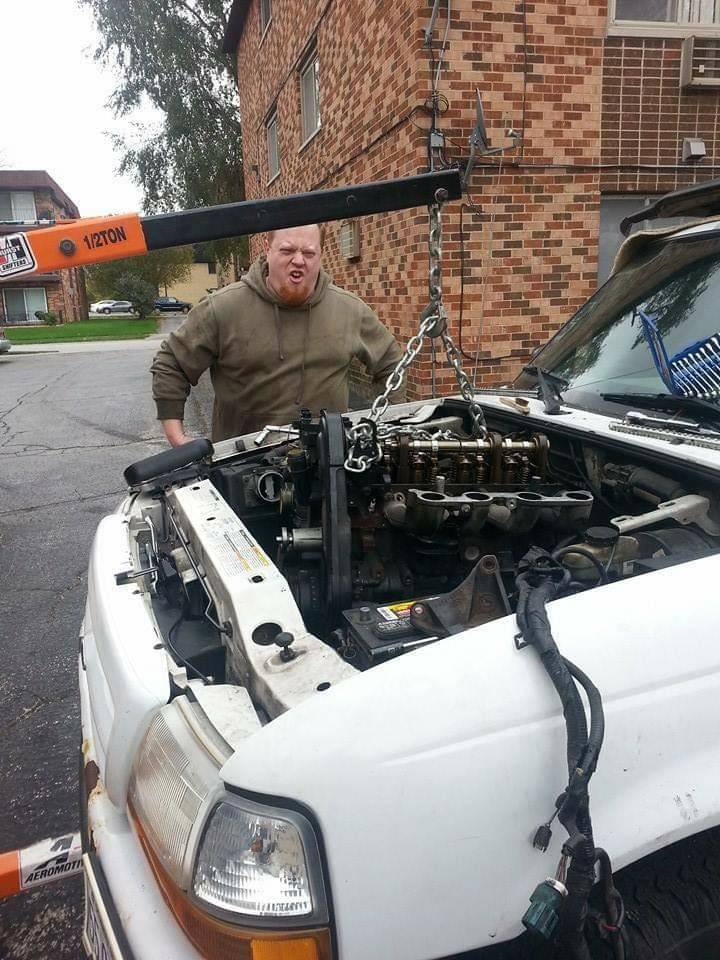

I dropped the whole motor and trans in with wiring harness, manifolds, throttle, all of it. Only things I left off were the ps pump, alternator, and the fan.
