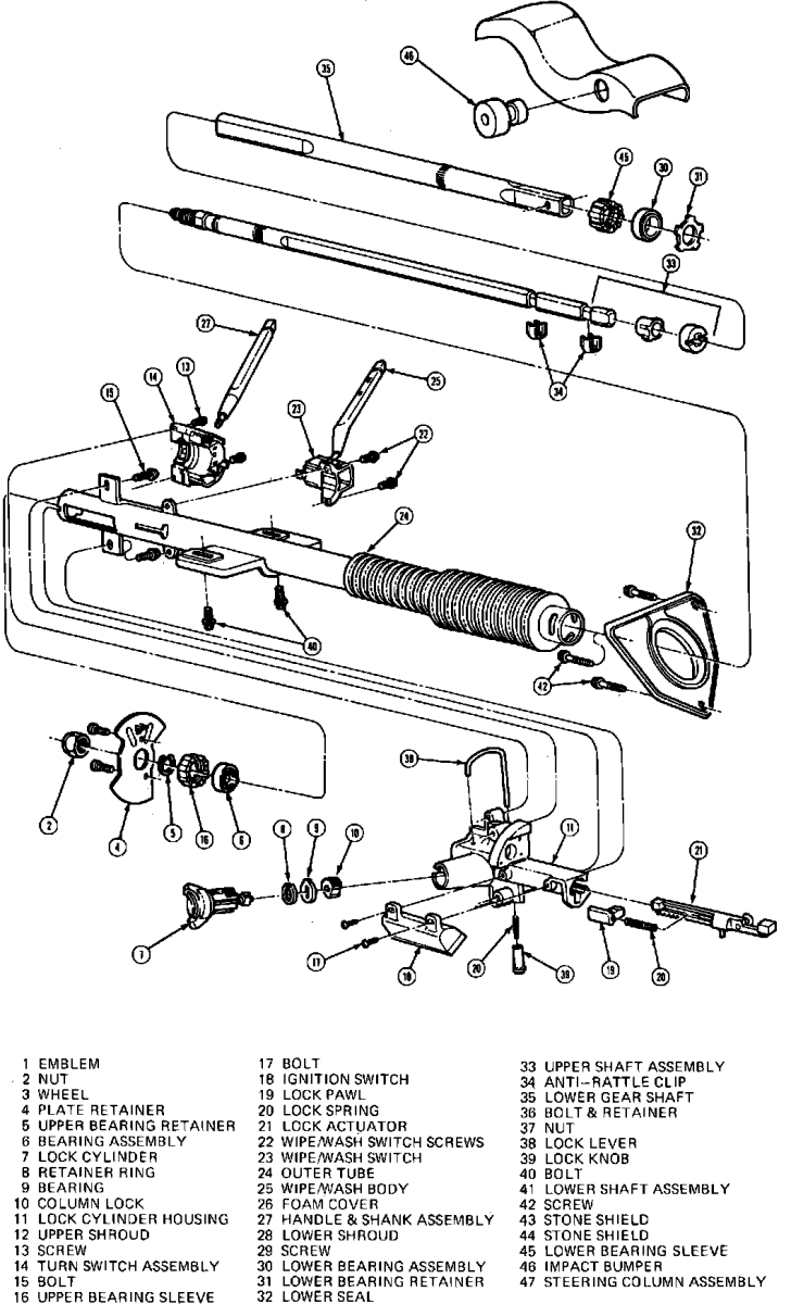

I've seen diagrams and have looked on charm.li and found that to replace upper and lower, you have to "separate" the column. Now, I truly don't know how to do that, as the information says just to simply pull it apart. I only have one of these columns and am in no position to just get another one so any help would be nice. I did find the bearings, upper was F23Z3517B which IS nearly universal across the whole ford lineup, yet the lower is/was unobtanium and had to resort to buying a NOS lower. That PN is E5TZ3517A.
Anyway, just looking for how to actually replace those bearings. No other thread has covered it, only mentioned column noise. Thank you all.
Charm.li instructions below:

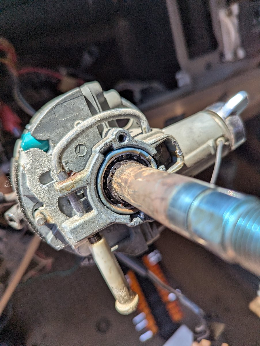

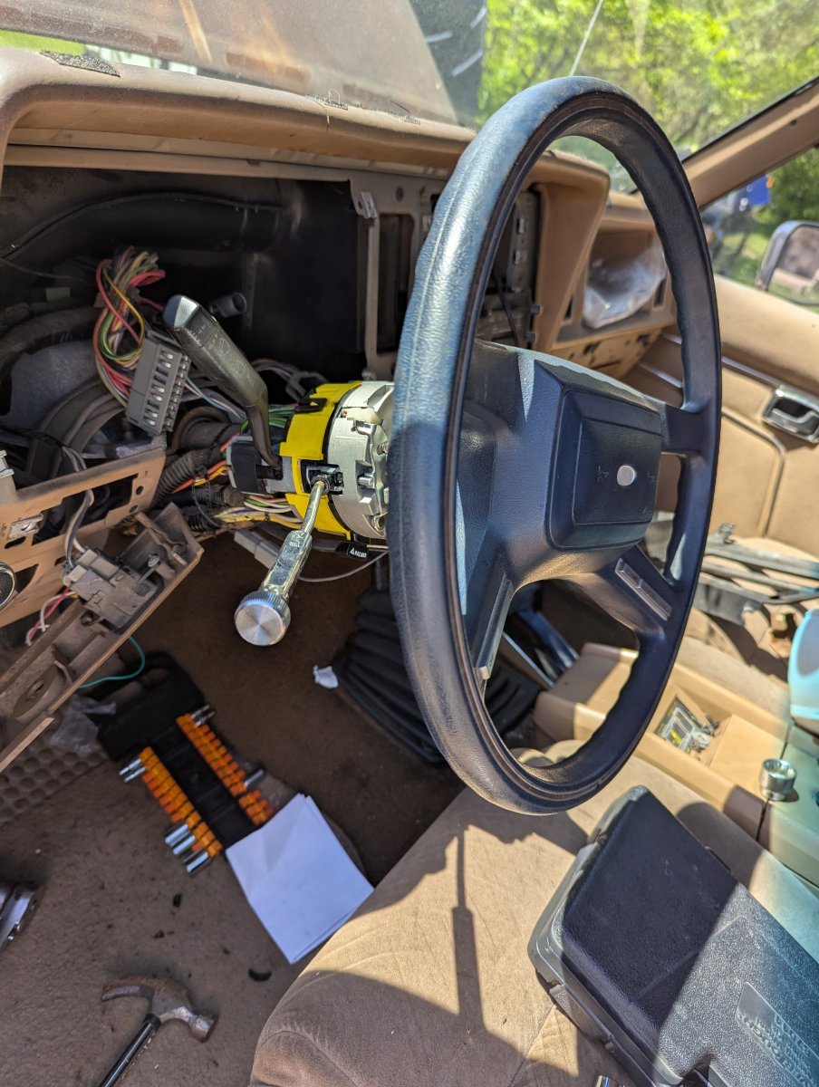

Tunnel vision is a cruel mistress, the bearing wasn't my problem, it was the rubber washer around it. I replaced it with whatever I had and now the slop is gone! To replace the bearing, pull the wheel using the bolt holes (5/16-24) remove the horn contactors and the steel bracket, the circlip, and work out the bearing with some screwdrivers. Punch the new one in with whatever you have, replace the rubber ring, and you're all done. Took the time to throw in an LTD wheel because I wanted it, not the color but it's proof it fits lol

Is that cruise control buttons on that wheel? Ideas.
Seriously thought about adding cruise to my truck. Holding the pedal gest old after about 3 hours.
You will have to add the third wire in the contactor to the cruise module or whatever, this truck and that wheel together makes the "on" button honk the horn, although you can mess with the plugins behind the horn. This is just one small part of the whole big problem of adding cruise, imo I'd add the vacuum canister kind of cruise that thing is awesome
On honk is funny. IDK why.
I think I've moved to a second contact on mine already because the first one was worn out. Not sure if that was this truck or not.
You'll have to add a pin and a wire to the little holder behind the wheel (which you need to pull the wheel to access, ask me why) just to get into the third groove, something tells me the circuit uses a 5v reference...
