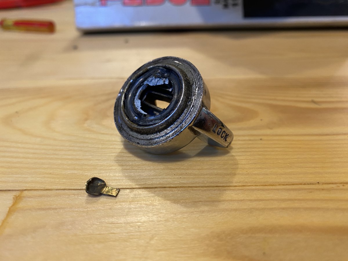

1987 4x4 2.3L Ranger, trouble-free for the two years since my last emissions test, where I went through the entire emissions train (by the manual), and tuned her up. My next emissions test is Tuesday, so the truck has chosen this exact moment to surface a few critical faults all at once.
Fault 1 - one week ago
All dash functions died while driving. No fuel gauge, radio, etc. Unplugged/inspected all fuses on the side of the road and fault disappeared, nothing replaced. Figured it was a fuse blade short.
Fault 2 - today
Try to start truck, no response from starter when the key is turned. Battery light is ON, so I remove the key to go inside and fetch the trickle charger. Battery tests above 12V+, no symptoms prior.
Fault 3 - immediately after
Try to insert key again to check the idiot lights, and key won't insert. Stops 3/4 of the way in. Wiggling doesn't work. Turning steering wheel doesn't work, wheel gets locked. Remove shroud, lube cylinder inside with aerosol graphite, tap cylinder in various places with a brass hammer while jostling the key. No dice.
Other Details
  • The ignition switch is <1 yr old, OEM part
  • The lock cylinder and keys are original, also tried less worn copies
  • I assume the cylinder is locked in the OFF position, since I was able to remove my key before it locked
  • There is nothing wedged inside the lock cylinder, it worked once, then 30 seconds later it didn't. The key I was using is intact.
  • Zero symptoms on the lock cylinder beforehand, no stickiness, never needed any pressure to use it.
  • I use a battery shutoff blade switch, mounted on the negative terminal, to avoid parasitic drain between uses. Closing that switch today activates some relay-type noises, which I've never noticed before. Don't know why they'd be energized before the key makes it to ON position.
So, I'm planning to replace the cylinder lock at a minimum, although the Ford manual gives no procedure for this when the cylinder is locked in OFF. It's my experience that concurrent faults are usually related, but I don't see how in this case.

Update: easy as described. The chrome trim hammers off from behind, breaks away fairly easily, soft metal. The lock cylinder terminates in a flat paddle, with a matching receptacle inside the column bore. The cylinder itself is keyed, so theres only one way to insert it, not possible to screw up the alignment on reassembly.
The little cupped brass piece in the photo was blocking my original cylinder, once that was removed the original lock worked just fine. This made it easy to remove the old cylinder, thankfully.
So there was something jammed in there, I assume a stray part from the original cylinder. Just didn't see it until the chrome trim was gone.
My other electric symptoms shouldn't be related, there was no play in the original lock cylinder or the paddle-to-switch linkage. Will come back if that resurfaces.
