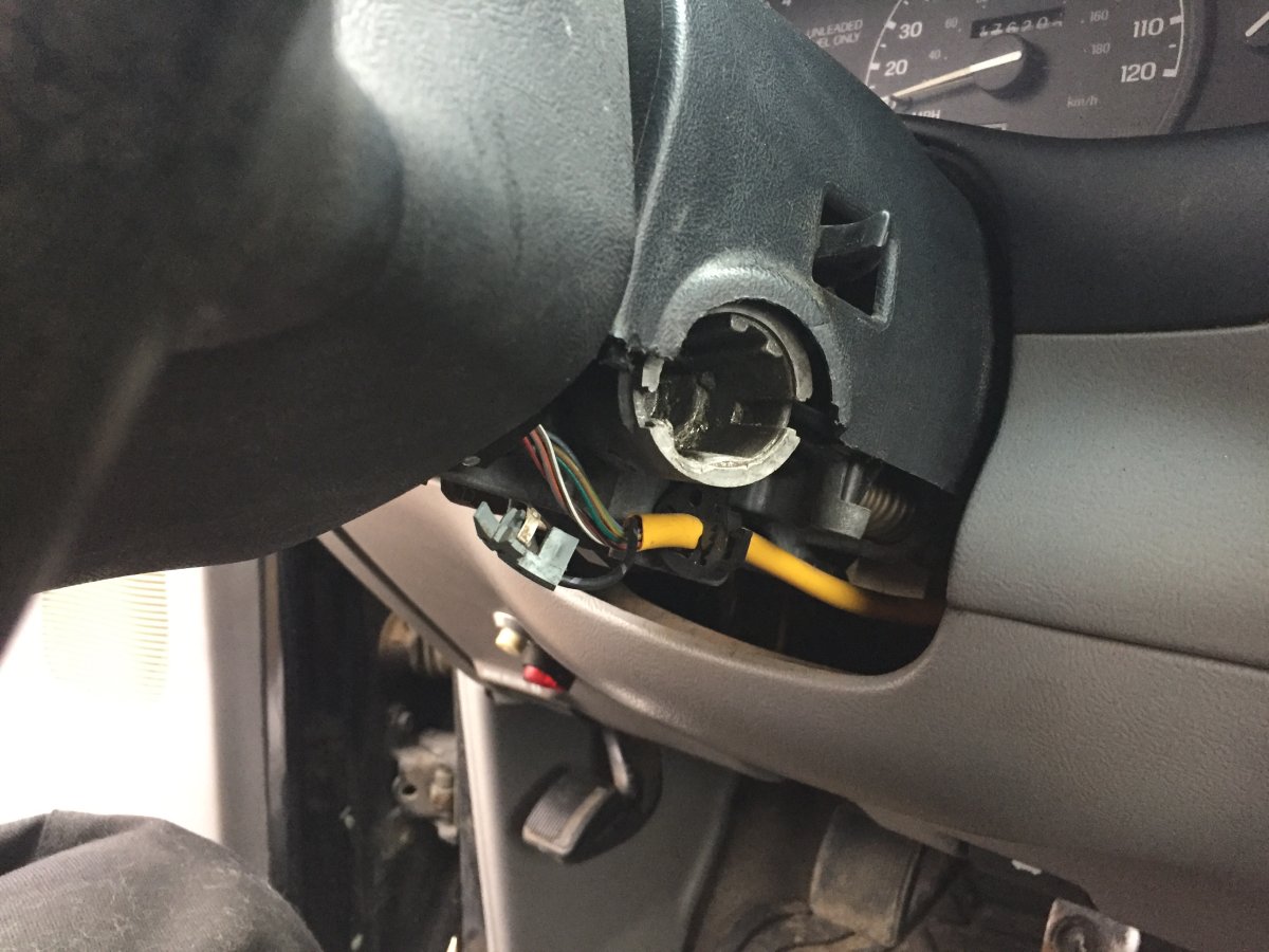

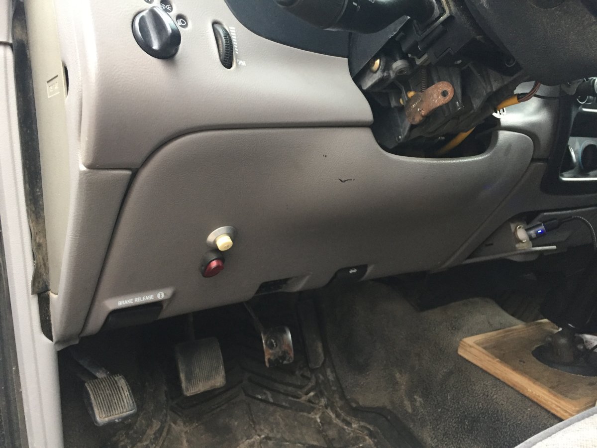

I might could be able to help. Recently I bought a 95 Ranger vandalized with ignition key switch assembly ruined. I did exactly what you are wanting to do.
The old cylinder was and is in the run position so it was always on which makes is easier for these purposes. Under the column I found the power wire to the ignition switch. I spliced in a toggle switch. This gave me key on and key off. I then found the start wire under the column and took a second draw from the toggle switch to a momentary switch then to the start wire. Now the ignition is off when I turn off the toggle, on when I turn on the toggle and it will start when I push the button. All safety features still apply. Clutch switch and neutral/ park switch.

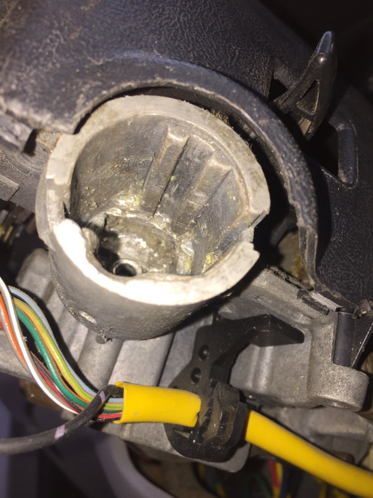

Thanks for the details. In my case, the old cylinder is gone and the area of the casting that holds it is broken apart somewhat. Regardless, I'm pretty sure I could manually fix things to the Run position as you did. Did you have any concerns about it moving out of that position on it's own or did you lock it down in some way?

That is correct. The toggle shuts it off. My ignition was in on position when I got it. So if the battery was hooked up the ignition was in the run position. It’s a stick shift so in neutral I could jump the relay to start it. Then hold the brake and let off the clutch in gear to stop engine. The aluminum structure around the key cylinder is destroyed but with patients and a screwdriver you could get to the slide fir run and start. Is your steering locked. That will be an issue. Is yours in the run position? If your can’t be put in the run position it will be a lot more work. I bought the truck for parts but it has little rust and ran good so I kept it. It was an abused work truck then vandalized so she ain’t pretty. I’m not to worried about it getting stolen. Those things are a rare occurrence where I’m from.

It no longer has accessory. (Radio play while parked) I think that is a back turn not forward, at least old school ignitions were. I think my Super Duty and BIIs are that way. I have a Bluetooth speaker I can use with my dumb phone if I need entertainment. 😁
