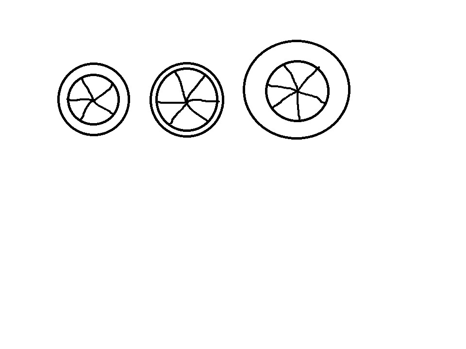

I'm not sure if this'll help or confuse you more.
The first two tires have the same diameter, only the rim size has changed. The combo with the larger rim is not any taller than the one with the smaller rim. On the third tire/wheel, the rim is the same size as the smaller rim of the first two, but with a much larger tire. As a result, ground clearance has increased.
