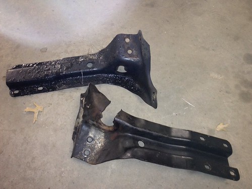

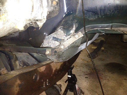

Next was time to replace the radius arm brackets and bushings. Again another hack job on the one side:
