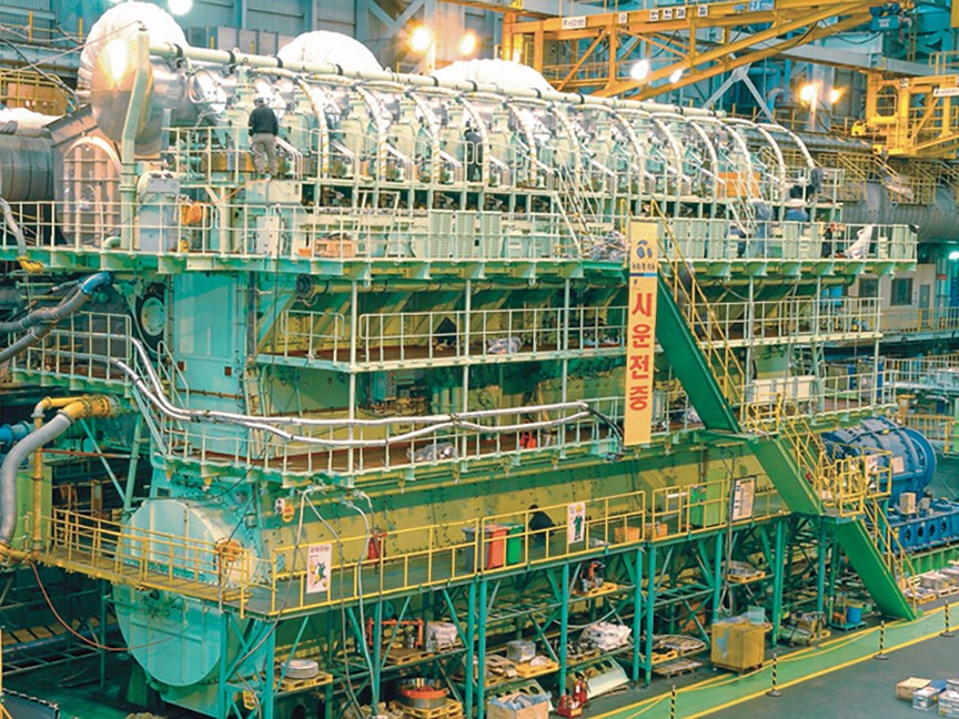

Well this engine is in a ship and ships float. If it was heavy, the ship would sink.
49594

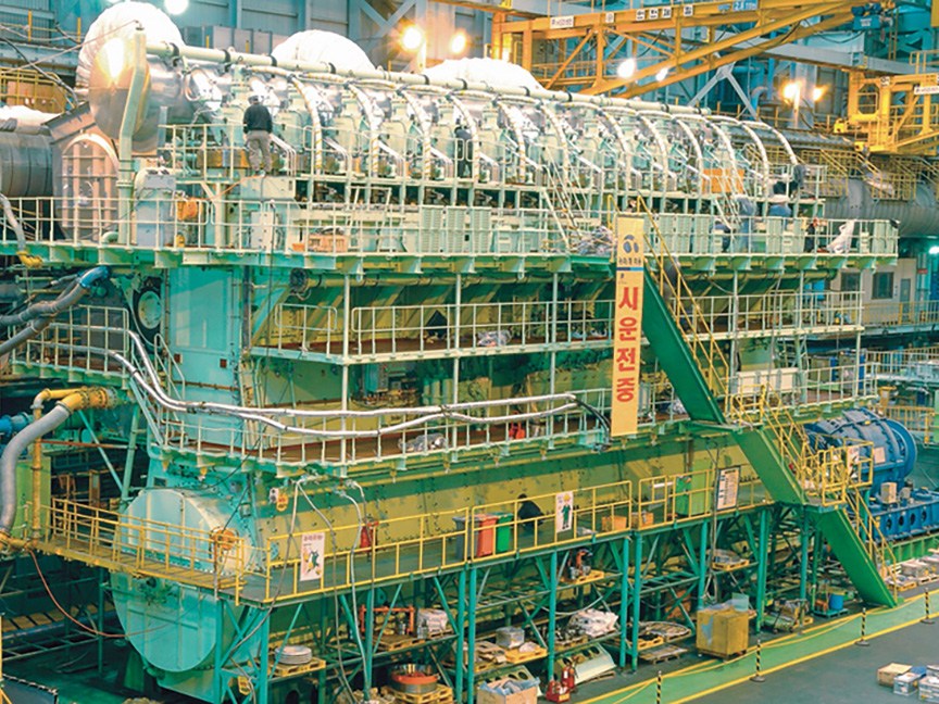

Wonder how big the drain plug is on that, and what the oil change interval is......
So an engine can still have mass without weight?

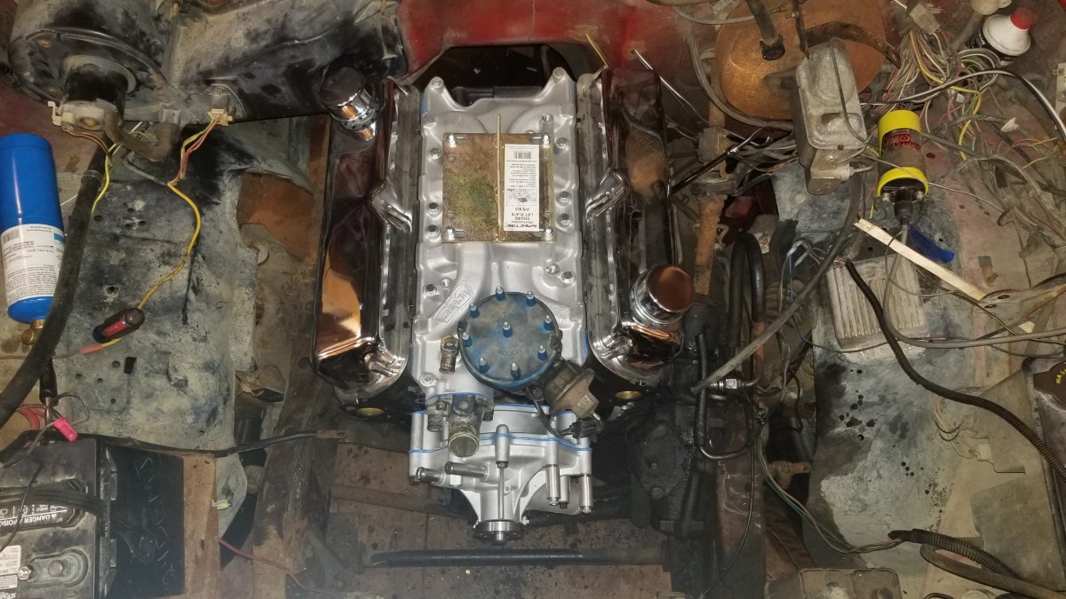

Back on subject... the 300 i6 is a great motor. I like it but the trouble with swapping one in is the length. A 302 fits much nicer. Heck if you have a body lift a 302 looks small in there.
49618

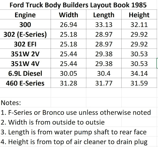

Apologies, I was comparing a naked 300 to a dressed 302.

Back on subject... the 300 i6 is a great motor. I like it but the trouble with swapping one in is the length. A 302 fits much nicer. Heck if you have a body lift a 302 looks small in there.View attachment 49618
Length is the killer, even 302 swaps can struggle with being too long.
I had the long water pump starting off, I had to pull the grille to pull the efan to pull the radiator to get the pivot bolt out to change the alternator. That was revisited and rectified ASAP.
Right now it has the Explorer belt system on it which is the shortest one Ford made... and not on the 1985 truck builder's chart.
