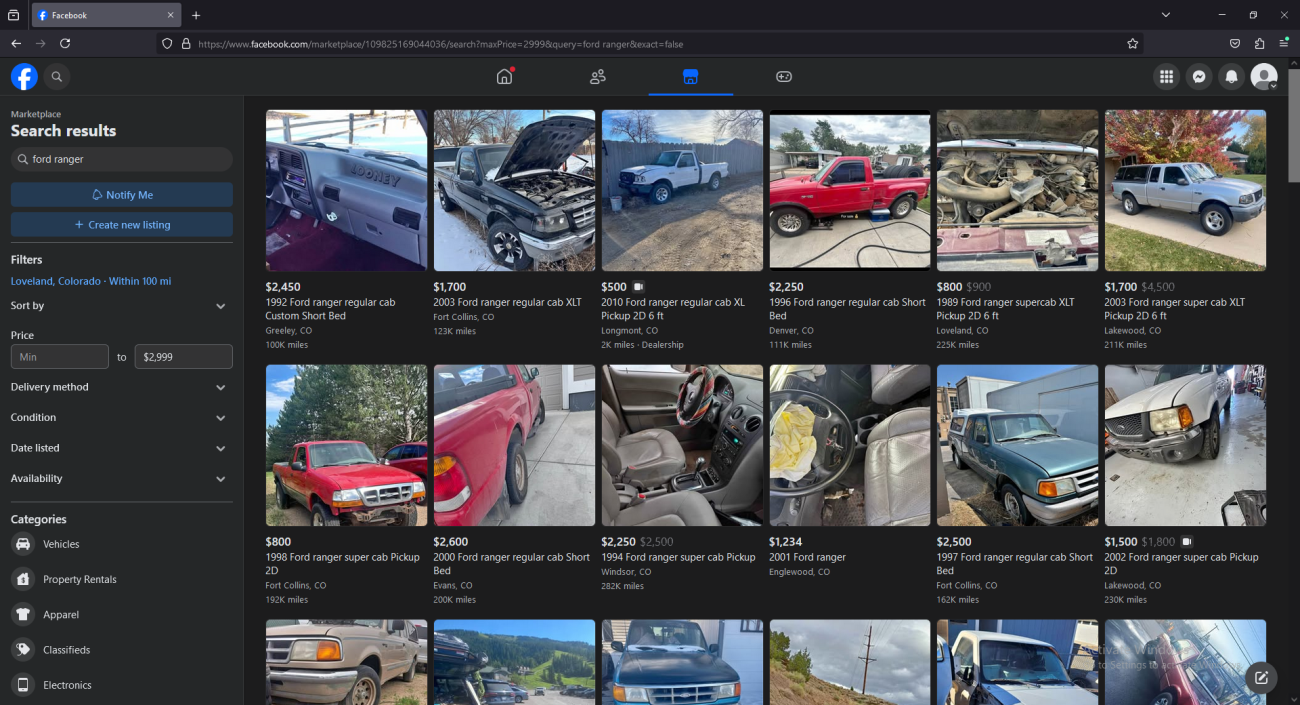

I got to thinking, and for $2,200 (just the adapter kit, no blower). I would buy a 4.0 OHV Ranger with a good title and start over, either one with a decent motor that runs or a cheap one that "cranks, but no start" off facebook. Around where I am at you can get your pick of a lot of Rangers for under $3k you just have to speak spanish or be willing to start with a "transmission blew out @ 300k" kinda gig.
