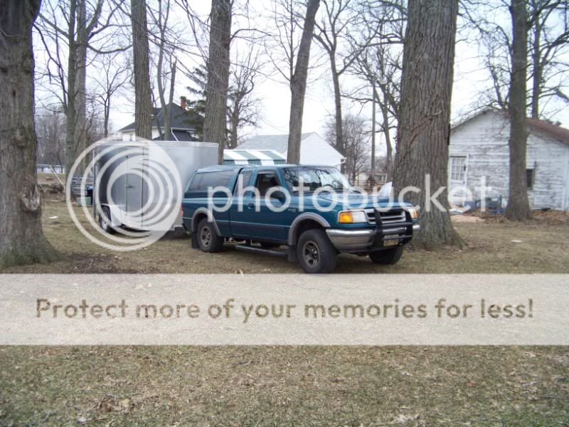

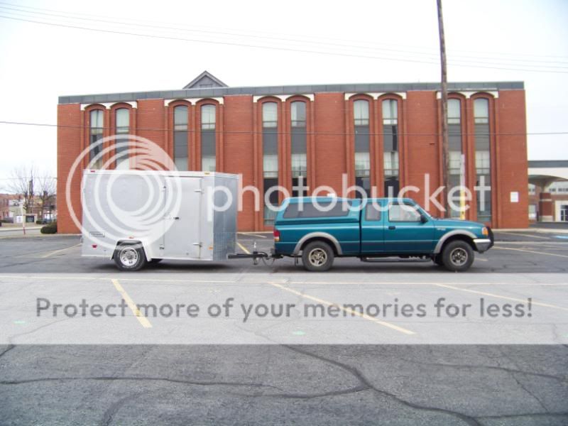

Here's a photo of my heaviest (axle) load. I've towed more weight, but never had this much on the axle. Based on the truck's performance on this particular trip though, on a hot, muggy day, I decided not to do any more towing until I get the truck set up with it's stock axle ratio, which is supposed to be a 7.5" 3.45 but I've got an 8.8 inch mystery axle with (I think) a 3.08 ratio in there. It says 55 mph when my GPS says 64 mph. (Long story behind that axle mis-match.)

3.08 are retarded gears for a truck... 3.08 were usually found as high gears in mustangs (though they also did have 2.73's
Dude you're preachin' to the choir. It totally sucks. But it'll still pull my camper.... ok. I want to put a 3.73 in it, then upgrade to 15" tires to compensate. I spent a few hrs last night calculatin' and figurin' and figured out that if I can get a set of 235/70R15 tires on it with a 3.73 axle, it would be the same overall ratio as if I had my stock setup with the 3.45 axle and 215/70R14 tires. However, when I'm towing my camper or something heavy, I can put my 14's back on and have it geared down. With my stock tires but the 3.73 rear end, my speedometer will read 70 mph when I'm only going 64.75 mph. That would be even better than stock for towing.
