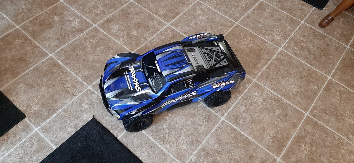

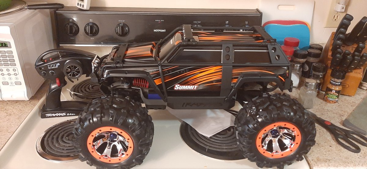

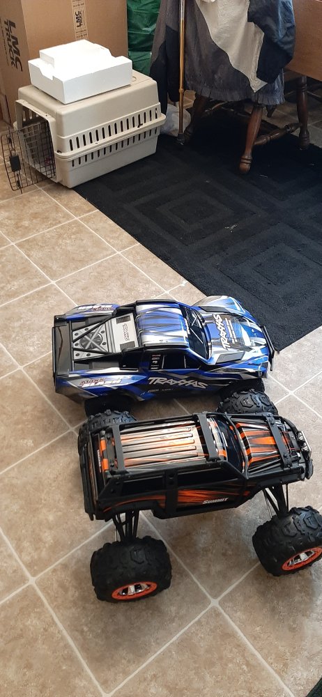

So at the beginning of the month I picked up a new Traxxas Summit for beating on in the woods and hill area's that I live in.
Then that pesky upgrade itch kicked in and I installed a few minor upgrades:

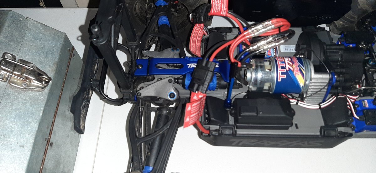

Shock socks to help keep the dust and dirt out of the shock seals:
I also put in the rear chassis brace to help stiffen it a little:

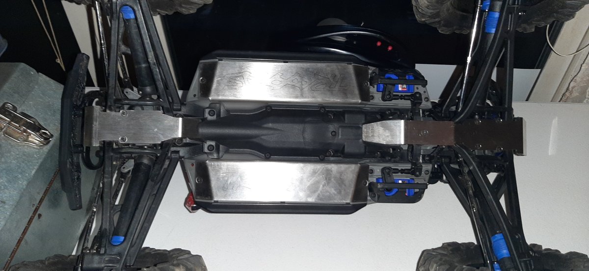

While stiffening up the chassis is all well and good but what protects it? Well... Skid plates!
I'm not willing to pay $120 for the aluminum center skid plate yet but it is on the list.
Had to do a little tweaking on the stainless steel front and rear skid plates to eliminate the gaps that became grass catchers but nothing a set of plyers couldn't handle.

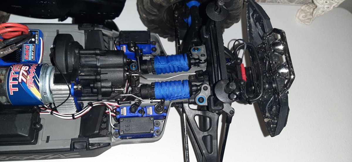

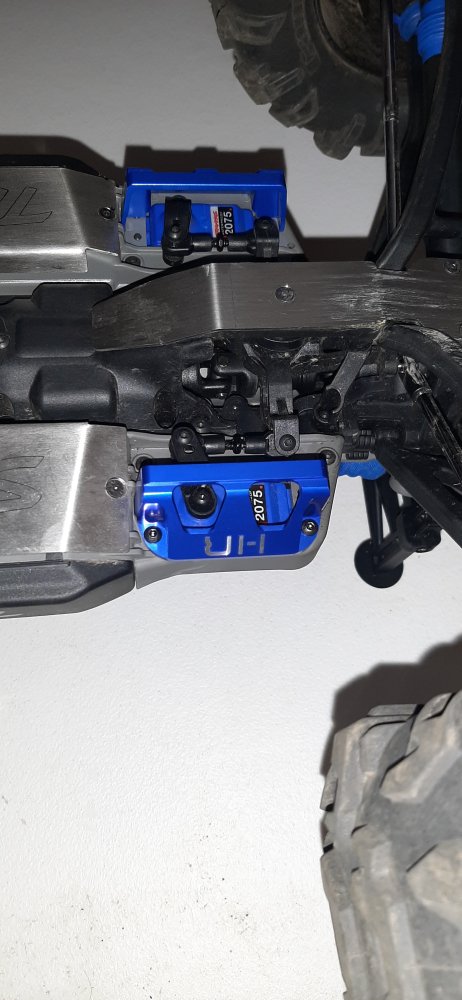

I don't like servos that stick out the bottom and the only thing protecting them was a flexible plastic guard.
So I needed to fix that concern:
Some aluminum servo guards were my go to for this one.

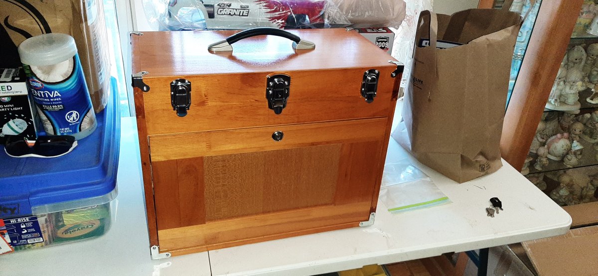

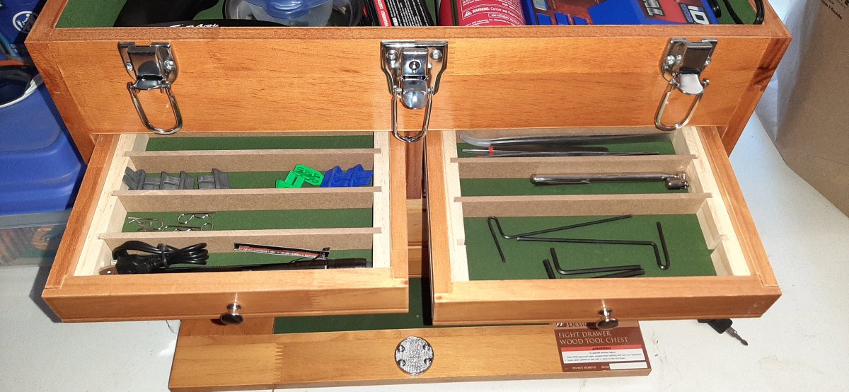

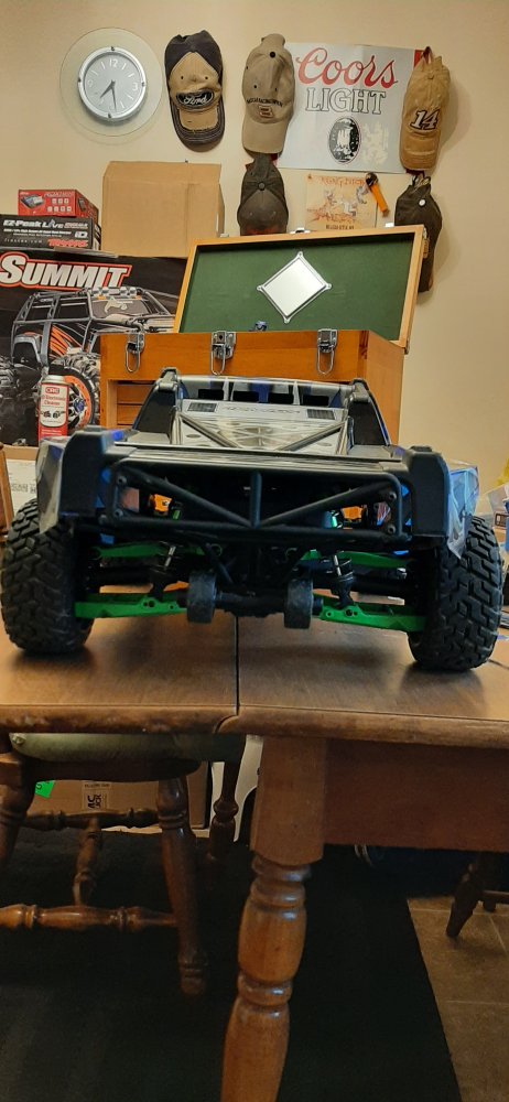

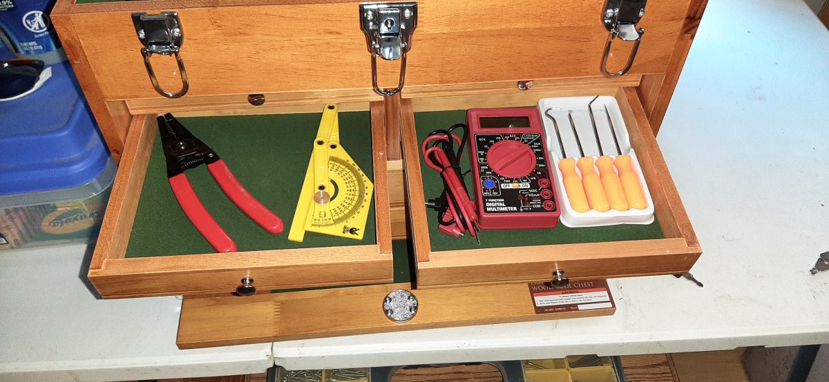

Then came the need for a GO box. In my early 20's I had a Plano tackle box that had a deep top compartment, 3 drawers and the bottom one was deep enough to allow me to keep the charger in it with battery's and soldering iron and a few other things in it and I looked high and low for another one and found one of FB market place but in New Jersey. I contacted the guy and offered to pay double asking cost and all expenses for shipping and he blew me off So I spent days running around looking at tackle boxes and tool boxes. Finally one day I said enough is enough and put the transmitter in my hoody's pouch and I set off looking for the perfect for me box. On my second trip to Harbor Freight my GF noticed this wood box with drawers and it locked. I'm still wondering why there is a mirror in the top but, Oh well. This box was 1lb. lighter than the Yukon tool box I was looking at and could fit more in it so... It came home with me. I also grabbed some tools that would fit in the box like a small multimeter, angle finder for setting camber, a rechargeable Pen flash light to stick in my mouth to see what I'm working on, a magnetic 4" tray, a small telescoping magnet to grab them small screws in tight places and a few other odds and ends. Check out this box:

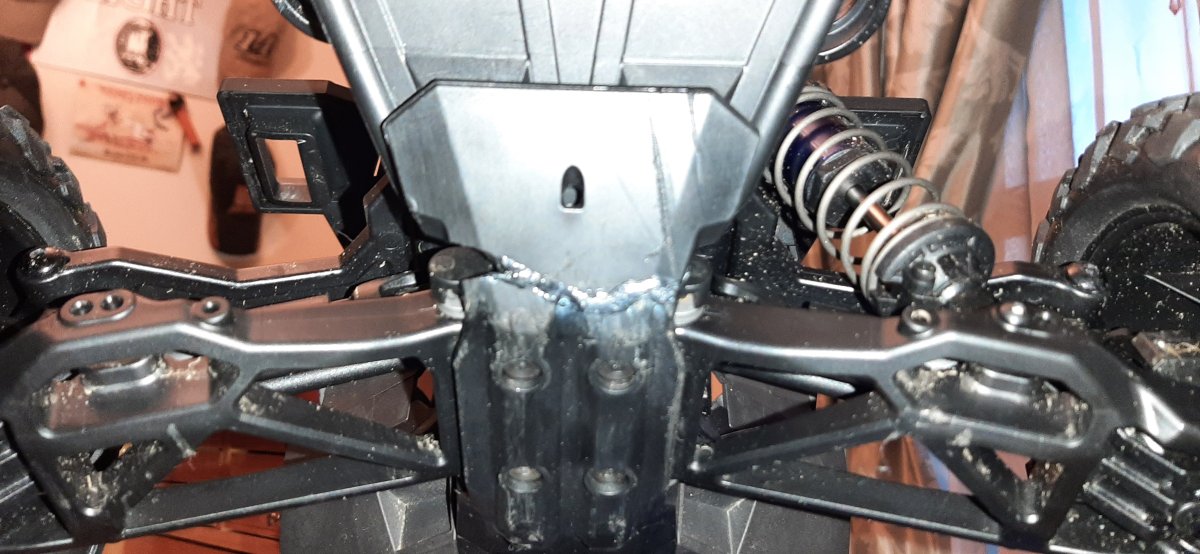

1x broken front skid plate. 2 new sets have already been shipped. Currently held together with ca+ glue.

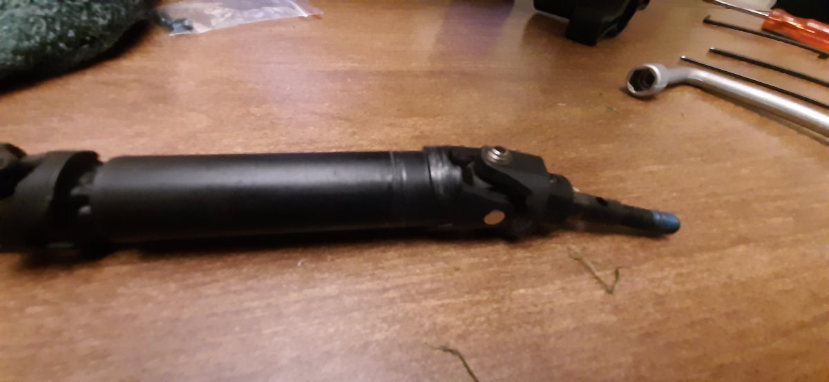

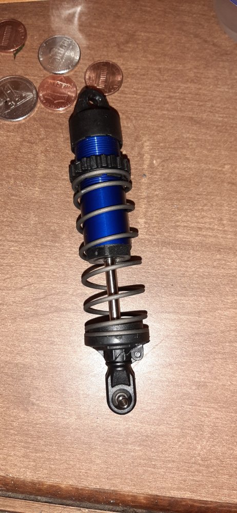

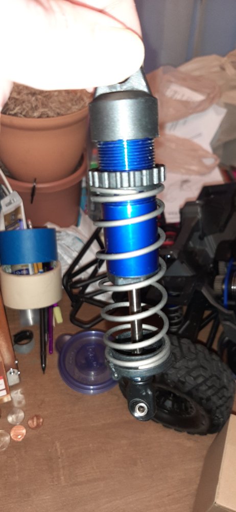

Bent shock shaft. I thought all was good after gluing the skid plate but after cycling the suspension a few times and putting the body on I noticed the right front corner was lower than the left so after inspection here is the photographic evidence of why that side was sitting low.
Now I'm positive that the spring should push that shock out with no weight on it but not so much with a bent shaft. Ordered up 4 shocks to change the color of them to green as I'll do green on the chassis and blue body, for now, but at $129 for a new unpainted body I'll hold off for a while on that one.

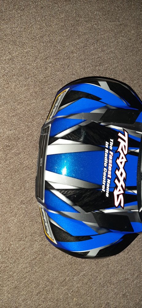

As you can see in the next set of pictures the body took a hard hit and it didn't help that I hit the dumpster right on the corner of it. There is a raised eye brow on the right side of the hood where the body got dented in. There is spot on the front where a crack is going to start because the body is gouged both on the inside and outside.

The go box and trucks are going with me so I can play while waiting on my new shocks so I can play with the new beast. The Maxx is down for now but I still have the Summit to beat on for a while. I was able to bind the 2 trucks to the same radio transmitter so that is one less thing to haul around.

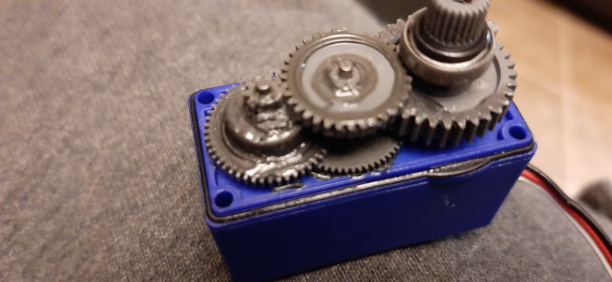

Saturday I went to a friends house to run the RC's a bit and only having the Summit up and running I brought that. As I was trying to crawl up his ash pile from his wood and coal stoves I some how caught a stick and the truck jumped to the side and I heard a snap sound. I immediately said that didn't sound good but I still had steering and the throttle sounded good so I kept going for a while. once I got up to the front of the house I could hear a servo going wild constantly spinning.
Here is the carnage from that one:
The left gear is missing 2 or 3 teeth. Sorry for the fuzzy pic of that gear but it was all I could do to get the phone to focus on the servo and not my pants. Tried on the table first but it focused on the table also. :dntknw: I do plan on getting the metal gears for the 2075 servos so I have spares on hand.

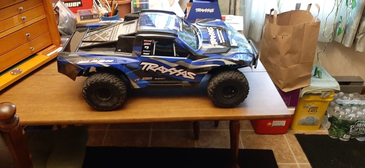

News on the Maxx Slash I picked up. It was fixed, except the front skid plate, for about 3/4 of a battery pack till I hit my foot and turned it into a car tire. Man was I annoyed with myself on that one. Here's the carnage up date:
1 still broken skid plate that the glue could not hold up.

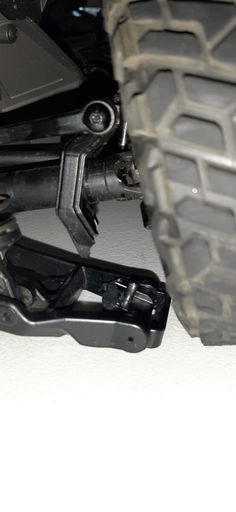

1 Broken Caster block. I'm not the only one that has broke this sides caster block so I don't feel so bad about that. The Cure? Aluminum...

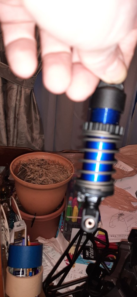

While I was at it I changed out the 4 shocks for all green ones.

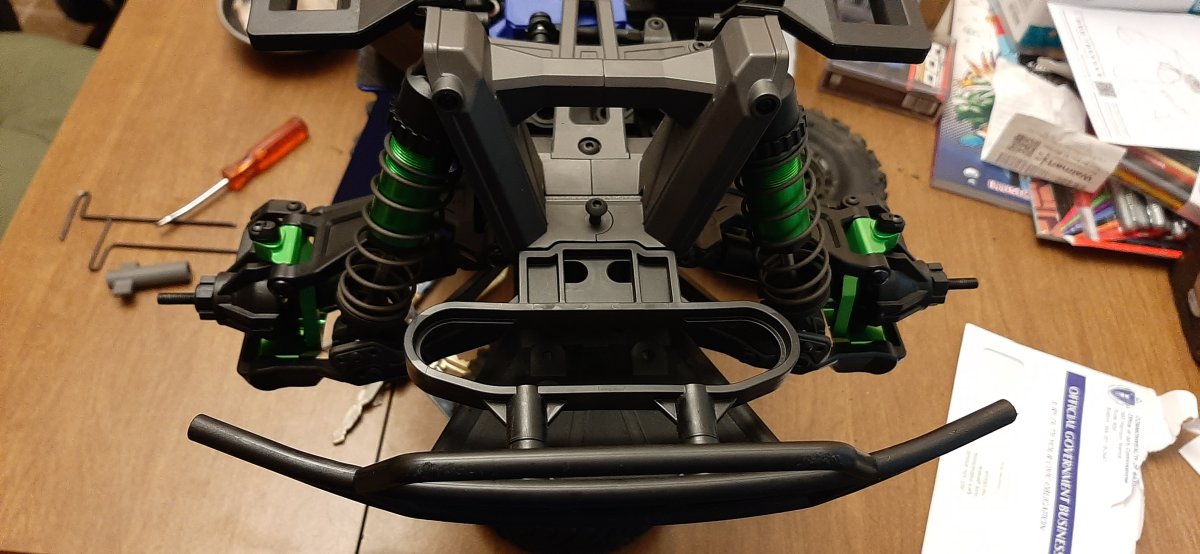

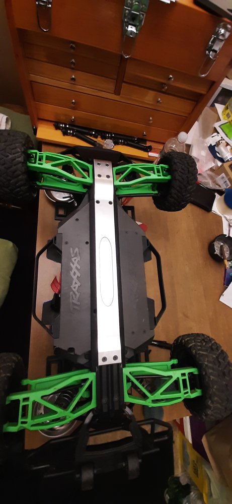

Once I was done with that I got the itch to install the Wide kit. Everything went smooth except the extended axles that come in the kit are actually smaller inner diameter than the factory ones that come with the Max Slash so I reused the original axles, for now, just to get an idea of the handling difference it made. The new CVD's should be here tomorrow which should take care of the axles being extended so far out.

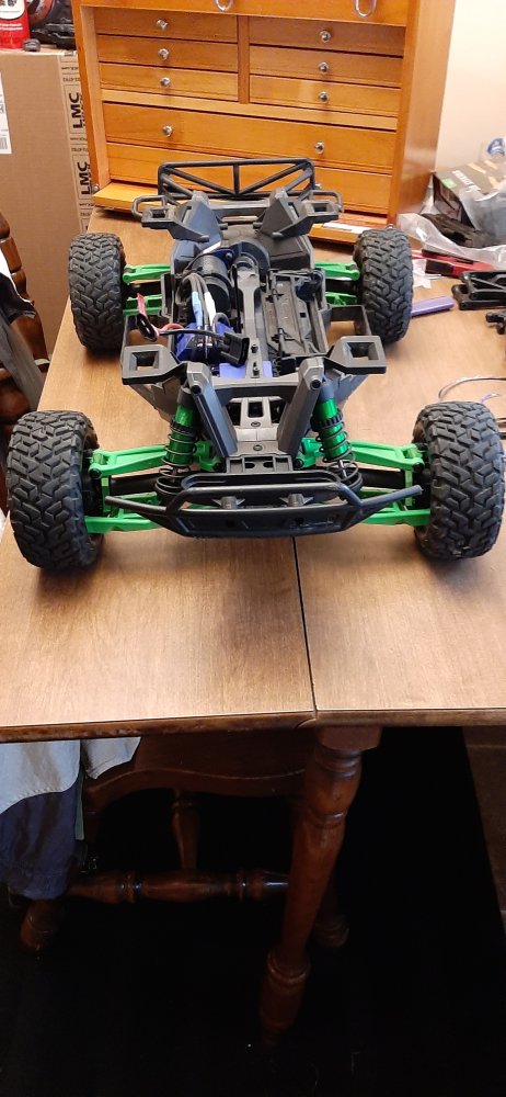

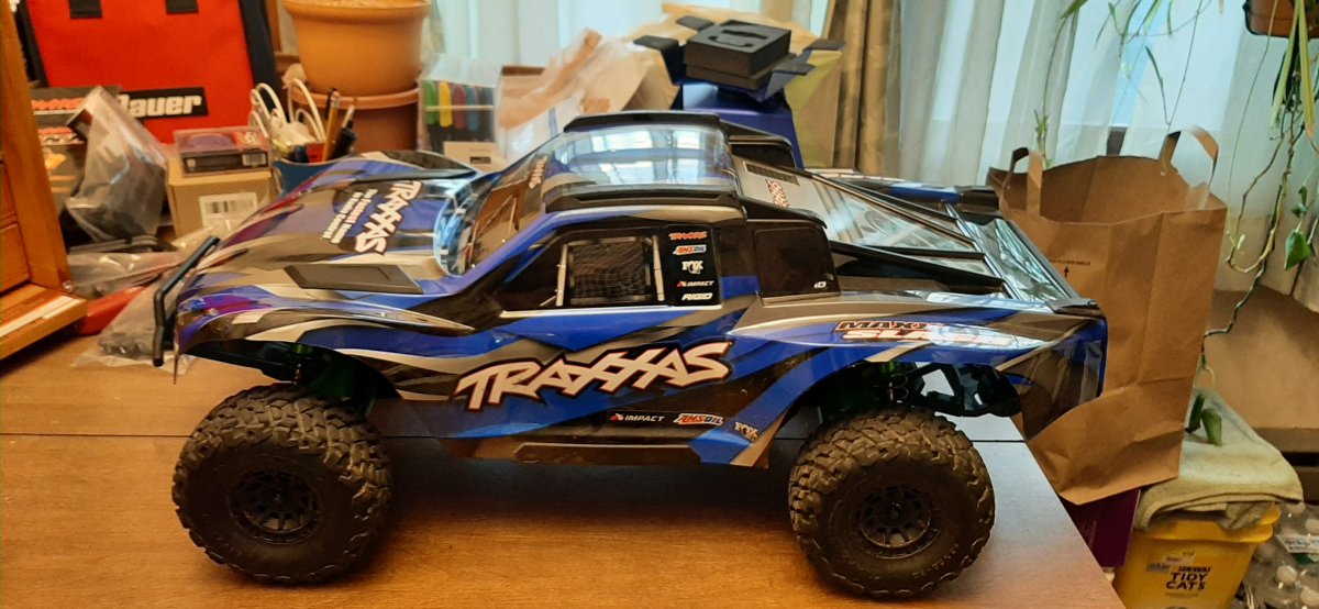

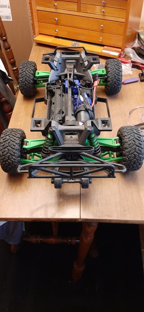

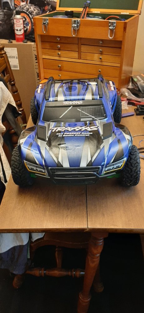

Here's what she is looking like now with the 40mm wider stance:

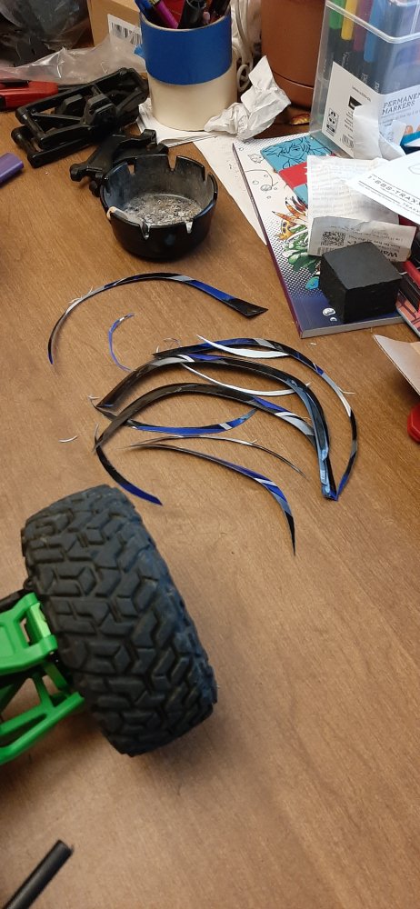

Being it pushes the wheels out 20mm per side the body hits the tires and some fender trimming is necessary to keep the paint in good shape. I started with the fronts, on the body line where it went strait down but found that was not enough so a little more and I eventually got it so I could turn the tires and hold the suspension fully compressed and it wouldn't touch. In the rear though I needed to go a bit further up the body but was easier than the front since they don't turn side to side.
Once the body was trimmed it was time to see what it actually looked like on the chassis:
I'm liking the green against the blue on this one.

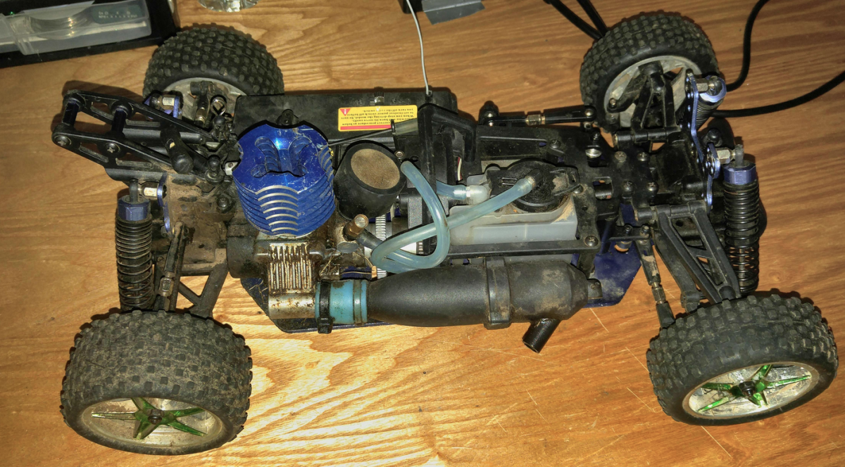

Hard to beat the sound and smell of a tiny little nitro methane RC! This has the optional 0.18cu big block haha

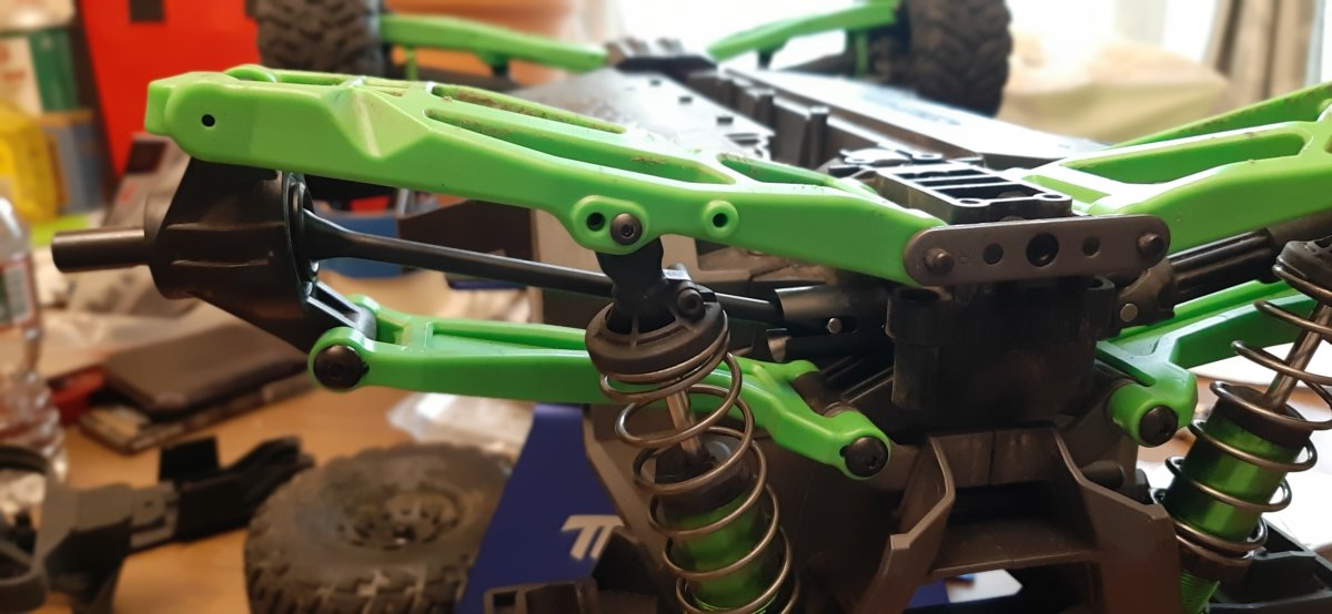

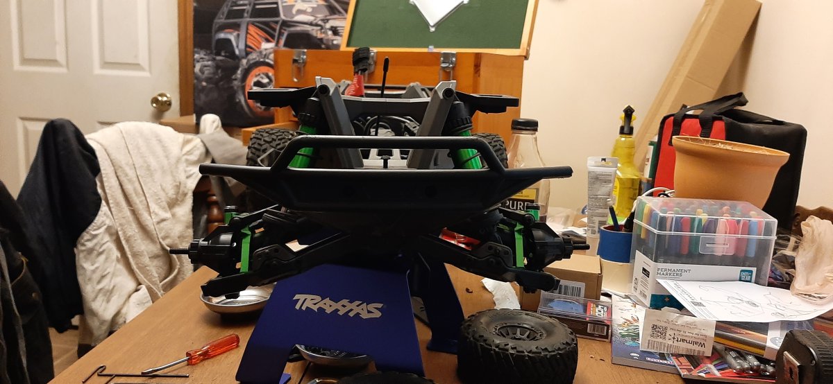

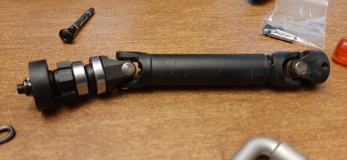

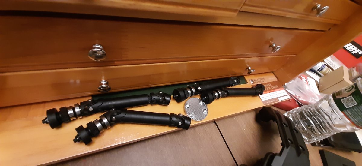

My Constant Velocity Driveshafts (CVD's) came in yesterday and I got them installed tonight.
I think I have an R/C addiction...

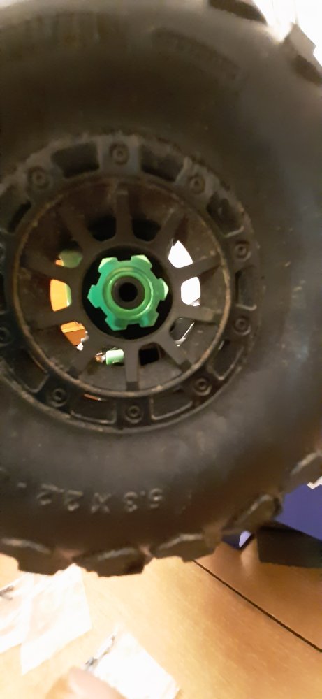

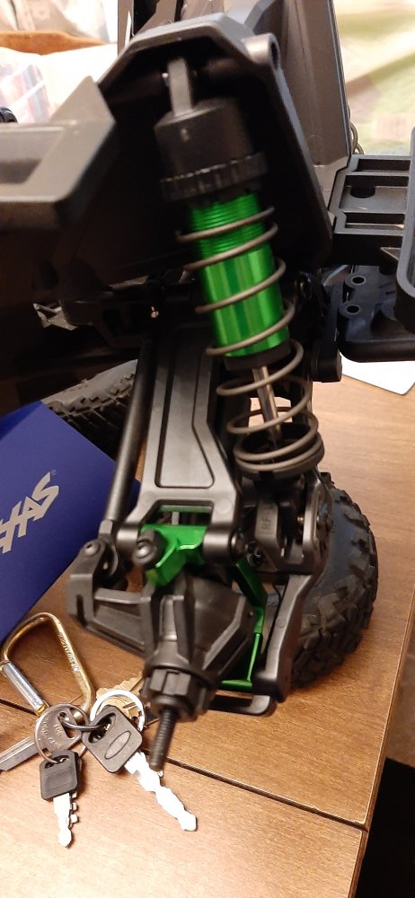

I went with the green aluminum hubs and hub nuts. While looking it over I found 3 of the tires starting to separate from the rims so I put some glue on them but this truck has so much torque and speed that it is inevitable I will be buying new tires. This is a common issue with this model.
It's a good thing I ordered the CVD's because the front axles were rubbing on the new aluminum caster blocks on both sides. One side had worn through the green anodized coloring on the inner part of the caster block.
My M2C brace came yesterday also so I installed the new skid plates and the brace. This picture does not do it justice as the lighting keeps you from seeing the engraving in the oval.

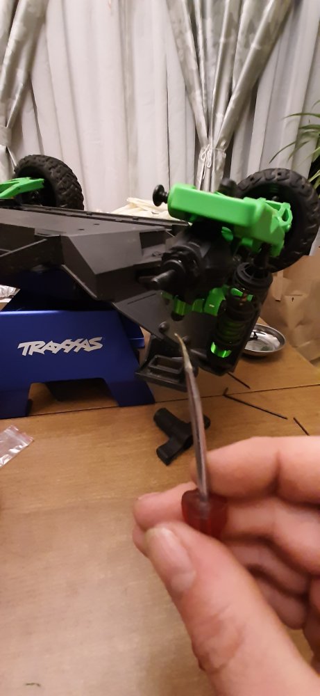

Because the stock axles are still good I assembled them to keep as spares just incase. I put all 4 in a ziplock baggy to keep them together and clean.

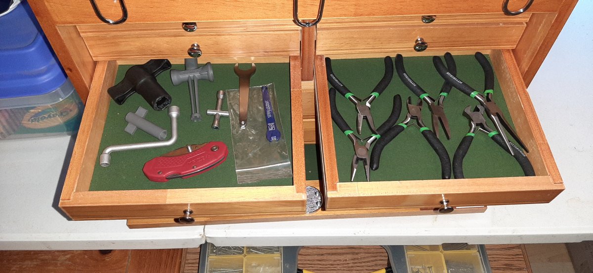

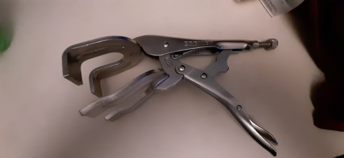

My custom made mini prying device. This makes popping off the stock hubs so much easier. I've had this little one for years and it only gets used for small prying needs.

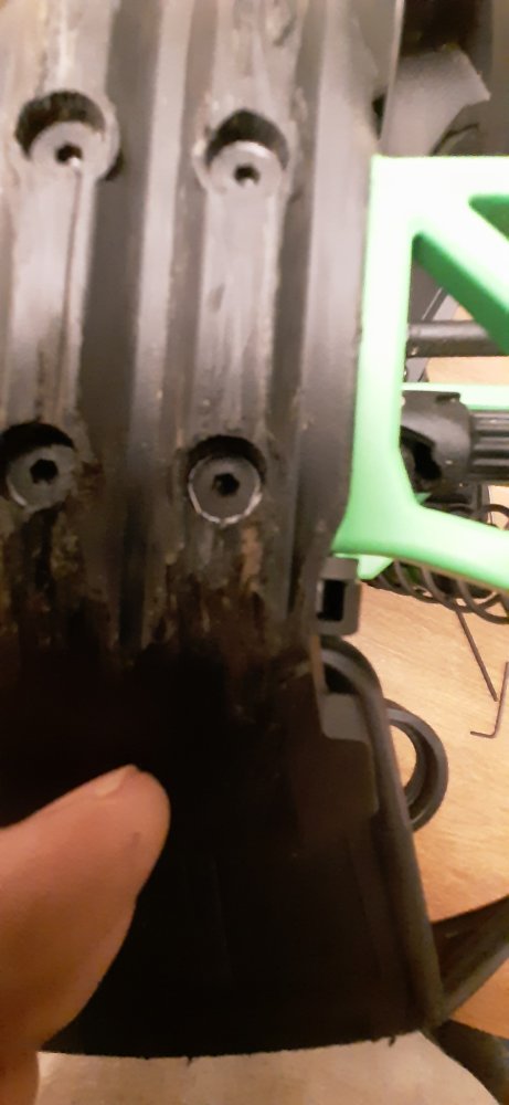

Because this thing is so low to the ground the skid plates take one hell of a beating. To get the screws out I hade to use a razor knife and cut the folded plastic away from the holes to be able to remove the screws to install new skid plates.

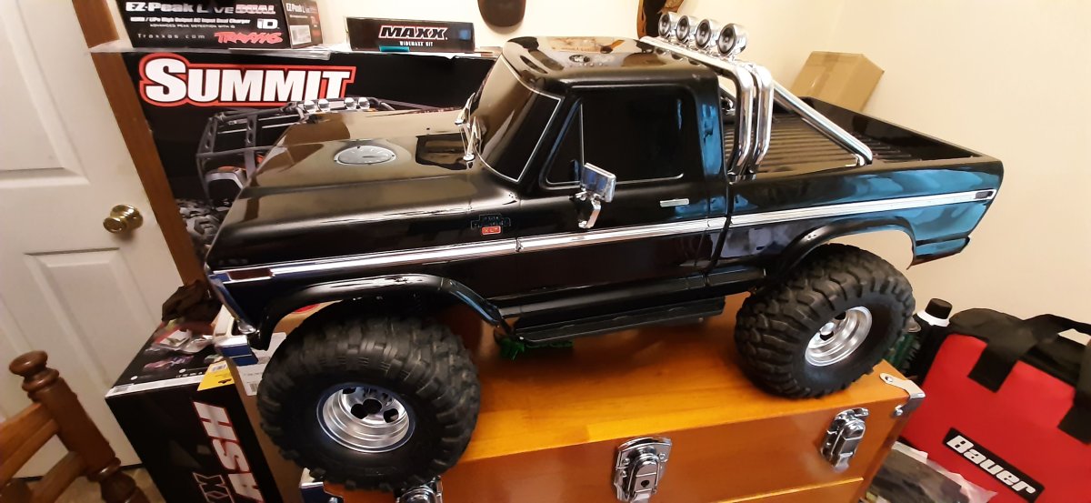

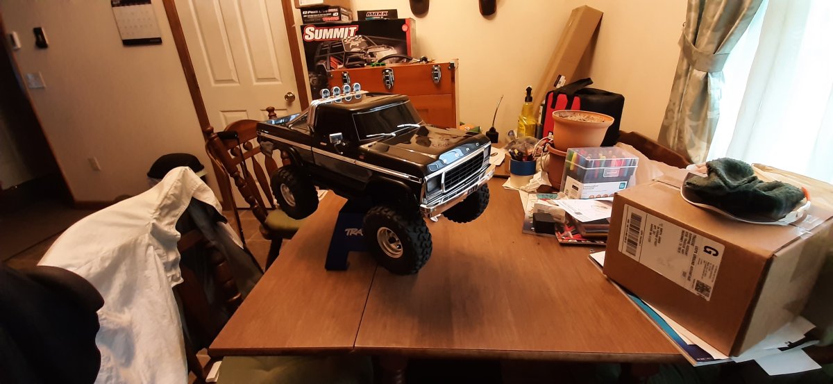

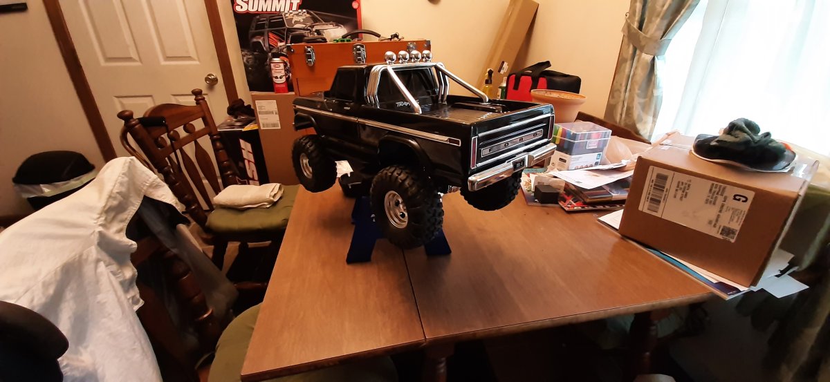

Before heading up to play around I picked up a passenger called "Black Sun Shine". TRX-4 1979 Ford F150 Ranger XLT High Trail Edition 1/10 Scale and Trail

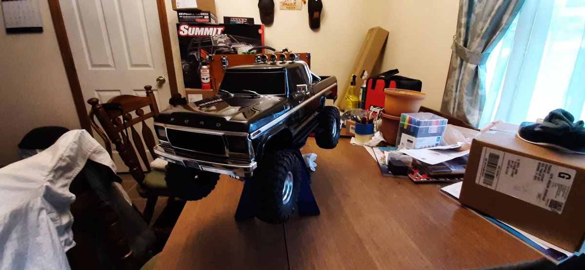

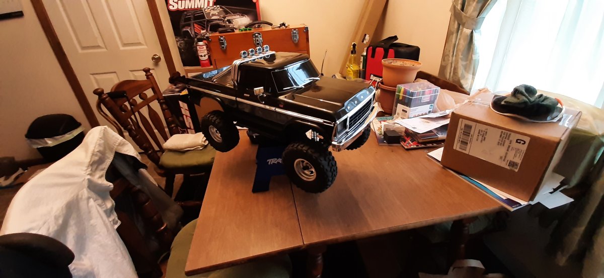

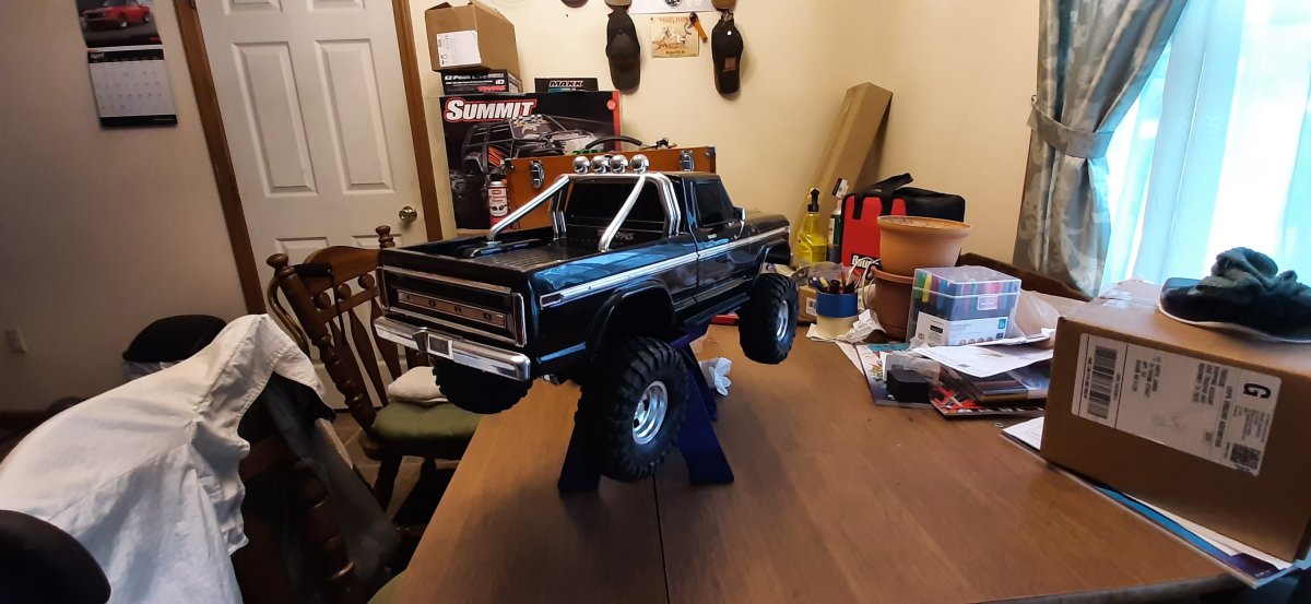

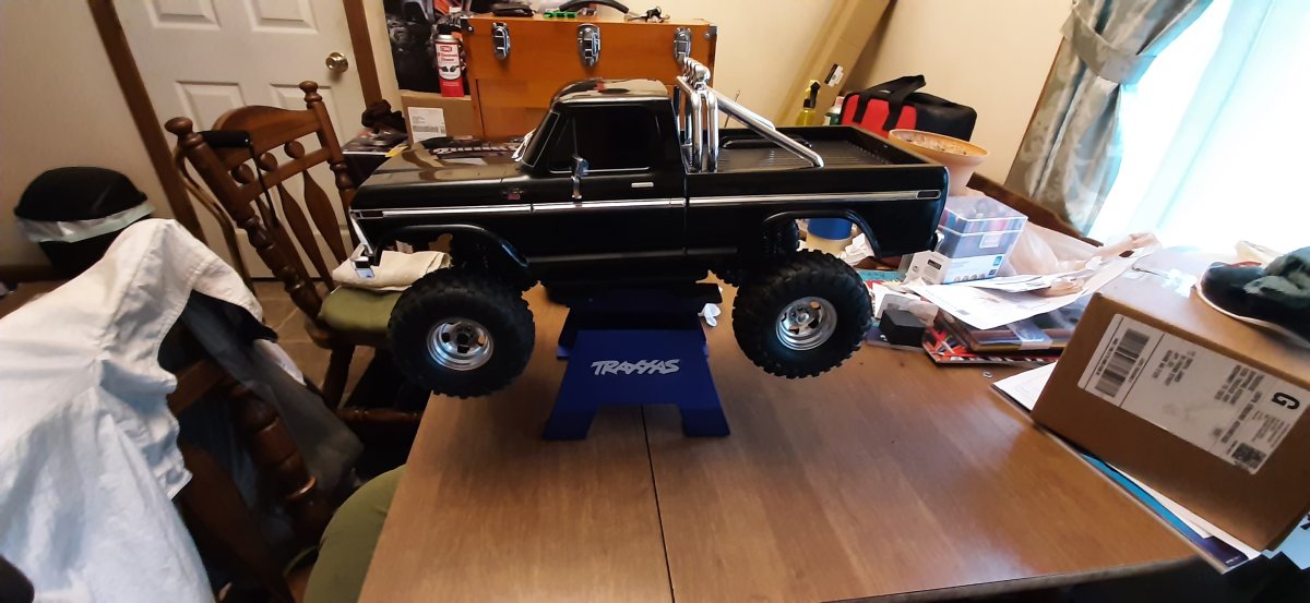

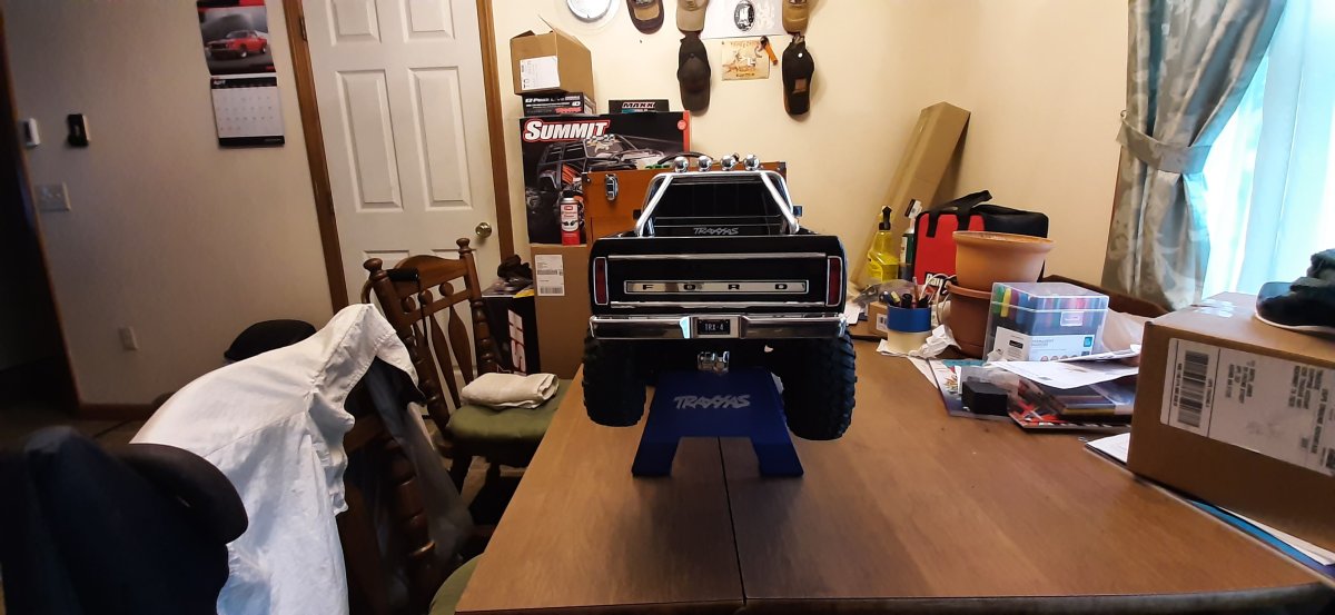

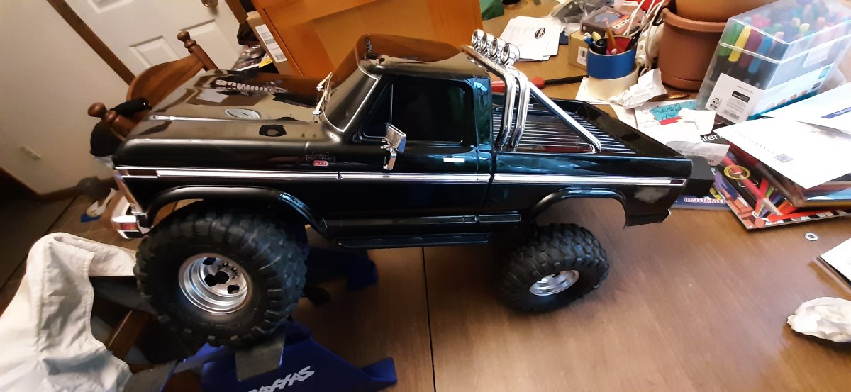

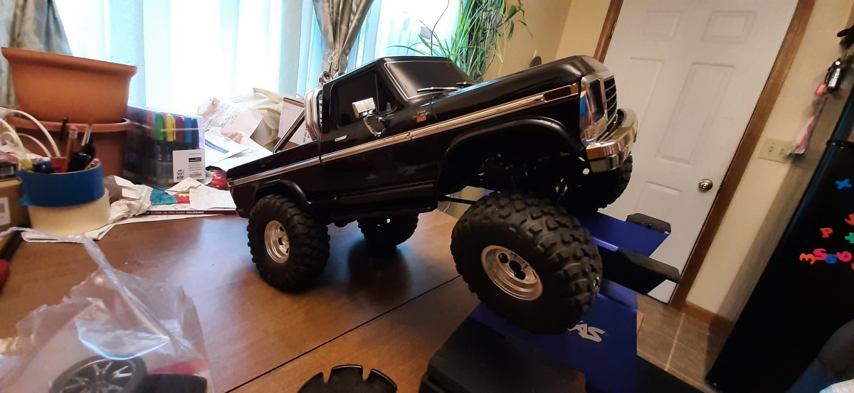

She is a little top heavy at the moment but am looking into weights for the axles and portals to lower the center of gravity. I have always wanted a dent side but this will have to do for now.
Been a busy 2 days dealing with Black Sun Shine and it's factory issues. Why would the factory put such a large tire on it that it rubs the bumper and body in the front when the suspension is compressed? Stock tires for the High Trail are 5.3" tall on a 2.2" rim and 2 1/16" wide. So I hit up the hobby shop to see what he had in stock for tires and rims. I picked up a set of both but didn't realize till I mounted the tire how much smaller they were. They measure 4.161" tall. Over an inch smaller and now they look funny on the High Trail because of the lift it has.
I had one heck of a time trying to squeeze the rims together and line up the 4 different pieces with holes in them to get the screws in. I did manage to get one built by hand but went looking for a better way shortly after. I have some welding I need to do on the Ranger this year and bought a vice-grip clamp from Harbor Freight when I purchased my R/C box and low and behold it does the job nicely for holding those small rims together. This thing is going to be useful:
I originally bought them because I need to do wheel arches this summer but using things in an improper manner is my specialty.
Also while I was at the hobby shop I grabbed some hex head drivers. 1.5, 2.0, 2.5, 3.0, 4.0 mm drivers which sets me nicely for now but I still am researching cordless screwdrivers to help speed the repairs and addition of new upgrades.
I also found a set of brass weights that bolt to the rims while I was there and Black Sun Shine now has 70g on each wheel to help stabilize it. Today was a big shopping day for weight for it. I found a total 1.3lbs of brass pieces that bolt to the axles so that should plant the tires nicely and really lower the center of gravity.
2x C hubs @ 92g
2x steering knuckles @ 108g
2x Outer Portal Housings @ 62g
1x Diff Cover @ 64g
2x Fake brake rotors and calipers @6g
Adding in the 140g for the wheel weights it equals 472g/16.6493oz. just on the front axle.
2x Axle Mounts @ 52g
2x Inner Portal Housings @ 68g
1x Diff Cover @ 64g
2x Fake rotors and calipers @ 6g
Adding in the 140g for brass on the wheels comes to 392g/13.8274 of weight on the rear axle

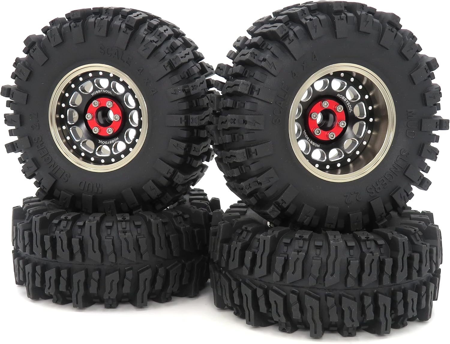

I also found tires that are larger that shouldn't rub the body being 4.88" tall. The rims I ordered the boggers with can push the off set out to -18mm per tire to 36mm wider base should help stabilize it even more and keep its tipsy's under control. Although I may stick with the 15mm each tire to keep the red center ring visible. I can still use my wheel weights on the new rims so the weight will only go up with the bigger tires. These are on the 2.2 rims so a little less sidewall deflection.

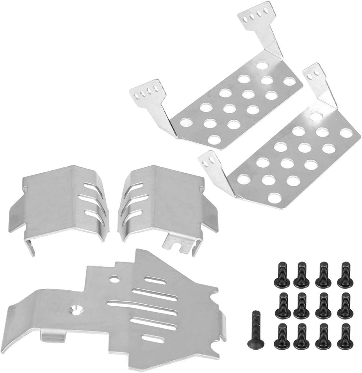

Skid plates that cover both differentials, transmission and bumper guards to help prevent scratches in the plastic.
