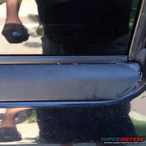

An FYI to DYI restore for that trim with a proper coating. I used black Plasti Dip in a spray can. It covered the old, faded, rubber trim below the door windows well. It is flexible like the rubber, should hold, and looks better now. I can't say they look new because there were scratches in the rubber.

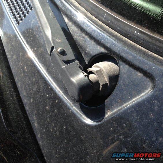

Now I am going to hit the faded door handles and tail gate handle. Maybe hit a few other faded items like the down around the wiper mounts.

I sure need to do my door window trim also, it's pealing off.

Great idea, Blown!!! I was planning on doing my wife's Corolla's windshield wiper area with the spray on. That area on her Corolla is starting to fade a bit. Not bad for an '03!! I just found some last week and never knew it was in a can before. I know there are a few places by us that do wheels and blackout body kits with the Plasti Dip. I think yours came out great.

They suggest 4-5 coats to be able to peel it later. That's a bunch of material, a thick coating, so you can peel it if you want. A friend redid a wheel, don' tknow why, but he used a power washer to strip the paint.

Will get the wiper mounts later, they are the only faded pieces left to do.
