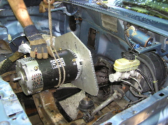

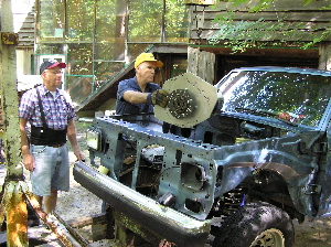

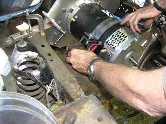

The part of the clutch that accepts the spline from the transmission is attached to an adapter that is the same diameter as that part of the clutch and the adapter slides onto the keyed moter shaft and is stablized with a set screw through the adapter to the motor shaft. A slight indentation is bored in the motor shaft where the set screw meets the shaft for additional security. I'll attach a picture showing the clutch part as attached to the adapter.
I'm not too sure yet how all the motor parameters fit together but according to the documentation the FB1_4001A motor is rated at 30 hp continuous at 144 volts an 100 hp peak. That would use 24 6 volt batteries, this design uses only 20 for 120 volts and more like 25 hp continuous. I think the continuous amp rating is more like 200 amps but I'm not sure. I'm just getting into that aspect of the design.
I'll attach some pictures from this past weekend. The pictures are not all that great because of the size restriction the website puts on them. It is a very interesting project.

As far as shifting is concerned I'll know better when we get it running and try it but supposedly you run in 2nd gear around town and in 3rd on the highway. Reverse is used to back up. I believe the rpm's are around 5000.
i see, so even thought the clutch disk is there, there is no functional clutch. shifting from 2nd to 3rd while moving could be tricky, but probably possible since your using a synchronized transmission.
the project looks good so far. the pics help show how the motor is adapted to the transmission and stock motor mounts.
if the motor is supposed to produce 25 HP with your 120V setup, then you'll be drawing about 155amps. that makes sense since electric motors are usually rated at their continuous HP, not their peak power (like gas engines), which can be several times higher then their continuous rating (100HP at 144V is 518A). we also have to try and remember the fact that electric motors usually produce MANY times the torque rating of their gasoline equivalent. 25HP may not sound like much, but its probably making more then 100ft-lbs of torque and at a much lower RPM then the gas engine.

As far as driving without a clutch... you drive it like a farm tractor, you choose a gear appropriate for the work to be performed, 2nd or 3rd (of 5) for around town, place the shift lever in position while stopped (No engine rpm (no idle)), make sure it "clicked" in, then depress the "electron pedal", gently of course... To get on the highway, you stop at the traffic light or gas station (hah) or wherever, at the top of the ramp and, while stopped, select 4th or 5th, make sure it clicked in, then go to the highway. There are several places in all the literature that I've been reading that warn against free revving, that is rpm with no load. But I think that all these warnings are in regard to over revving the motor where the centrifugal (centripetal for you young pups) will blow out the armature.
I spent 10 years as an over the road truck driver, and I learned early how to float the gears. That is, to shift the gears without using the clutch. It actually saves on clutch wear but takes its toll on the U joints, especially the first one at the back of the trans. So no matter how good a shifter you are, the wear takes place somewhere. But U joints are easier to replace than a clutch (never mind that a clutch can last 500,00 miles on a semi with a good driver). Here, in an electric vehicle, you either shift while stopped or learn to float the gears gently.
