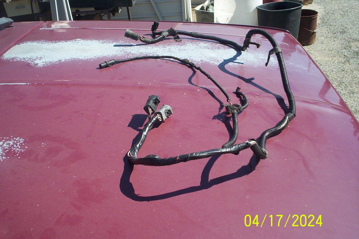

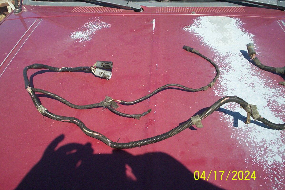

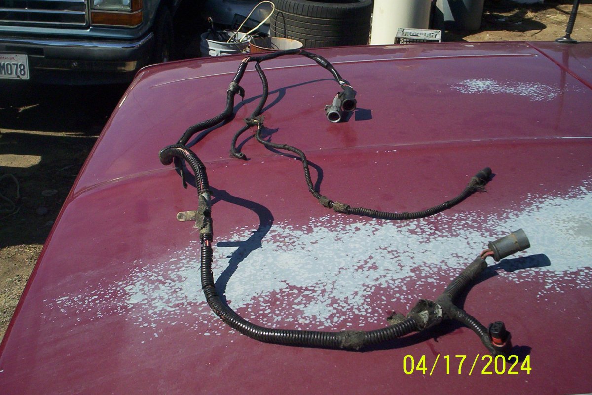

The harness you looking for is for the transmission right Not the engine harness. The 5-speed harness for 1990--92 rangers are sought after by so many people in the Bronco 2. I saw them go as much as 1000.00. Because all the guys are converting over to 4.0 from 2.9. this is from an automatic 1992 4.0

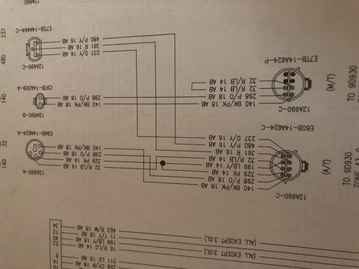

You don’t need a harness . Get a pigtail for the backup lights and make your plug look like the manual plug from this Ford wiring diagram . I’m on my 3rd conversion. If you remove the 4 wires put silicone in the holes. Hope this helps.
