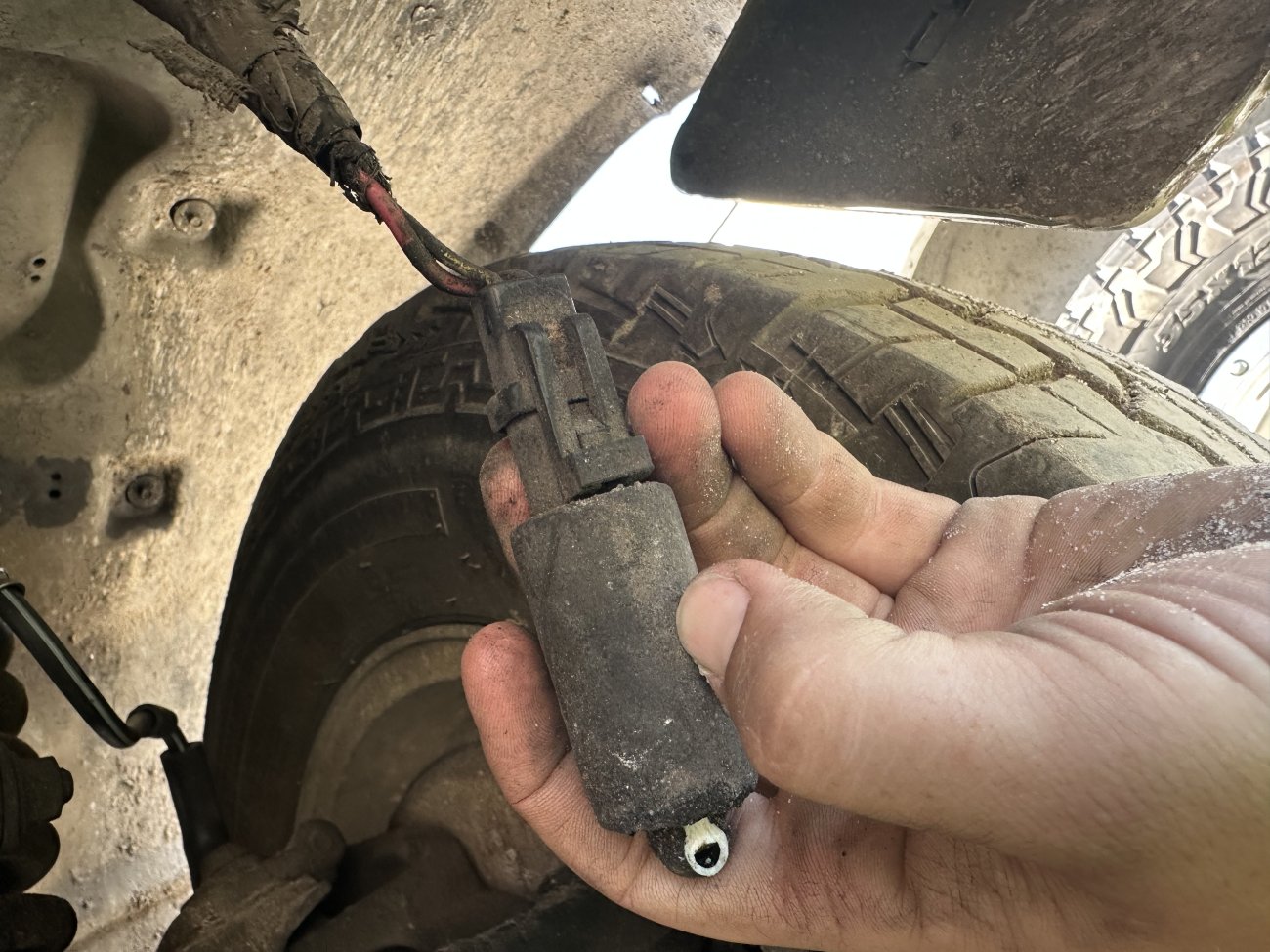

I believe I may have found the problem. Was listening to the truck and heard a hissing noise say this.
I have a friend with a problem...
After looking is up I believe it’s the vapor canister purge valve. I can see the one line is sucking making me think it’s some kind of vacuum line? And does the other end go into the transfer case??
I believe I may have found the problem. Was listening to the truck and heard a hissing noise say this. View attachment 137340
It would entertain the fuel tank/charcoal canister. Nothing with the tcase
Hey Sean, you are correct. It's part of the emissions system. It does not go to the transfer case. One end goes into the charcoal canister and the other to the manifold I think to burn off stuff. I do not believe it would affect the brakes, but it could cause minor running issues.

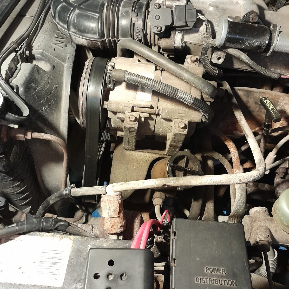

It appears you have a hole in your line...
I replaced mine a couple months back with a Dorman from RA. I'm all good now.
