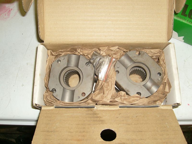

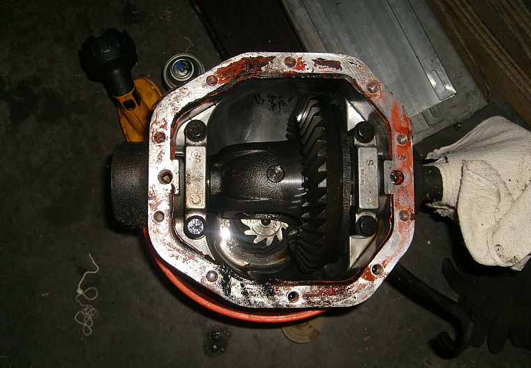

Woohoo I finally got a locker:icon_bounceblue:
Thanks to Captain Ledd I will soon be locked front/rear! Here she is, and her new home to be:yahoo:

Too true, LOL. Yeah I'll have to really reign in my enthusiasm. I just wanted to play in the mud holes around here but with stock open axles it wasn't happening......
It won't gop into the carrier....
Anyone else had this problem? I cannot get both sides of the locker in. I plan to grind a bit on the carrier opening and se if that lets them both go in.
It won't go into the carrier....
Anyone else had this problem? I cannot get both sides of the locker in. I plan to grind a bit on the carrier opening and see if that lets them both go in.
Yup, it's common to have to clearance the window in the carrier for drop in lockers. Just take out as little material as necessary and your golden.
