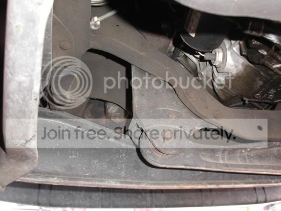

FWIW, this is the bracket you'll need:
I believe that beam is also shorter than the one on a Ranger.
Yeah that's a difference.
