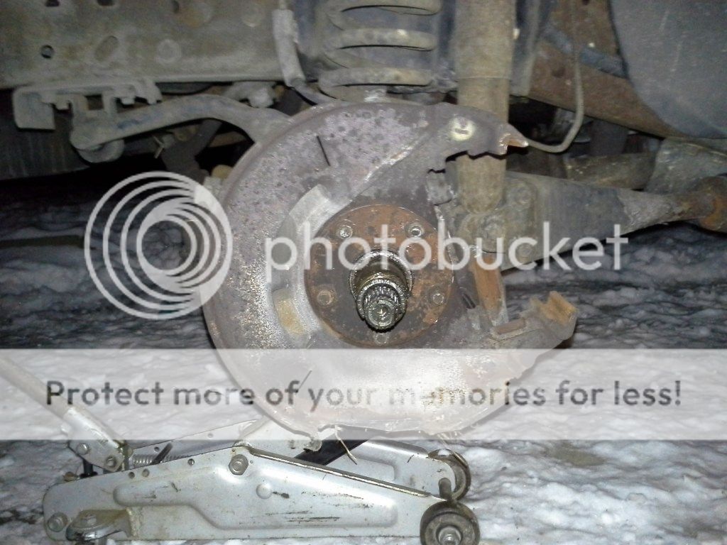

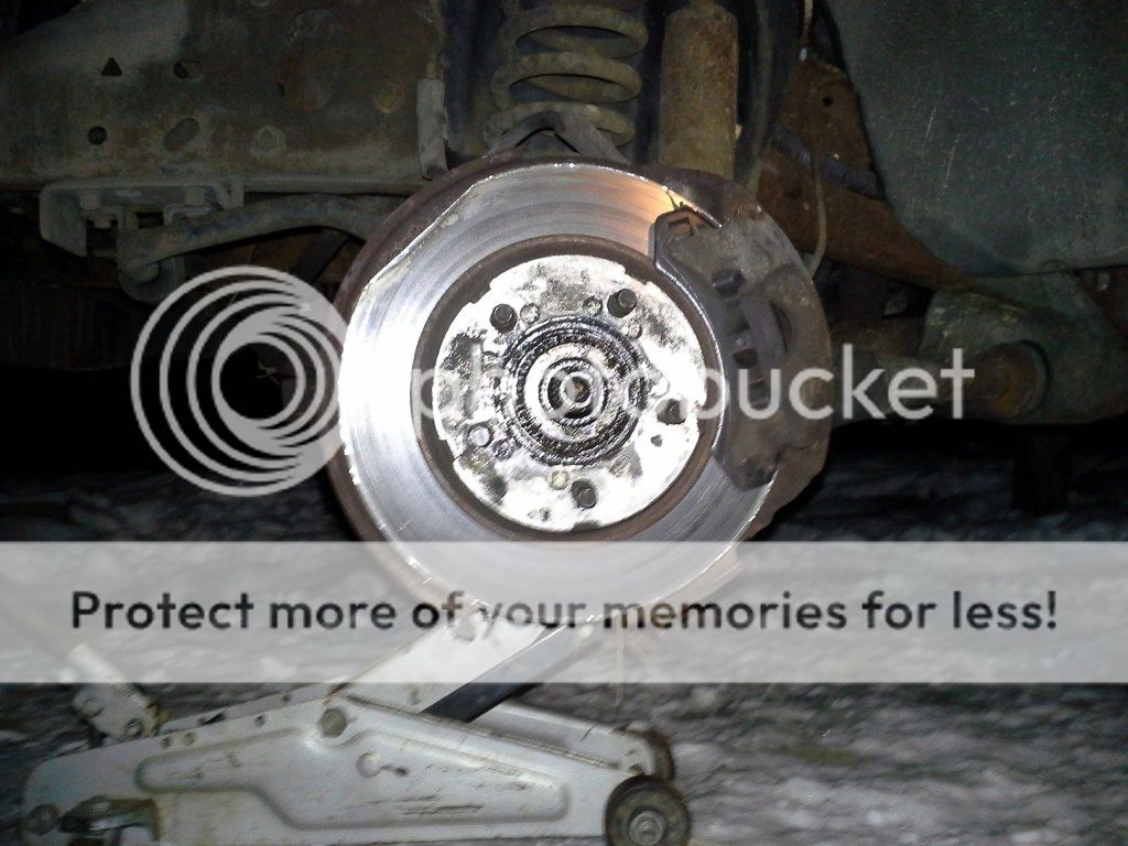

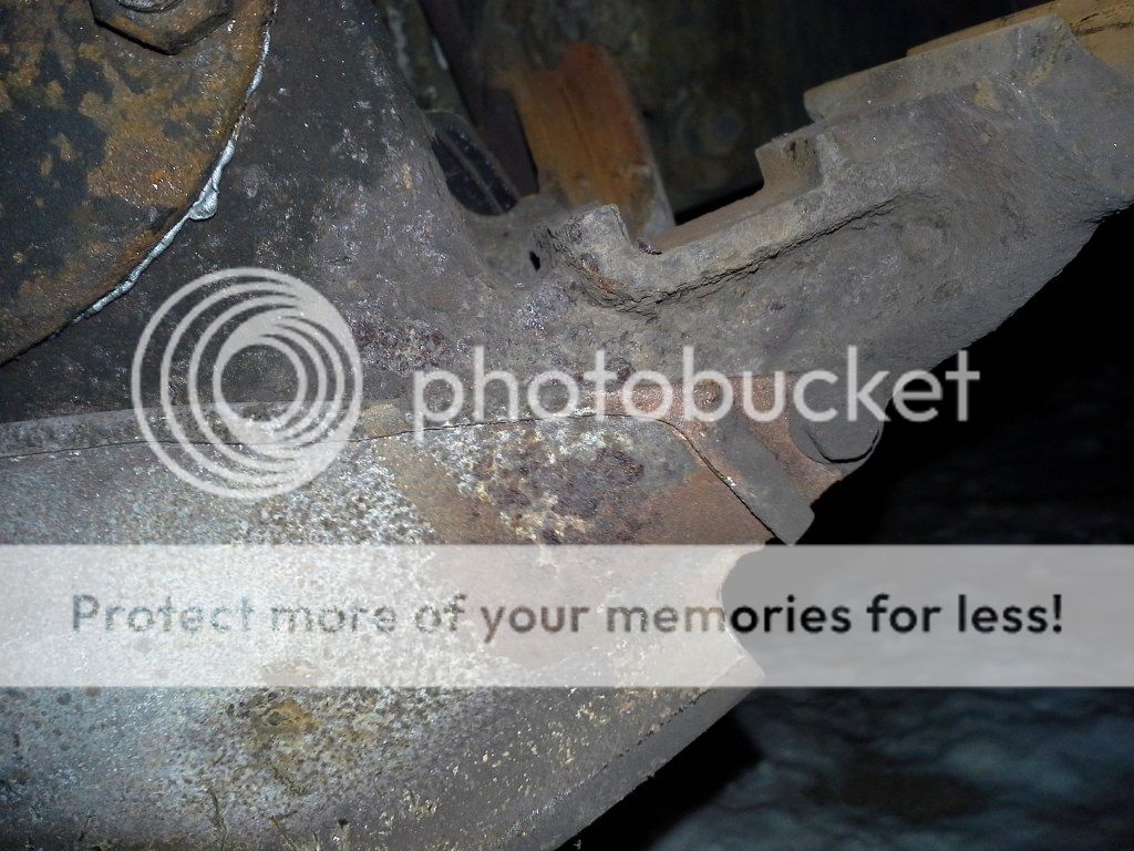

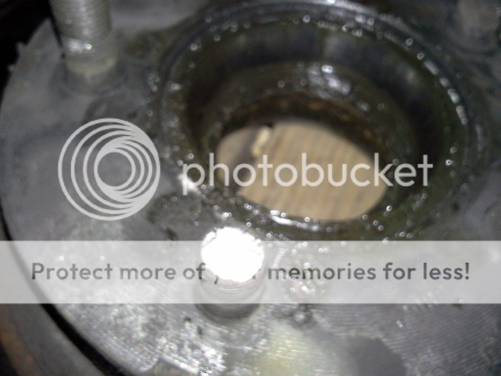

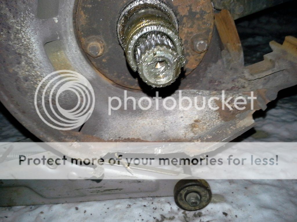

And now, as promised, carnage pics.
The rotor
The backing plate
The busted stud
This was definitely the last lug nut to come off. The shear pattern looks like the stud got bent and snapped off.

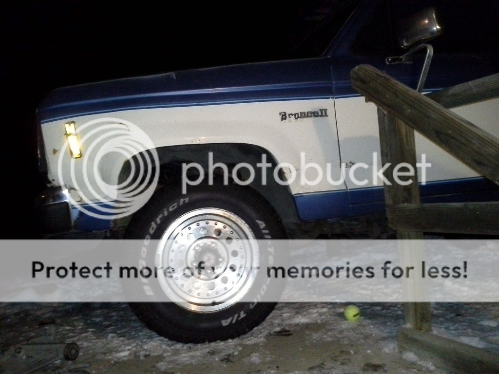

All back together
