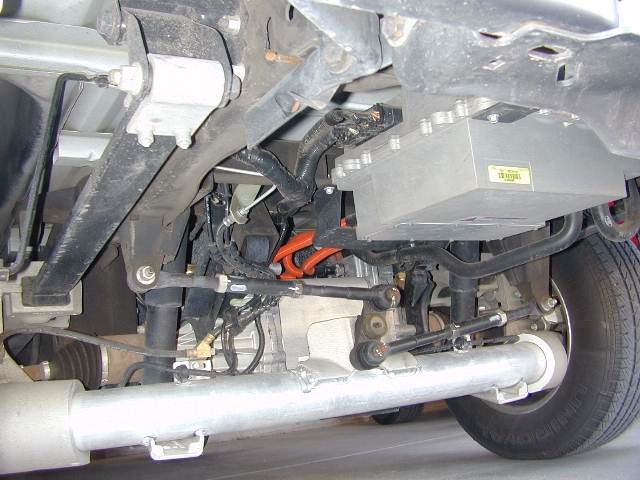

I can't see what the the leafs are connected to, the drive system is interesting. It's also got a cover on the bed, so I don't know what's hiding under there.
the rear suspension is called a "de dion tube". the springs are attached to the "knuckles". slightly clearer pic:
the battery trays are contained under the bed, between the frame rails (to keep the CG low). the entire bed is availible for cargo. bed covers are often employed to improve aerodynamics thus increasing range.
