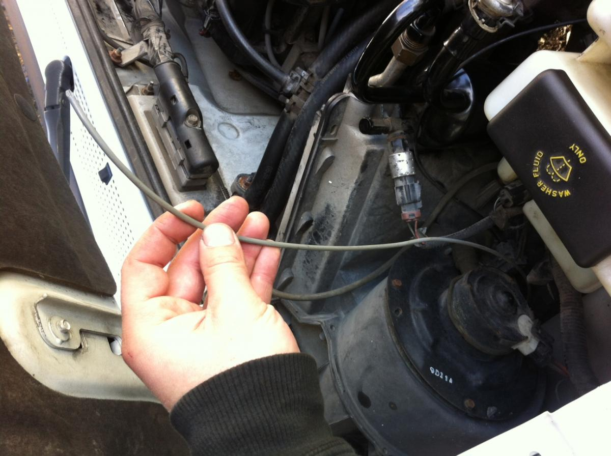

I would guess vacuum leak from a bad hose. I used to have the same symptoms. I cant find exact pictures but it was a small grey hose on left side of engine that had melted and left dangling. 2nd picture is where it should be plugged in
