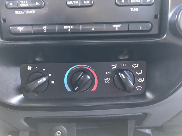

When I replaced the fuse, the blower fired up and worked at all speeds. Sweet! But as soon as I change the vent to anything other than the upper (IE: AC, MAX AC, upper and feet, feet only and defrost) the fuse instantly pops.
I can switch between OFF and UPPER at all speeds with no problem, with heat or ambient air. But any other location will blow the fuse.
It blows if I start the truck in any of those spots, and blows if I use the switch to change from upper to something else.

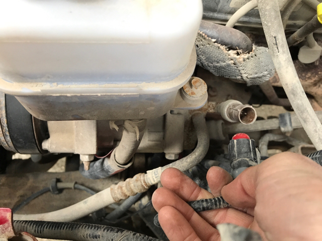

Just to be sure I did it right, this is the connector I took off.
Oh and second question - so the fact that I can't get the fan to blow at my feet only (instead it's full defrost), that is a totally separate issue??

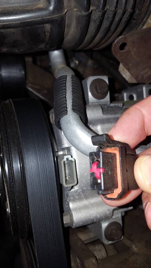

Ok. First, I believe you unplugged the wrong connector. Below is a picture of my clutch connection. Yours should be similar and should be in a similar place near the front of the compressor. I think you unplugged a pressure switch, which also disabled the compressor.
That is a separate issue. That is controlled by things that are commonly called " blend doors" because they control the blend of hot and cold air, fresh or recirculated air and which vents blow. On older vehicles, they are controlled by mechanical cables, many newer vehicles use electrical motor operated doors. My old Mercedes uses vacuum operators. I'm not sure what year the change occurred in Rangers.

Eric - I did disconnect that wire first. The fuse still blew. Then I second guessed myself and disconnected the other wire at the back, as I pictured. That kept the fuse intact. At this point both wires were off. So I reattached the wire you are referring to, and the fuse was fine. So only by having the rear pigtail OFF could I retain my fuse.
Next I removed the relay with both compressor pigtails attached. With the ignition on I selected all the vent options. The fuse stayed intact. I replaced the relay with a new one and everything now works as it should.
