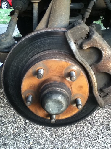

More woes for the Mazda (99, 2.5 2wd, coil sprung, 126k). I've noticed a hum above 40, especially turning right above 40, coming from the front of my truck for a couple months. I've also been having brake pulsation for a few months or more as well. Actually I can't feel pulsing in the pedal, but the whole truck kind of lunges forward and back when I hit the brakes. I lifted the front and rocked both wheels back and forth. I can feel a tiny bit of play on the driver’s front but not the other side. I guess that means my wheel bearing is shot on that side? I replaced the rotors, pads and bearings less than 30k ago I think. I’m no mechanic so it’s possible I screwed something up, but what? Could the pulsing be caused by a bad bearing? Here’s what my rotor looks like:
Is that normal looking wear? The pads seem to have plenty of material left. Moving the rotor back and forth like I do when the wheel is on, I feel no play. Also when I spin the wheel there is a dragging, metal on metal sound on both sides. I don't know if that's normal. Here's a video, I hope the link works:

When I was listening to the vid I was hearing the scraping sound for half of one rotation. That's why I was thinking a warped rotor. Heat is one possible reason for a warped rotor. It could also be crap steel that has worn down more in one spot or one spot that's harder than the rest and hasn't worn down as quick. Actually this fits into the pulsation better than having a warped rotor, as the rotor is thinner on one half compared to the other. In any case a new rotor is what I would do. New pads makes sense too.
As I understand calipers, there is some residual pressure in the line, about 2 lbs, that keeps the piston pushed out toward the rotor. At the same time, the seal of the piston is slightly rolled and when the brake pedal is let off pushes in the opposite direction but not enough to overcome the residual pressure. So... there is a very slight drag of pads against rotors. This is normal.
If one rotors bearings can't be adjusted to where there is no slop, there is a problem. There is wear somewhere and one possibility is the bearing races that are pressed into the rotor. Another possibility is the race to spindle. I've seen one race that was loose, causing the problem you seem to be experiencing. Changing rotors and bearings could solve the problem. But it could be spindle wear too. Take it apart and clean really well, and then a very close inspection.

What I would do is take off the caliper and pads and rotate the rotors while looking at the side of them (where the fins are). What you need to look for is side-to-side movement; if you have even the slightest, you have warped rotors.
Also, if you have looseness on the driver's side, it could be bushings or ball joints, besides bearings. However, if it is the bearings, it sounds like they simply need to be repacked and adjusted properly. The way to adjust the bearings is to tighten the nut up all the way, then loosen it a half-turn or so. If you do this, make sure that the bearings have plenty of high-temp grease.
