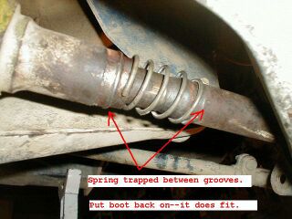

You have to pull the pig out of the beam to replace it. When you are putting it back together, take that E-clip off the pig-shaft and use a spring to keep the shaft seated. Then you can service the pig-shaft without any trouble. You need a spring with a 1-3/8" ID about 3" long:
