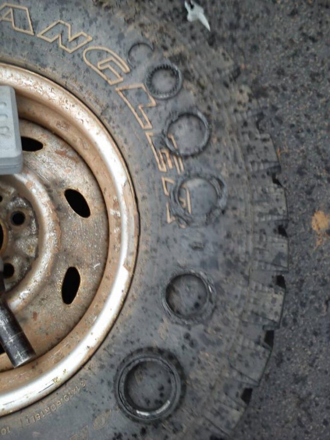

I didn't take pics of the hubs but they look fine and the splines on the axles look fine too! I'll check diagrams tomorrow for the innards and stuff but here's what I've got uploadfromtaptalk1400636647719.jpg
C clip, splined washer, washer with triangular shapes around it, plastic shims, spindle nut and outer wheel bearing

Best I can tell from that pic it looks about right. Kinda looks like you have the auto hub spindle nut though?:icon_confused:
Yea its definitely not the spindle nut for manual hubs, but i guess it worked so i might or might not grab manual hub spindle nuts from the j/y today. I might have been out to lunch on this whole thing haha when i put the axle shaft in the locked hub while its in my hand it hardly moves at all... oh well!
Thanks for all your help and advice though :icon_thumby: im learning quite a bit from tearing the ttb apart!
