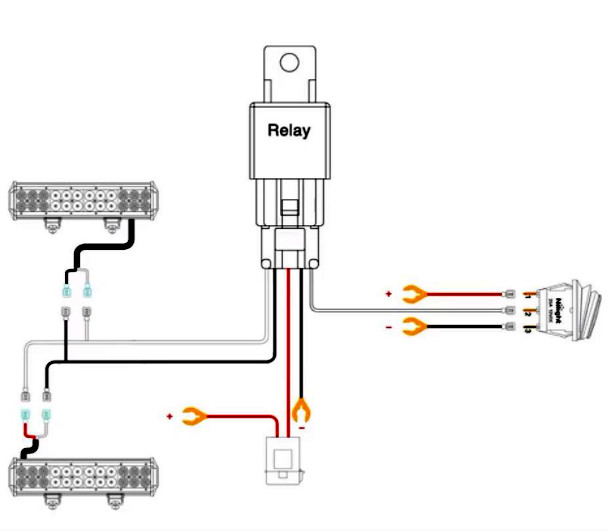

My 1996 Ranger did not come with fog lights. I have read that some people have found the wiring for the fog lights tucked up under the truck. Mine does not have it. I got an OEM fog light valance and put it on. I made my own mount brackets out of angle iron and mounted up some led fog lights in the holes. Now, for the wiring.
I know it can be done, but I am not completely sure how to make it so that these fog lights turn on with the high beams. I know enough to not chance it without asking questions first, so here I am.
I know that instead of a toggle switch to turn them off and on, I have to use the high beams as the switch turn them on. The toggle switch will allow me to change whether the fog lights come on with the high beams or not. Meaning, with the toggle switch on, the fog lights and high beams come on together. With the toggle switch off, only the high beams turn on.
I got this harness from Amazon and thought I could modify to work for me.
Just as the harness came, without modifying anything, I did a trial run on a spare battery and connected everything together. Everything works as it is intended to, so I know the harness is good to go.
Here's the wiring diagram that comes with the harness.
Do I take the white wire from the toggle switch and splice it into the high beams? Do I do this and use a 2-pin switch instead of the included 3-pin switch? Am I even close?

Simplest way to wire it is with a relay in the engine bay and ONE small wire run into the cab, this is the Ground for the relay that will activate it only if high beams are on if that's what you want
Relays have two parts
Coil, it activates the relay, very low power draw, maybe 0.5amp
Load, it carries the 12volts that powers the Driving lights
The coil needs 12volts AND a ground to activate, 95% of relays in a vehicle are GROUND activated
So you would splice into either High Beam power wire in the engine bay, and connect that to either Coil wire on relay
The other coil wire will run into the cab and go to your toggle switch, then switch is grounded to cab ground
This can even be a lighted switch, i.e. it lights up when its ON, 2 pin with internal NON-LED light
So activation wiring is done, and switch would only work if high beams were on first
(you could use a Key on 12v wire as well, so they would work even with lights off, but key on)
High beam wire(splice)---------coil---------------------------------switch---cab ground
For the Load you need FUSED battery positive voltage, say 15amp fuse, and at least 18gauge wire but look at the specs for the driving lights, see what each one needs, may only need a 10amp fuse for LEDs
The fuse goes as close to the battery as practical, NOT close to the relay
Then 1 or 2 18gauge 12volt wires from the 2 driving lights to the relay's other load wire
Driving lights are grounded to rad support or frame
Battery12v---fuse-------------------load Relay======(2 wires)==========lights====ground
The reason why car makers use ground activation, for pretty much everything, it to minimize SHORTS, way fewer 12volt wires running around the vehicle
If a ground wire shorts to ground the very worst that can happen is something turns on, so normal operation, but maybe you don't want it on, lol
If a 12volt wire shorts to ground the BEST that can happen is a blown fuse, the worst is a vehicle fire, so big downside in running long 12volt wires around a vehicle, lol

Thank you. I think I understand. The relay is what confuses me the most, and is why I got the prewired harness.
