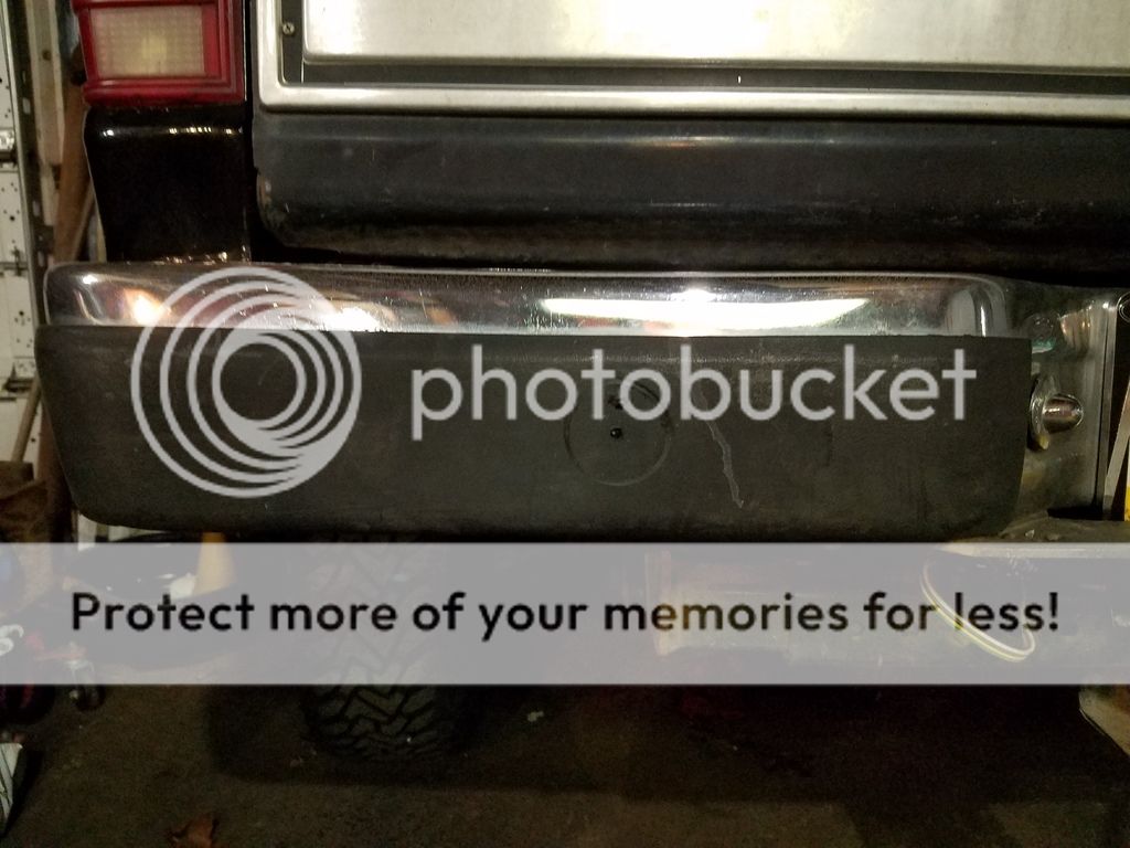

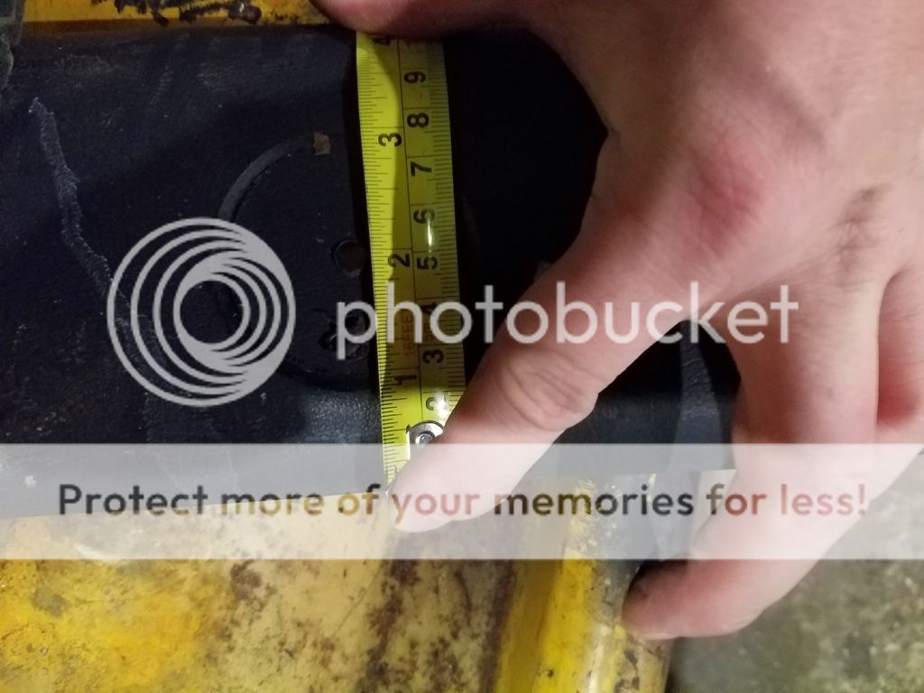

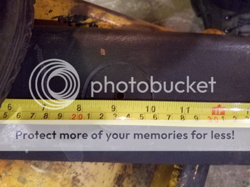

Step 1: Measure out the proper position of the hole for the plug itself.. I removed the cover to make the hole and then measured it out so those after me wouldn't have to.
Position of hole if you remove the cover:
Position of hole if you measure from the front:
This position is critical. Too far to the left and you hit a brace. Too far to the right and you have a carriage bolt in your way. This also puts it away from everything behind the bumper. This provides a lot of good protection because the curl of the bottom of the bumper is almost exactly the same length as the plug.
Measured with the tape hooked to the inboard edge of the over.
Measured with the tape hooked to the top edge of the cover.

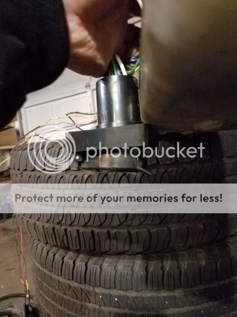

Step 2: Cut the angle portion off the mounting bracket. (Optional)

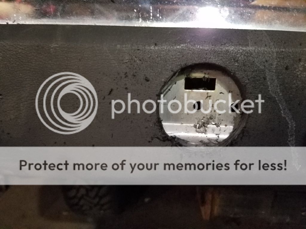

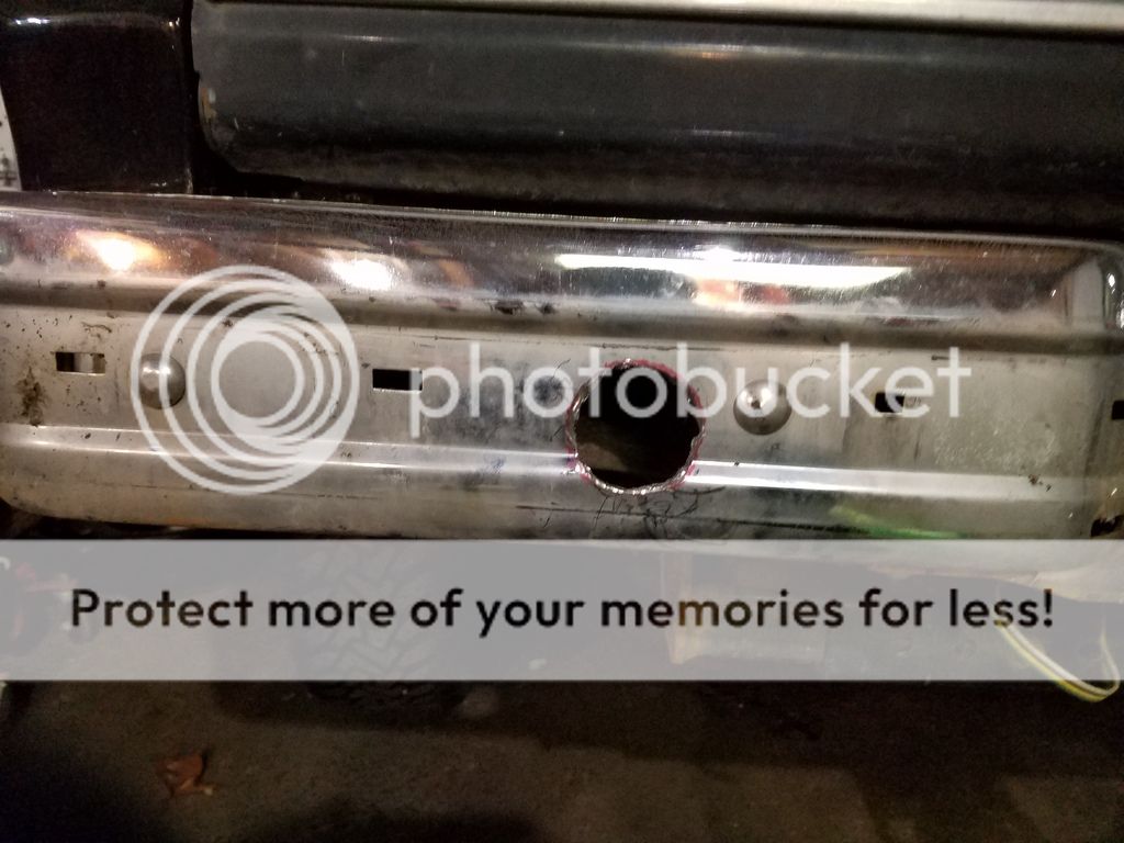

Step 3: Once you have made your measurements use the hole saw to drill out the cover. In my case I had to use a different bit to drill through the bumper because the pilot on my hole saw sucks. I knew this going into it so I put the cover back on the bumper to make my pilot hole in the bumper at the same time.

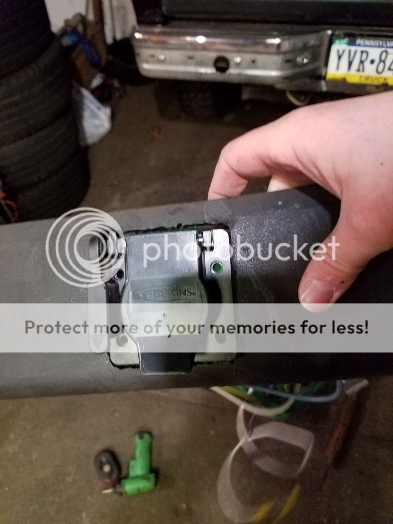

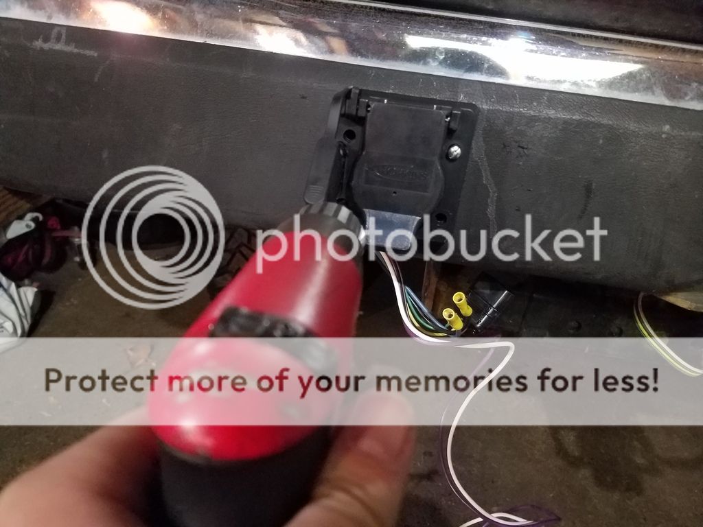

Step 4: Next install the cover (if removed), install the plug in the bumper and use it's screw holes as a template to drill pilot holes for the screws.
The lower holes were more difficult because they landed right on the corner of where the bumper angles under the cover. I used the mounting bracket to help hold the drill bit stable.
Step 5: This is where things can go one of two ways. If you have longer screws just drill holes and install screws. If you are using the screws that came with the kit there is more to do. With the cover in place and the plug sitting over it the screws in the kit just sit flush with the metal of the bumper. This means the cover has to be cut out so the plug can sit in the hole and right against the metal.
NOTE: At this point you should have a circular hole in your plastic for the plug and 4 holes for the screws either way.
To cut the square hole out you should hold the plug in the hole with at least two screws in and trace it out. Then cut it out. I ended up using a die-grinder because I didn't have anything else good to use.
Once I had the hole cut I trimmed it back until the plug fit through easily. It was important in my case that it fit easily the whole way through because my base is tapered.

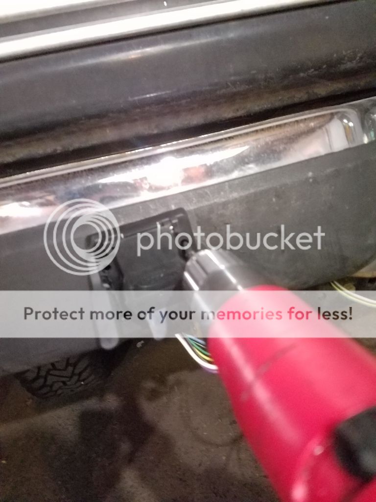

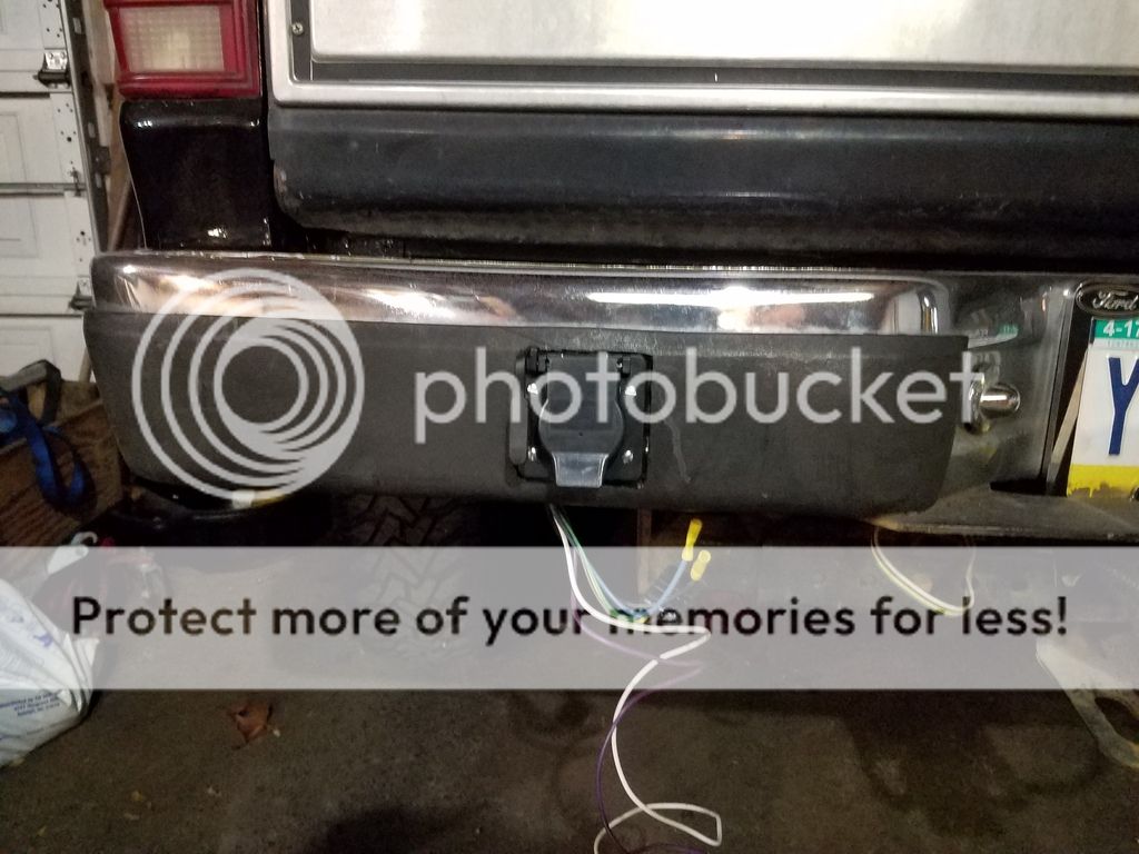

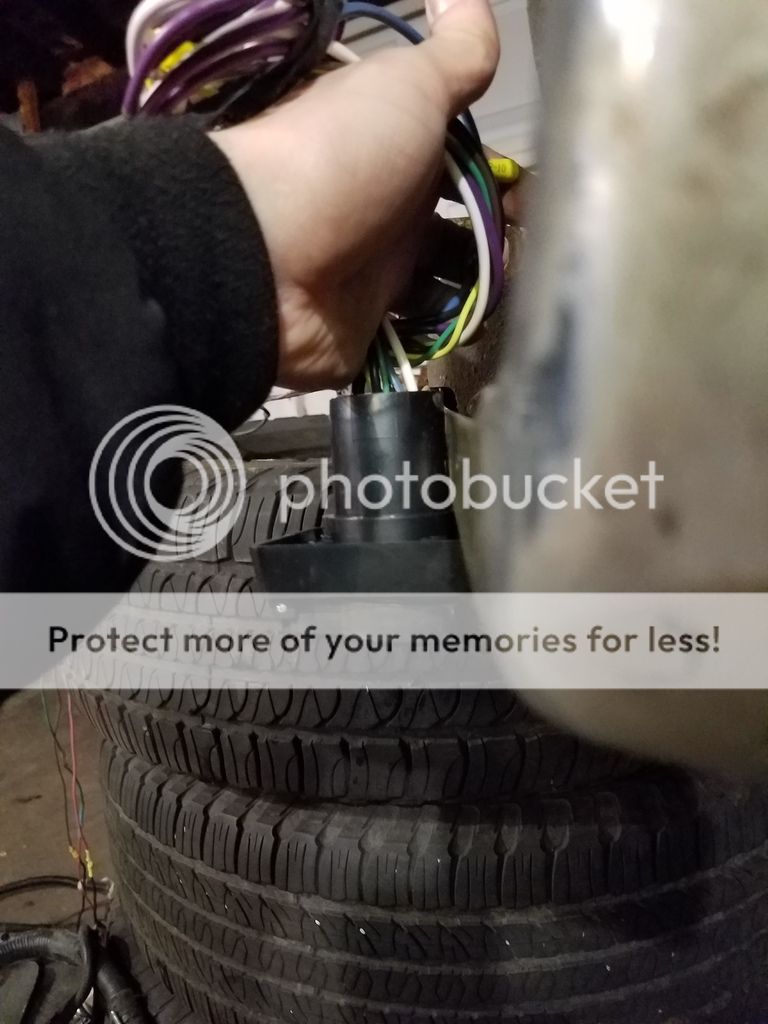

Step 6: Once the plug fits through your hole properly and easily install the plug on the bumper and put the screws in loosely. Then reinstall the bumper cover around the plug.
Wire as per kit instructions. My truck at a functional flat 4 already so I used a kit that plugs into an existing flat 4 for the lighting.
Test all functions for proper operation before towing.

One problem I've run into when drilling chrome is the bits dull almost immediately. I solved that by using a grinder to remove a little bit of chrome in the spot I want to drill.
Looks good.
Yeah, drilling into chrome is tough on bits. The pilot for my hole saw has been shot for a long time, but my Snappy bits took it like a champ. As for my hole saw, it was an el-cheapo meant for wood. The metal bumper took the teeth off right away while the saw didn't even leave enough of a witness mark to see where it had been working.
I ultimately traced the outside of the hole saw, cut a cross in it with the grinder, then traced the edges of my circle with the grinder and beat the quarters in then ground the bends down. After all that I took a rasper to the edges and cleaned them up until the plug dropped in nicely.
I didn't include all that detail in the write up because I would hope anyone who tries this would have the sense to know how to cut a hole in something with the tools they have.

Ah, well, you succeeded and it's as good as it needs to be...
