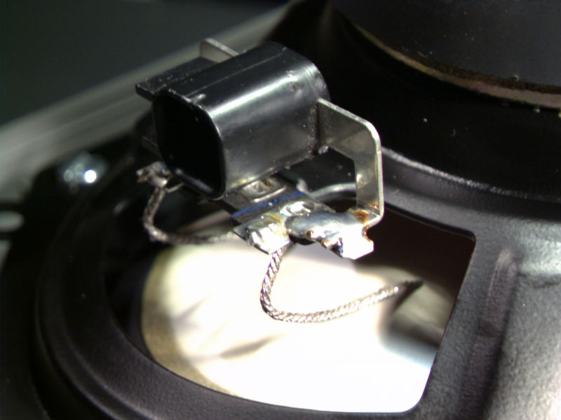

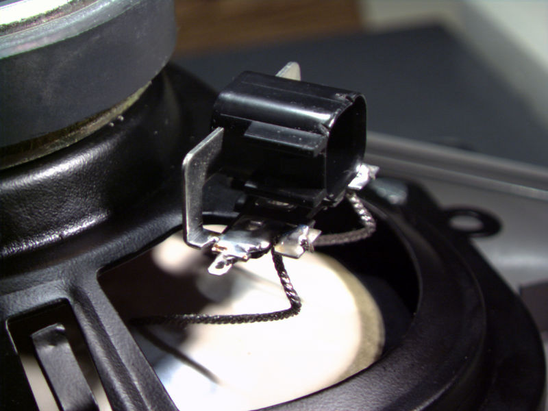

Remove the old speaker, it is held on by four self tapping screws
My speakers came with single sided sticky foam, this works great and eliminates and rattles that you would get from a metal to metal mounting. If yours came with it too now is the time to install it.
This speakers also come with mini crossovers on them. Cut the old connectors off the wires and strip the wires. Then loosen the phillips head screws in the crossover, places the wires in the holes (wire with no stripe is positive, wire with black stripe is negative), then tighten down the screws to secure the wires

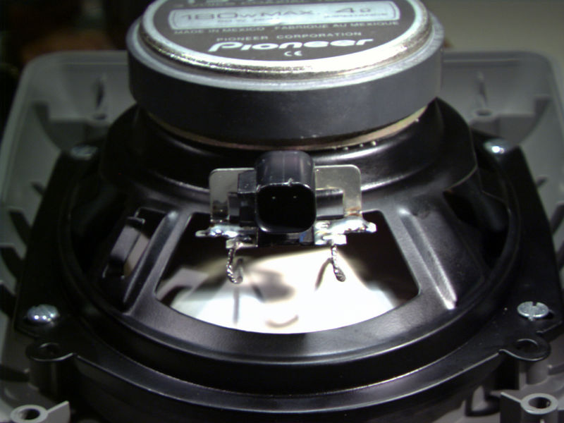

Heres the old speaker
It is secured the same way, remove the four screws
Pull the speaker out, and install the single sided sticky foam
