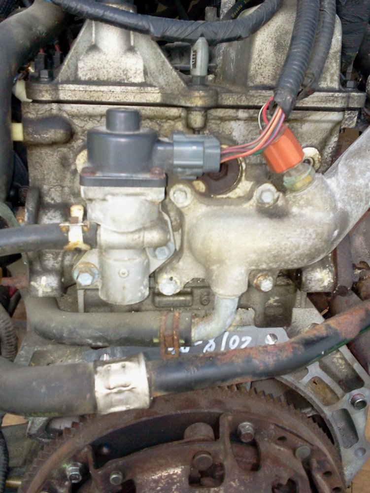

what does the cylinder head temp read? it's right in the middle of the valve cover, between plugs 2 & 3.
the ECT sensor is the orange one.
the 01s have a heater/sensor in the thermostat, yeah, really.
they are problematic, I would start there.
assuming the thermostat is stuck open, try completely blocking the radiator with cardboard, does the engine then heat up more?
