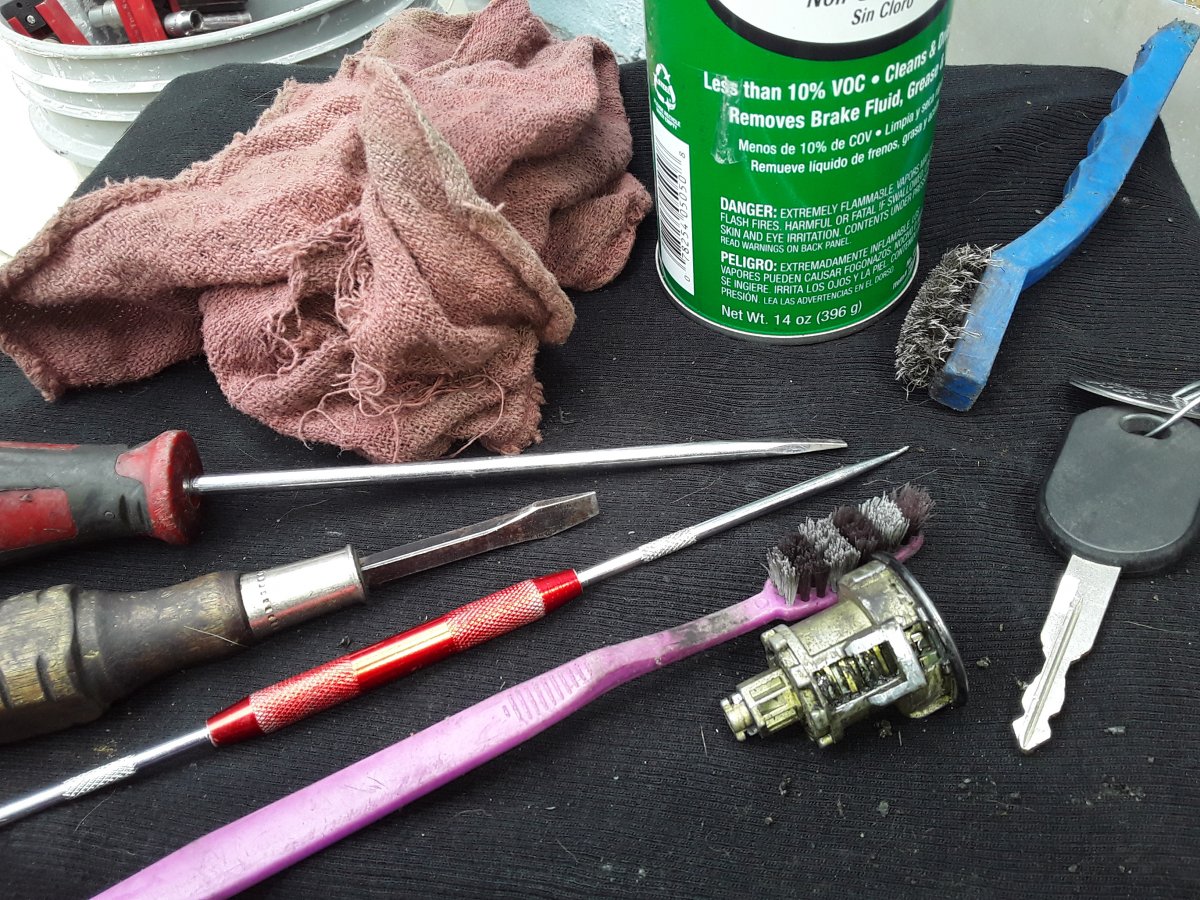

O.K., I did the cleaning thing, WOW did a lot of dirt and old rock hard grease come out .
My problem appears to be the tumblers/dogs/flakes whatever you call them, are worn so I need to take the lock apart and re key it ~ the re key part is dead easy but I cannot get the darned outer cover off ~ I've tried prying it hammering it, I even attacked it with water pump pliers, no joy .

FWIW : the cleaning and then careful application of graphite got it so I can jiggle it open in two minutes instead od five but I need to fix this .

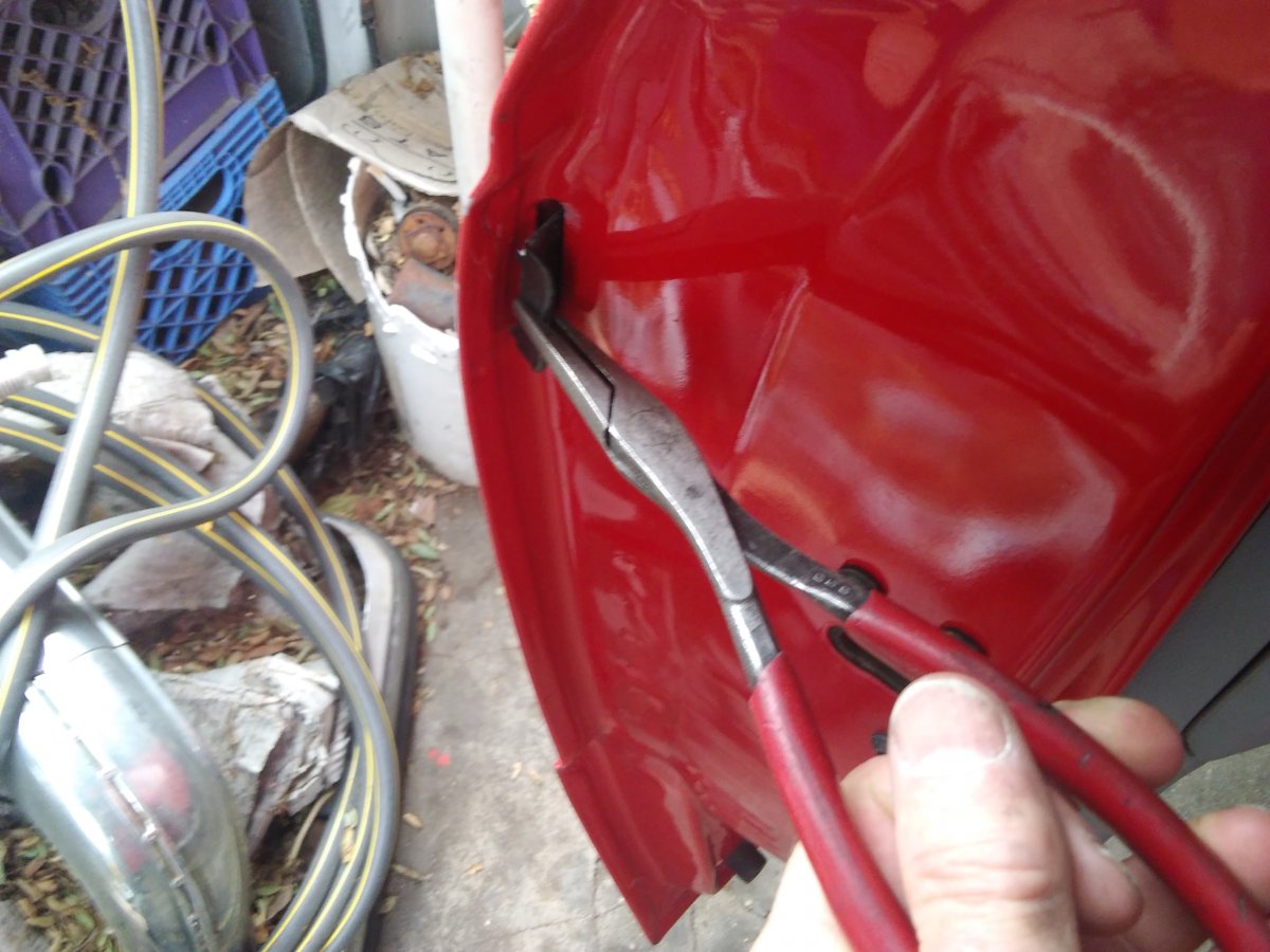

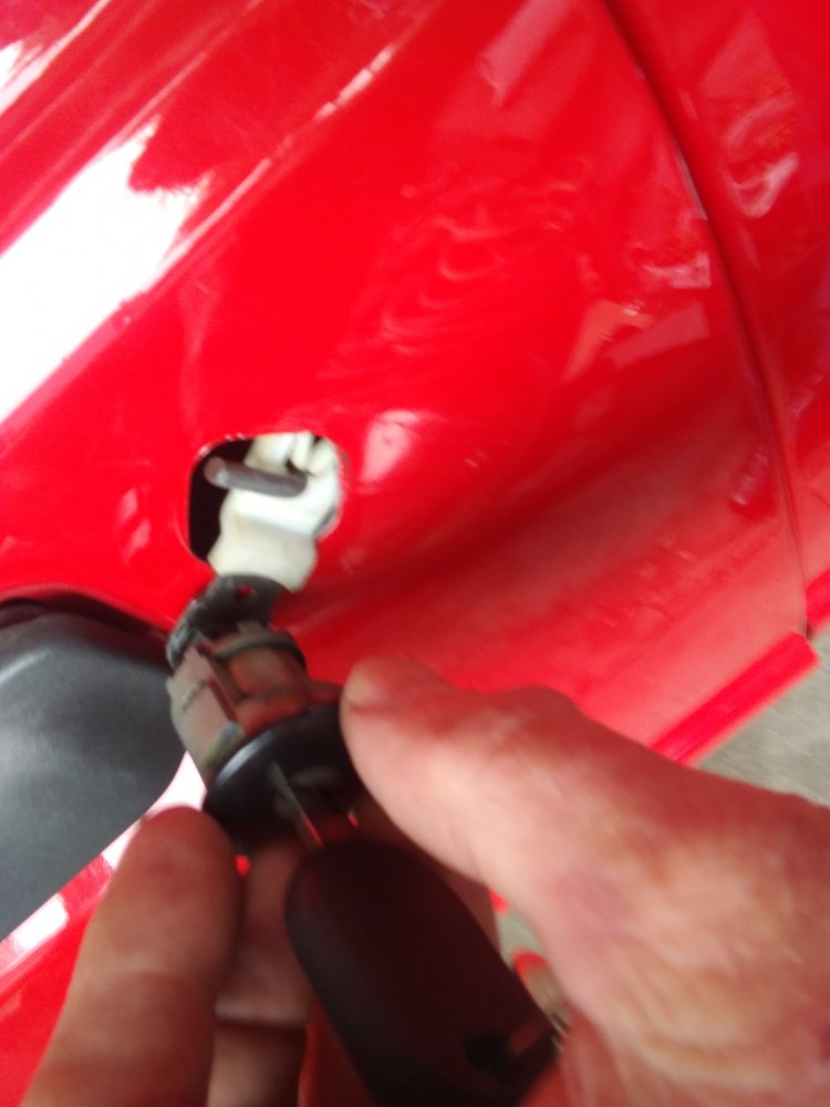

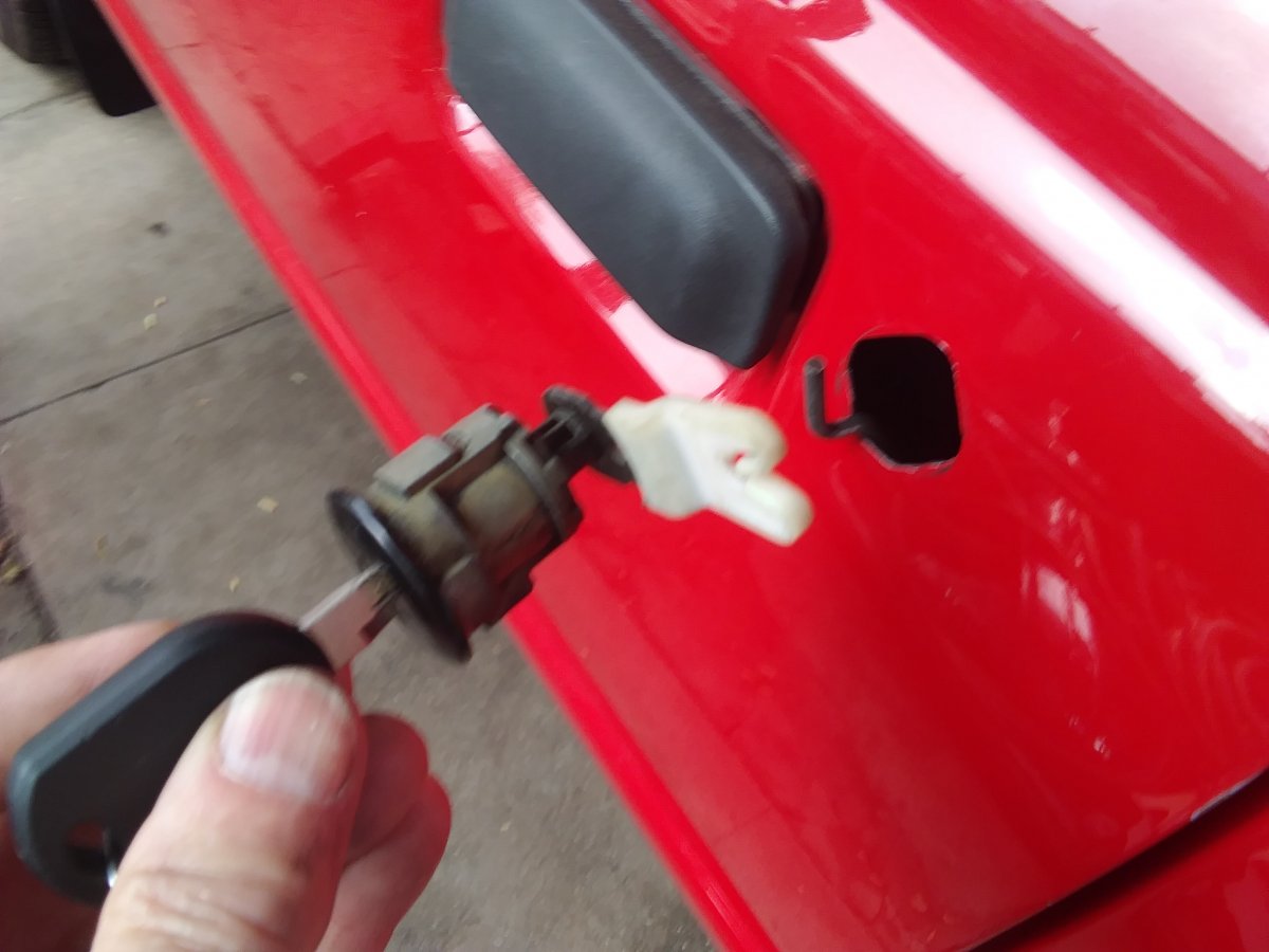

If you're careful there's no need to remove the door cards .
I wasn't careful enough on the passenger side one, off it came, not difficult due to extremely good engineering .
Once you have the clip out wiggle the lock cylinder and it'll come loose, once you have it out of the door's hole unlock the lock, this raises up the control rod giving you much more working space, easier to work the plastic clip of and back on the rod , then lock it again to make it easier to re insert the lock cylinder in the hole .
Press the lock against the door skin as you push the holding clip into place and you're done .

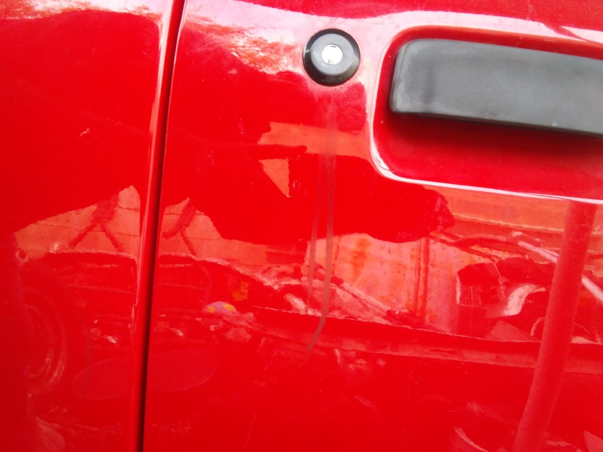

Because I'd sprayed liquid graphite in several times I had dribbles of crud on the outside of the door that had dried and wouldn't wipe off .
So I grabbed some liquid wax, not cleaner wax and used a clean soft rag (an old sock, my teenage Foster boys run through them like mad and they're very good rags) to polish the paint back to it's original shine .
Looks nice .

The little plastic clip on the end of the lock cylinder has a dog leg to it .
I set them so the dog leg set inwards instead of out wards, the locks work smooth as glass again .
The plastic thing is often quite brittle so work it gently off and back on the actuating rod .
I used a thin long tool to hold the rod in place as I easily twisted it slightly to slide past the 90 degree bend .
