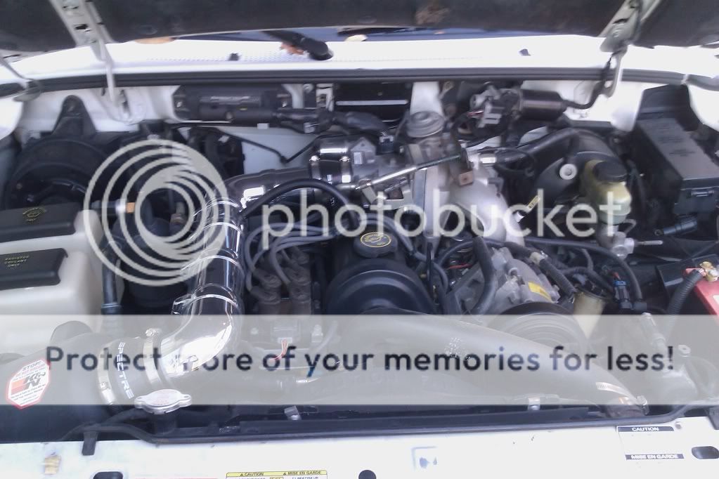

Step 1: open your hood and locate your coil packs (you'll only be working with the FRONT pack)
How To: Dual Igniton plug mod for 2.3L and 2.5L

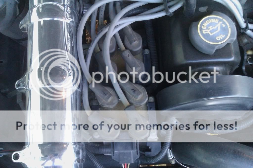

Step 2: label your wires so you know which ones they are
here's a little diagram just in case
4 2
1 3
Step 3: remove all 4 wires and re-install them in this order...
1 3
4 2
