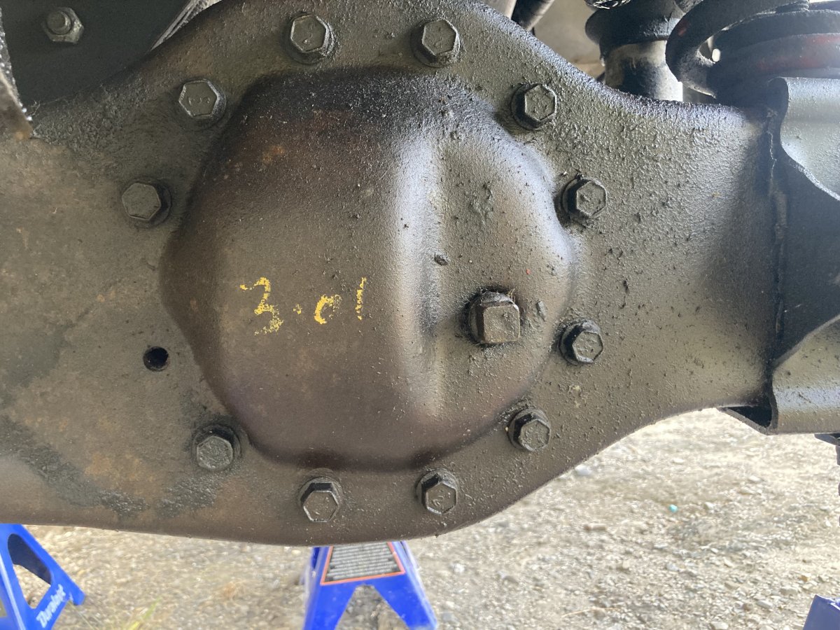

I’m in the middle of rebuilding my Dana 28. My front diff has, i think, “3.01” hand written on it by someone. Although it could be partially worn off.
In any case, my VIN axle code is F7, meaning my truck was spec’d as having 4.10.
Is there a way to confirm the gear ratio’s of both front and back diff’s, without opening them both up? Are there stamps or tags somewhere? I took a look and didn’t find one on either front or back.

My first guess would be March of 01, meaning when it was replaced or last serviced.

I’ll go ahead and run the test. I’m hoping it requires 4.1 turns to make the yoke go one turn. I’d hate to discover this front diff was replaced with something not functional. It would be great is that hand writing is March 01, but you’d think that the guy would have maybe used a complete date so as to not make someone think it was a gear ratio !
Test complete, it is 4.10 in front. Whew! And I’m sure it’s 4.10 in back.

3.01 was never a gear offered in the ranger, or by ford period as far as i know.
