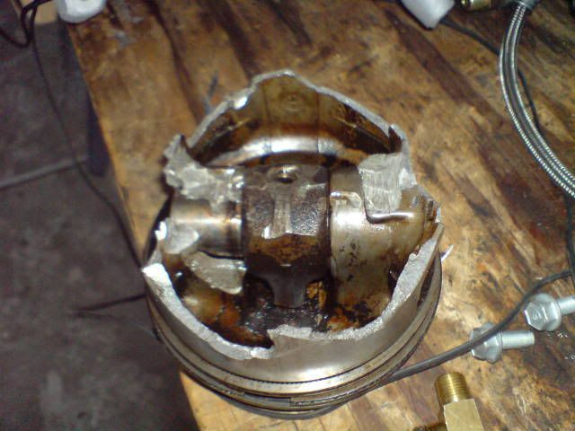

i fig you could go 10 12 stock but not 30, i wouldnt go above 12 stock anyway just incase. that block pic sux and ive seen carnage like that b4 but it still sux.
