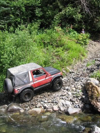

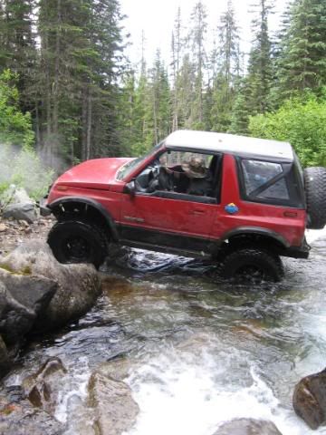

here is mine. Its a 92 w/ 1.3 stock with a shaved head and headers, toy axles front and rear, 4.10s, detroit locker up front, spool out back, YJ springs front and rear, 6.5:1 t-case, caged, five point harness and suspension seats, 33x12.50R15 dunlop mudders, power steering and full high steer. Needs a stereo and i need to reconfigure the cage so the stock doors fit back on
the best part is in almost all the wheeling i have done with it, ive yet to let the air out from 35psi that i run in them lol and believe me, ive hit some pretty nasty stuff with it. Moad, here i come!
Damn, that's a nice setup. I didn't know you had a Zuk.
