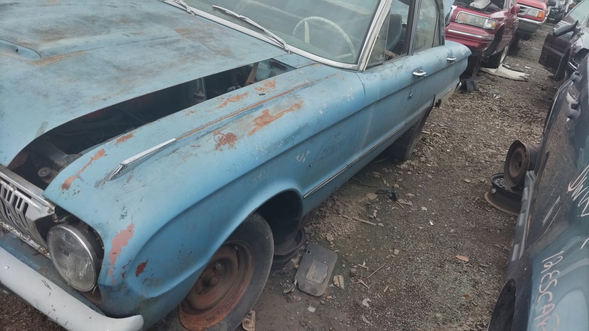

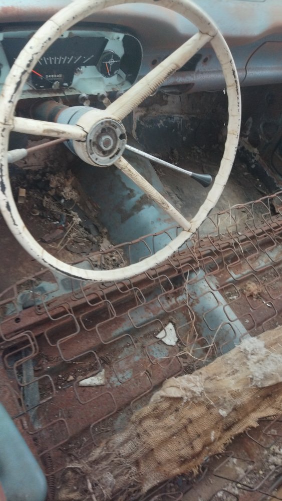

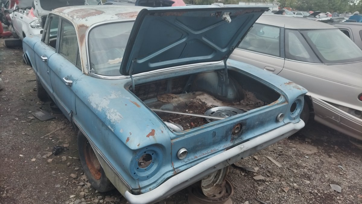

its wierd because i was looking at a 62 comet at the junkyard today and thinking that ranger powerplant would be perfect for it...
