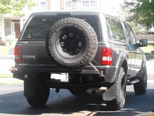

I remember using a cut off wheel to take mine down... then proceeded on tossing it in the scrap pile. Then I did this..

In the end... it's a pain in the rear on a daily driven part time work truck.

I like that mount. Been thinking of doing that to the 20 xlt. Wife dont want me to put the cap on it though. Her argument is valid. There is no way we could sleep in the 5 ft bed.
