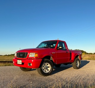

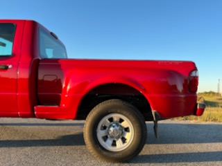

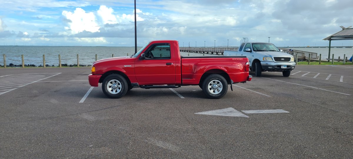

Mine had the lift blocks and pulling them did lower it 2 inches.
Here is with blocks
Here is with no rear blocks and lowered torsion bars
