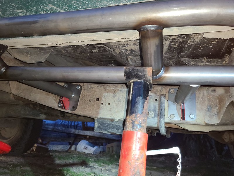

I bolted mine. Complete custom design. So I chose my mounting points and drilled my own holes.
Did you drill new holes or did you go based off holes that were already there? How did you decide to mount the plates where you did?
Drilled holes, just kinda put them as evenly placed as I could without interfering with anything. I made backing plates to go on the backside as well.

Seriously considering this myself. Will probably just be a square tube running wheel arch to wheel arch bolted to the frame. I hadn't considered backing plates before. That's a good idea. The frame is pretty thin.
I did the ones on my Explorer the same way that @85_Ranger4x4 did his. Same sliders too, those trail gear ones are legit.
On my 86 I cut the rockers out and replaced them with 2x4” steel tubing, 1/8” wall and then added another 3/16 plate on the bottom.
