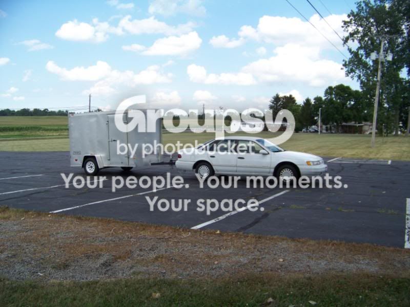

ive also found a way to do this with a taurus, bolted a pipe between the lower control arms to act as a axle housing, used a pipe coupler to act as a bearing and for the coil u-bolt to clamp to, used a conduit clamp to secure to top of the coil to the body of the car. my rear strut springs were weak and now it has a muscle car stance, the coil helpers are about 30 bucks at autozone. the car does ride stiffer but having good headlight aim at dark has been worth it.
