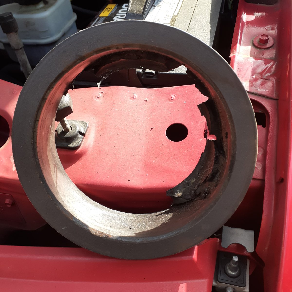

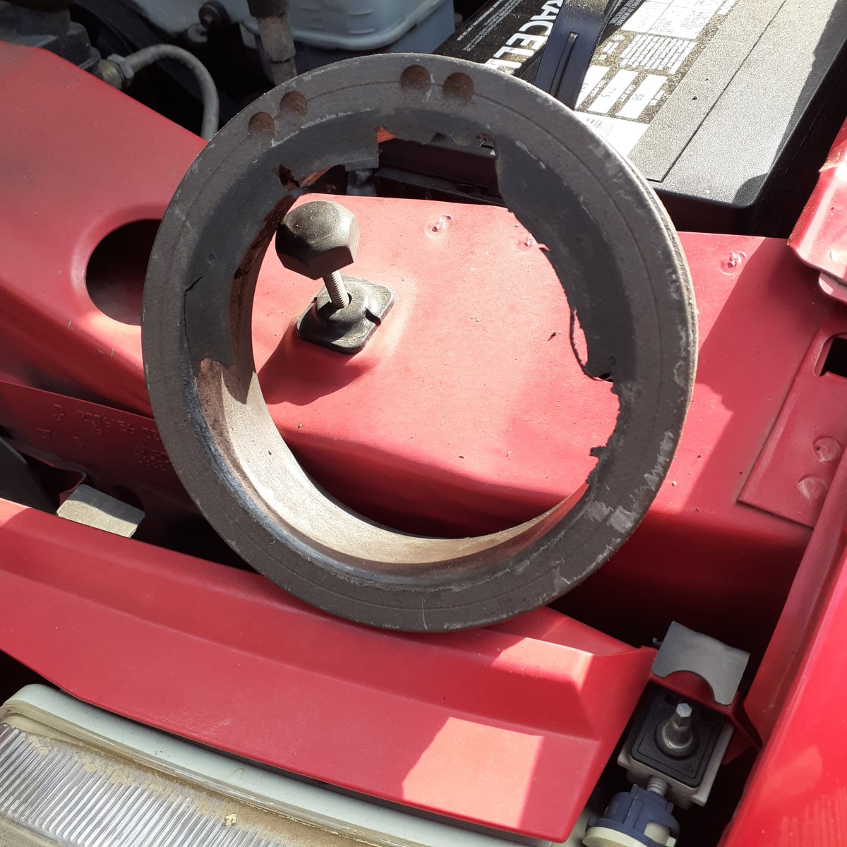

Some pictures, and it is grooved for the serpentine belt

Yep, your crank pulley/harmonic balancer came apart. It happens with age and miles. Get a new balancer, a new belt and put it back together. Check your fan over good to make sure it didn't get damaged from the pulley bouncing around in there.
I'm surprised that the pulley came off and the belt stayed on, but it obviously did. It's still tight because the diameter didn't change that much, the tensioner had enough range to keep it tight.
$200 in parts and it is whole again. Thanks for the input.
