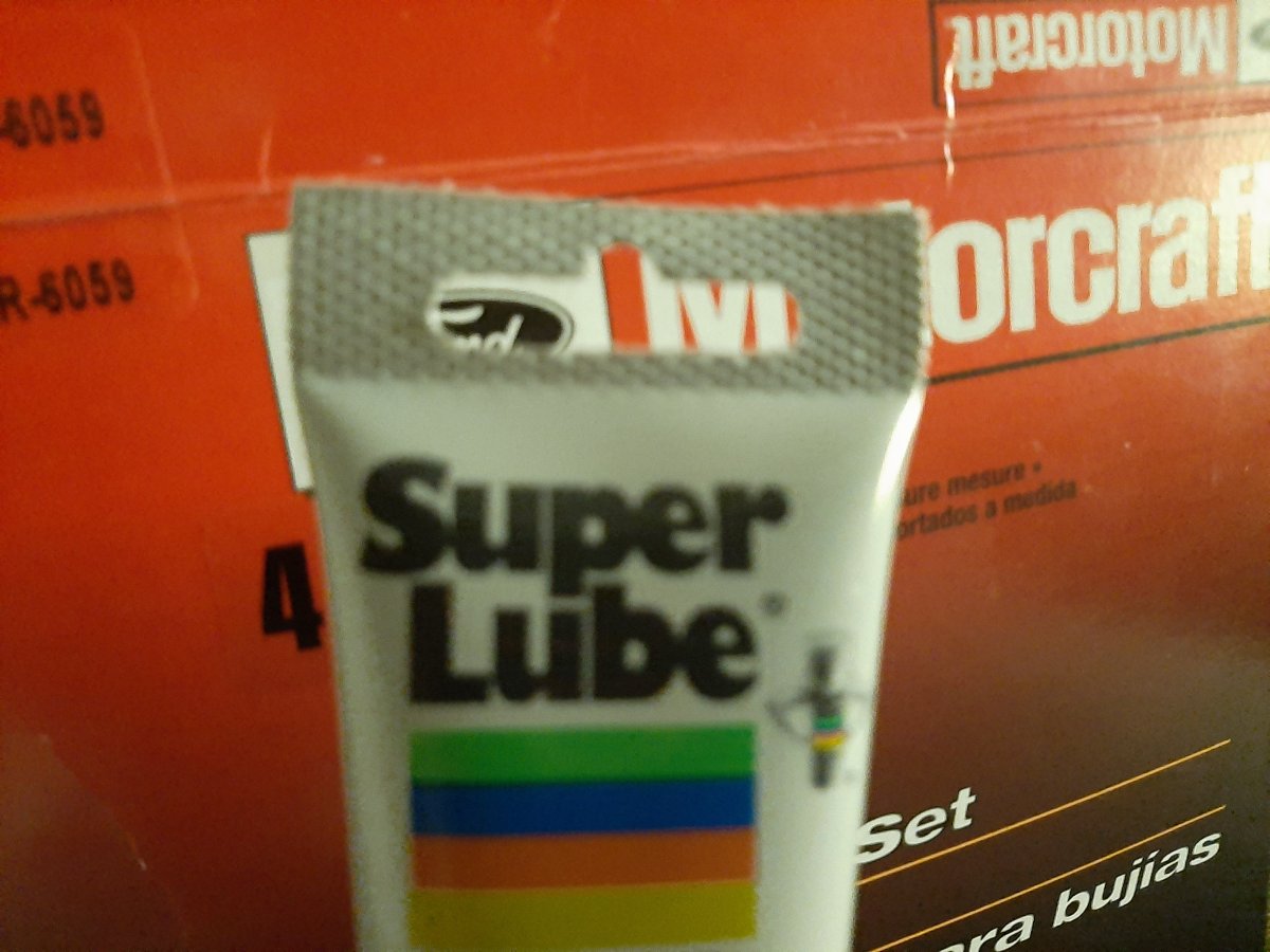

should i put some di-electric grease on the pins? there is plenty of old white grease on the rings but when i polish the contact surface i should degrease it first.
ted
Lube is your friend.
