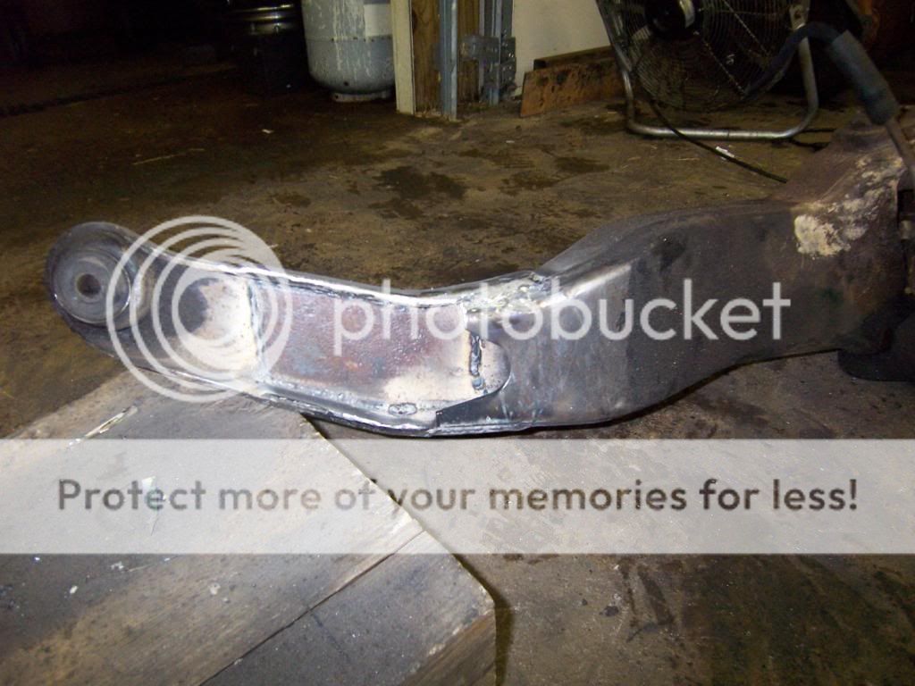

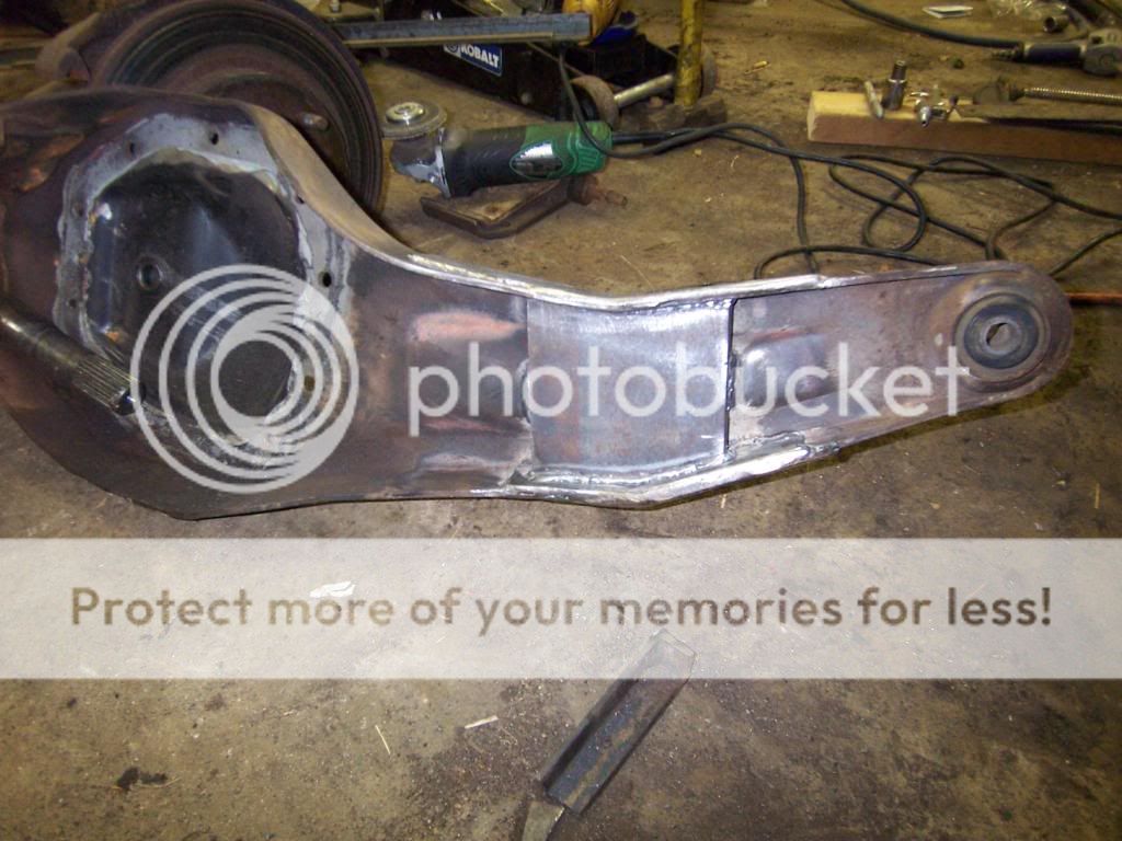

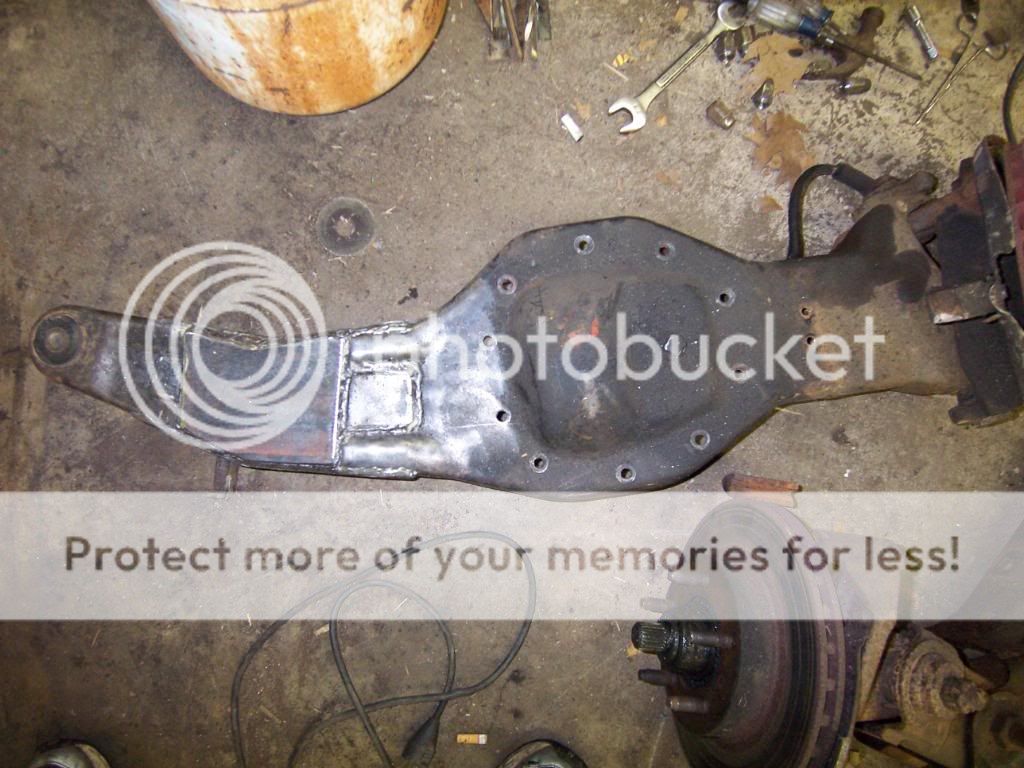

Took all day to weld, had to go slow so I wouldn't warp them. Bent for 3" of lift with stock mounting points. Best part is they only cost me $15 in materials.

From all the measurements I took before and after each side has lost about 3/8" of width. The only axleshaft that will be affected with where I turned mine will be the passenger side. It will need to be 3/4" shorter than stock but from looking at everything if I trim off the c-clip ear on the inner shaft and run the spring mod to eliminate the clip I should have more than enough travel in the slip since my suspension is going to be more droop than compression. I should be ok. We'll see what happens. I'll cross that bridge when I come to it.

I used alot of clamps as well as tacking on a few sections of angle to help keep everything aligned while I was welding. I also took a crap ton of measurements before, during and after to try to keep everything in check. As far as I can tell there is very minimal warpage if any. Once I get some more done on the truck I'll post a link to my build thread over on NC4x4.

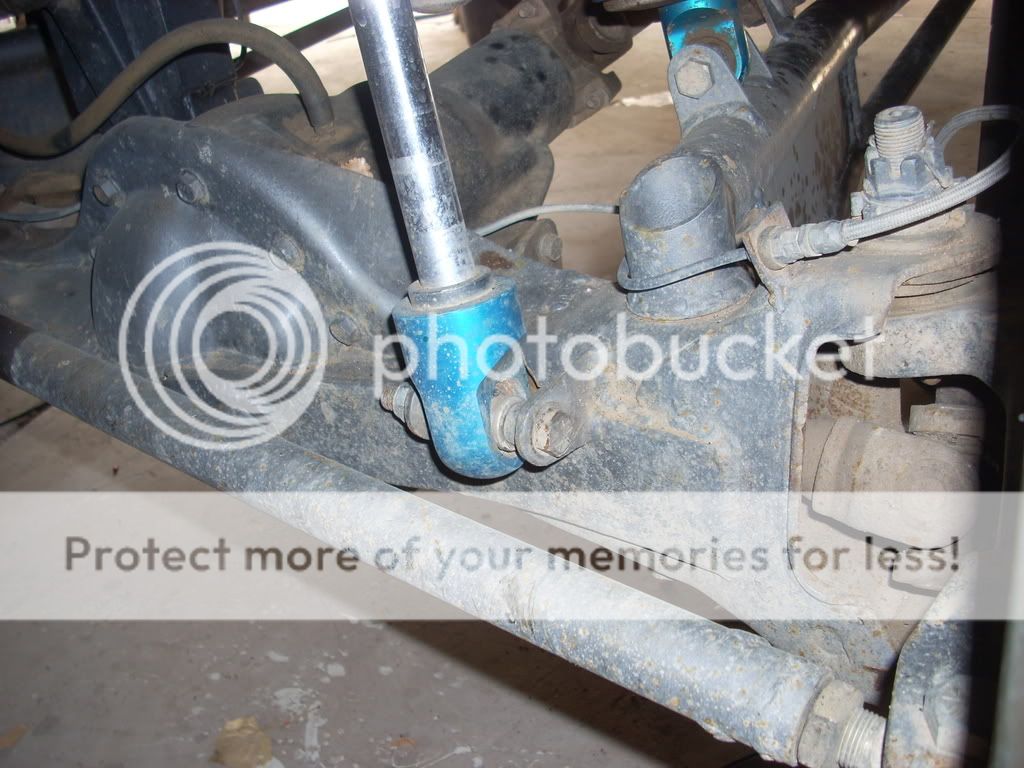

i did my cut and turned ttb this way it was lengthed near the bottom ball joint
if you can see threw the paint there was a triangle shaped plate installed over the top of it after it was cut and turned, this leaves the pumkin up higher out of the way.
