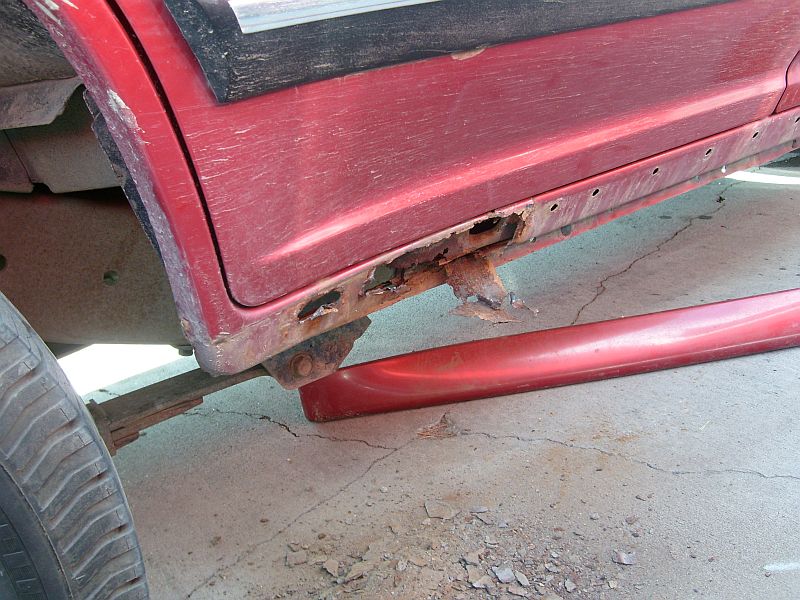

Well,
I picked up a maroon 93 Explorer XLT with a bad auto tranny for a song, at least here in Alaska, $400. Motor ran fine but needed a tune up. I put the 92 A4LD from my 88 BII project into it and tuned the motor up; runs perfectly now. :yahoo:

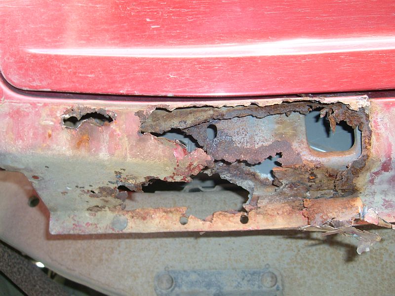

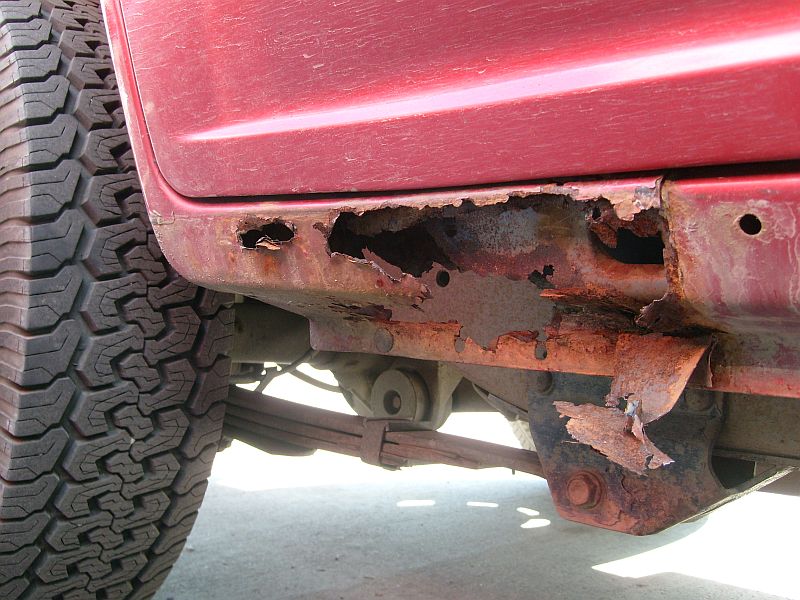

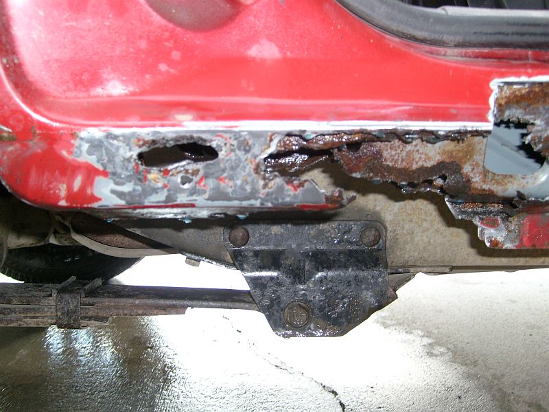

Well, I replaced the door hinge pins as the front ones were wiped. Felt pretty good so I decided to investigate the rust bubble I saw above rocker covers. Hmm, I knew these trucks with the fancy rocker covers develop rust there but.... Yikes, here's what I found on the right side. :shok: Like I said I had seen this on other Explorers with the covers so I was not overly surprised. I have not yet looked at the left side yet but can see it will be about teh same..... Cleaned it up to see what I had to repair. After removing the rotted stuff there was not much left so I looked into replacement panels and shipping to here. Yeah right, that's more than I paid for the truck! I happen to have a 91 I bought for the manual tranny with all new clutch parts and flywheel to replace the auto I took from my 88 BII project. It has perfect sheet metal in those spots. So before I junk the shell I'm going to excise those parts and repair this truck. So for now I cleaned it up with metal prep and coated everything in sight with POR 15 until I can get to it; no pics of that though as my hands were icky, even with gloves on. Looks bad but is just the outside metal to make the truck pretty. More to come.

Yeah I've seen way worse too, just not on one of my automobiles. I got the "new" metal cut out of my 91 donor last night. That's one thing about summer here in Alaska as it was 1100 clock last night when I got done and I had no idea it was that late as it was still full light. I was using my plasma cutter, cut off wheel in my angle grinder, sawsall and an air hammer and no one two houses over who were having a get together and no one complained.....
