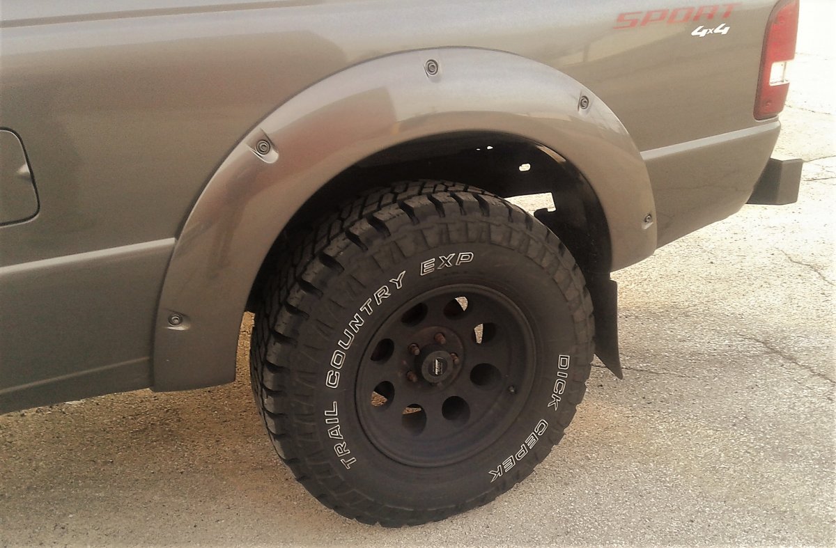

My 06 clears 32 inch tires on stock non modified suspension. I'm not a fan of the torsion key lifts personally... many folks use them... but they eat up all the down travel in the SLA torsion bar suspension. Here is a picture of mine at factory settings... the torsion bars aren't even turned up.
Picture of the rear... again on factory springs...
My guess is yours being a work truck... the suspension might just be a bit tired. I feel a better route would be to put in a set of new torsion bars and tweak them a bit with the factory keys and do a set of new rear HD springs to help carry the overlanding load and see where you end up. If you don't like the results... and a 1 inch body lift.
I know there are differing opinions on this so consider all your options and do what makes you happy.

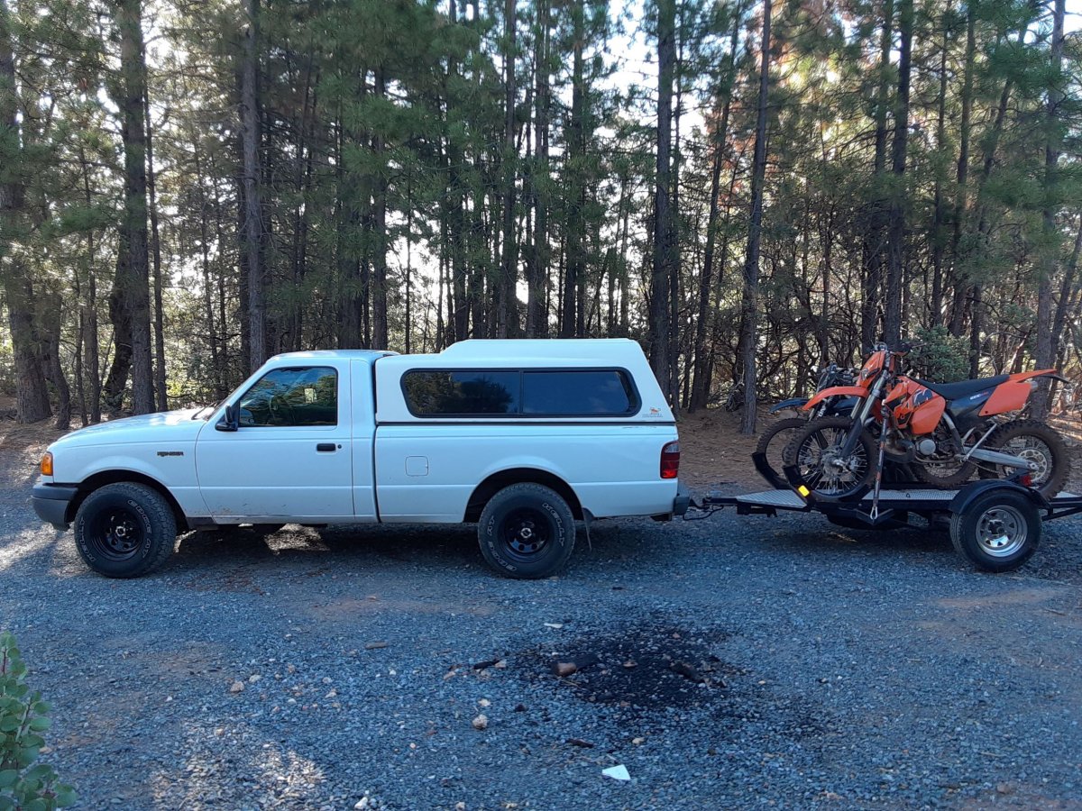

I think most of the PG&E Rangers were used for Meter Readers, this one ordered with 4WD to reach remote locations. Not sure why they would need a long bed though. The tailgate was off another (grey) truck. I recall PG&E Rangers using the cargo net style tail gate for many years.
I added the Camper shell and the black steel wheels. It came with a steel Weatherguard tool box in back, too big for my needs so I removed it.
