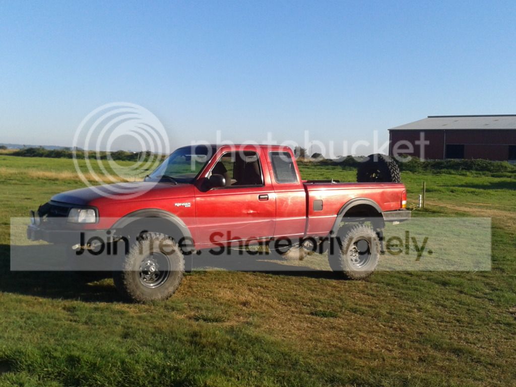

it was a 1997 ext cab 4l 4x4 and was red lol. its was in meh condition but ran good and was a good price to. only pic stock
hockeyryans ranger build

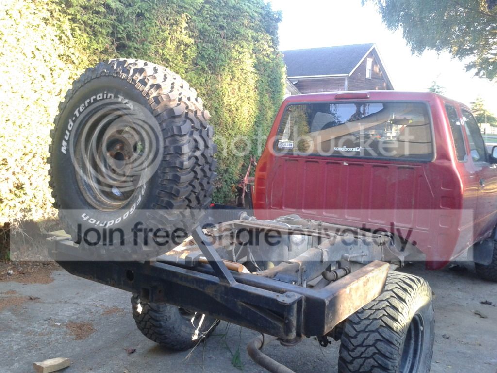

and within the last 2 weeks i did my chevy leaf swap and put on my rear bumper. looks like a bush truck now....

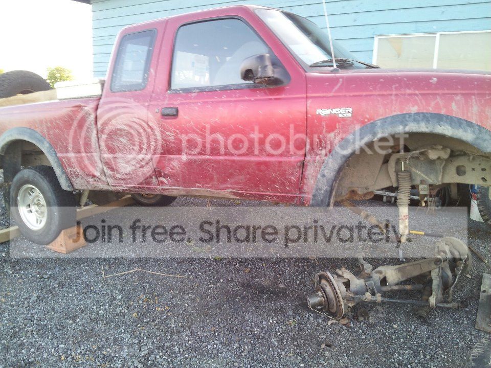

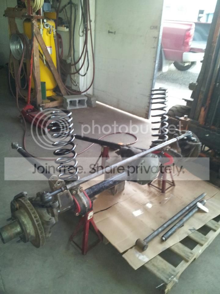

No real progress but I thought id share. The trucks front end has been stripped out and being parted out.
Dana 44 ready to go in

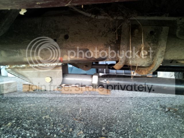

track bar mount done
radius arms mounted

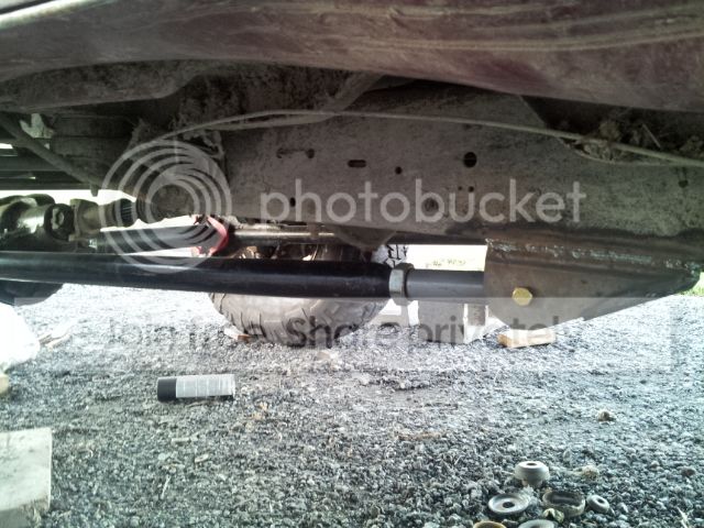

trac bar. Should hold hopefully

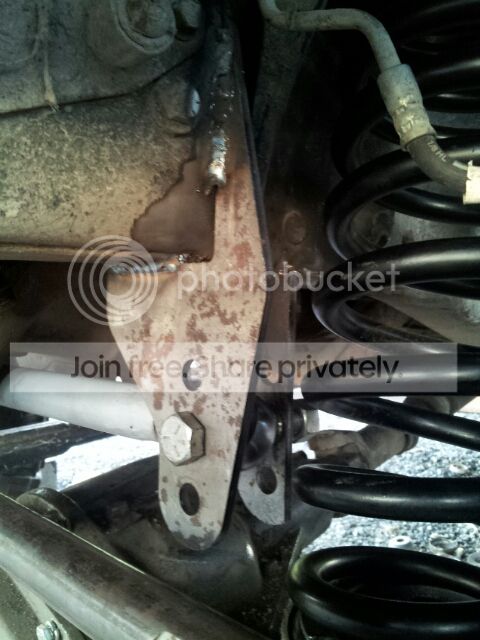

radius arm mounts

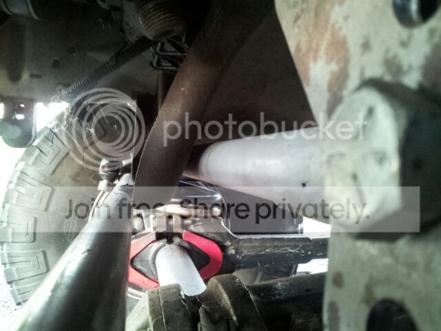

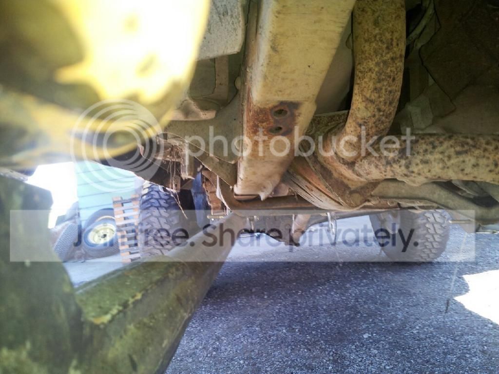

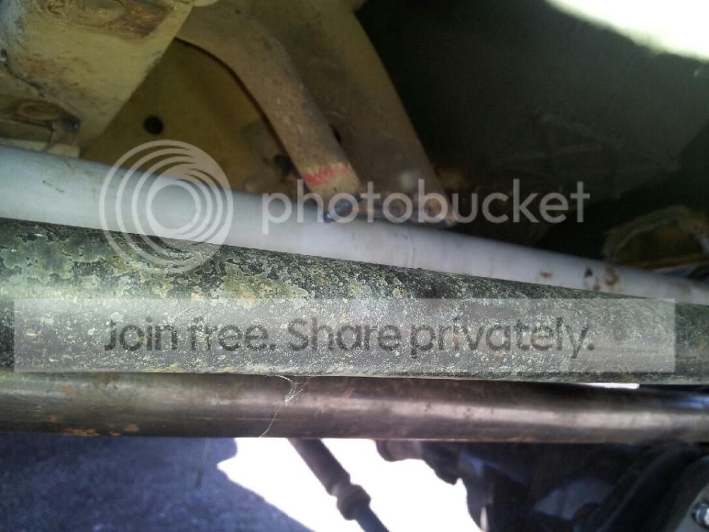

need to trim the cross member. The drag link and trac bar hit. So im gonna take the plasma to it

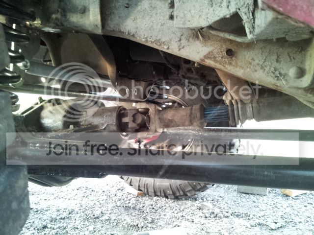

and does anyone know if my drive shaft angle is okay? Or do I need to do something about it

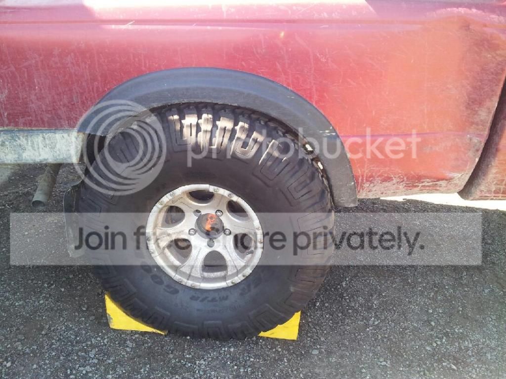

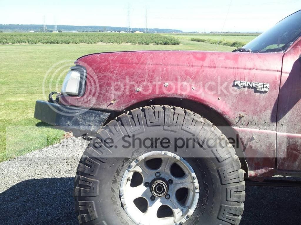

Lastly for today I might have to do some type of fender flares :S damn it lol

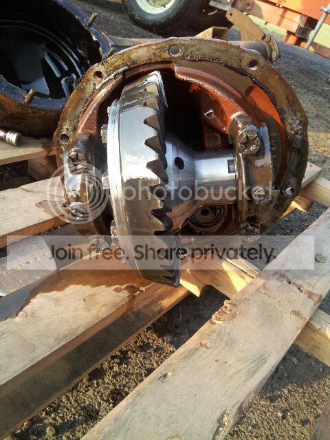

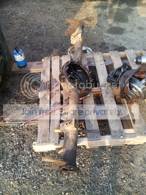

well i got the 9 inch axle taken apart yesterday. ugh what a pain in the ass to get the shafts out. The previous owner had re-drilled the shafts to chevy/toyota bolt pattern. Sooooo Im now looking for new shafts.
the 9 inch came with a yukon locker and 5.14 gears. So no re-gearing for me :headbang:

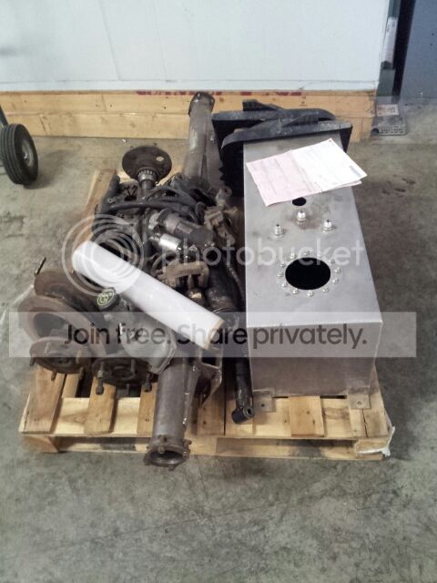

I found a hole in the housing soooo... Instead of going out and buying new shafts and bearings for my current 9" axle, I bought Isaacs old 9" axle, Also some other parts... Go up for a axle end up with a skid full of parts :headbang: Thanks man
So after my week of vacation I came home to a nice present

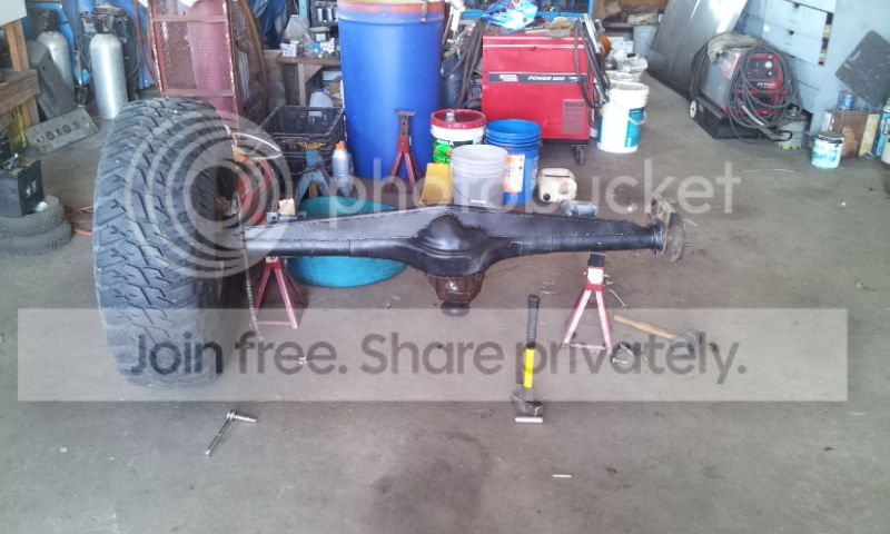

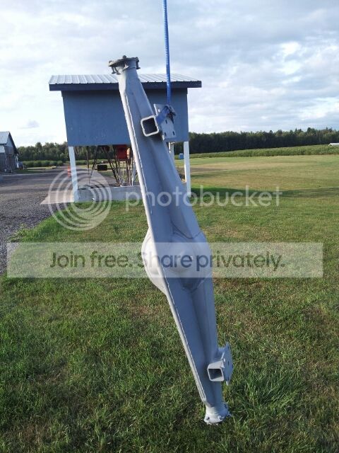

Primed axle

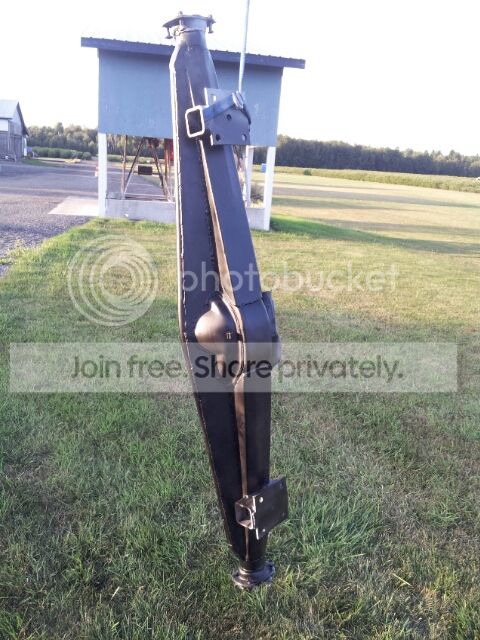

Painted
And half assembled

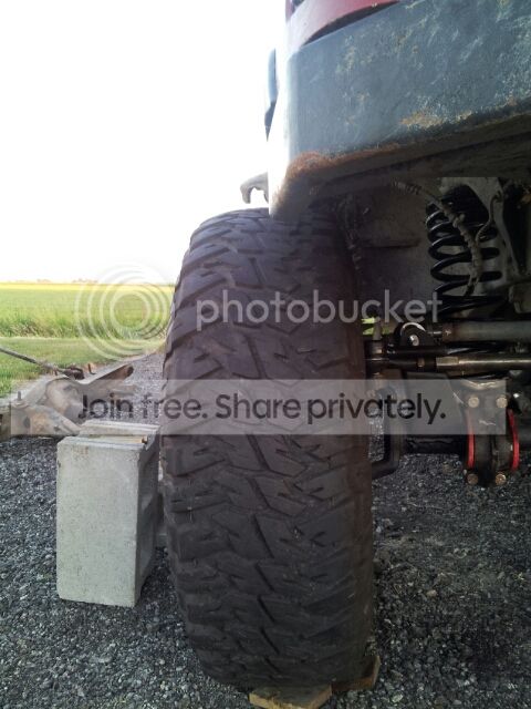

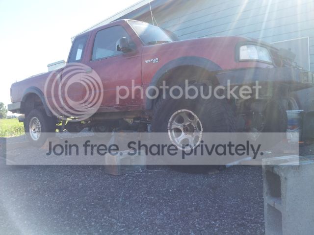

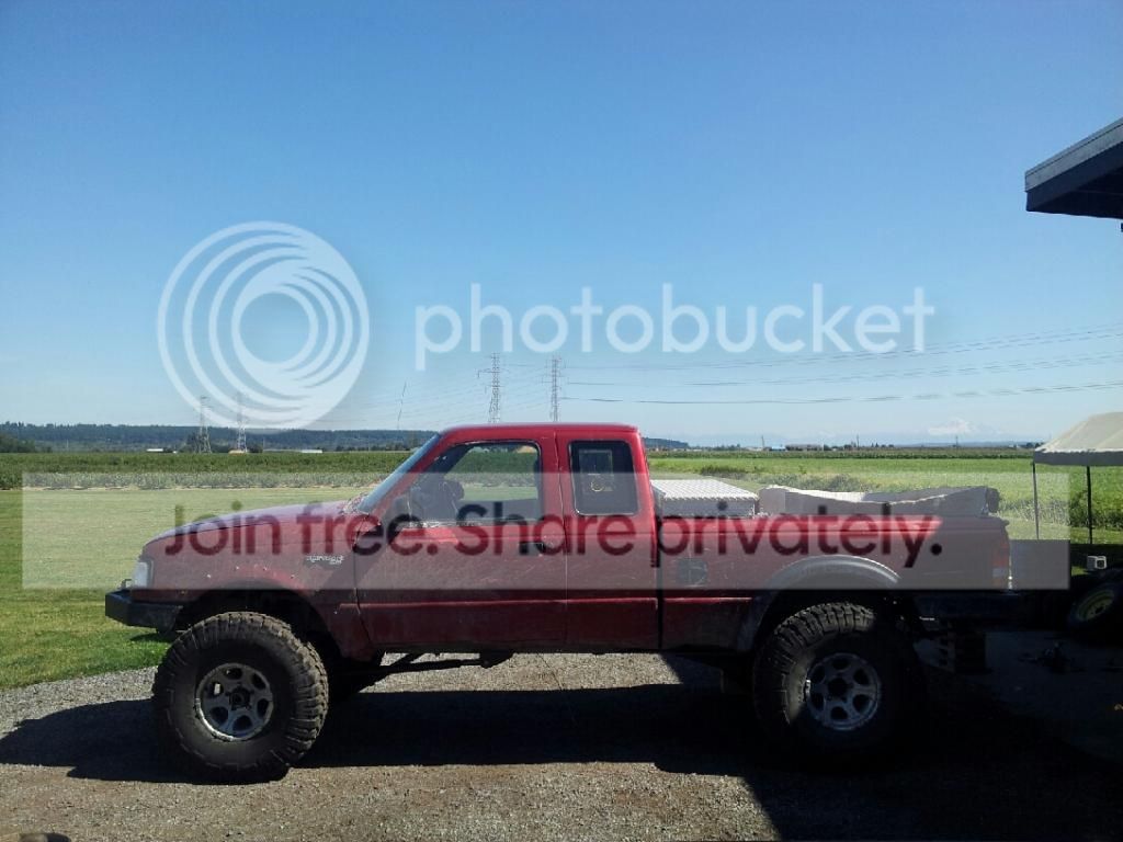

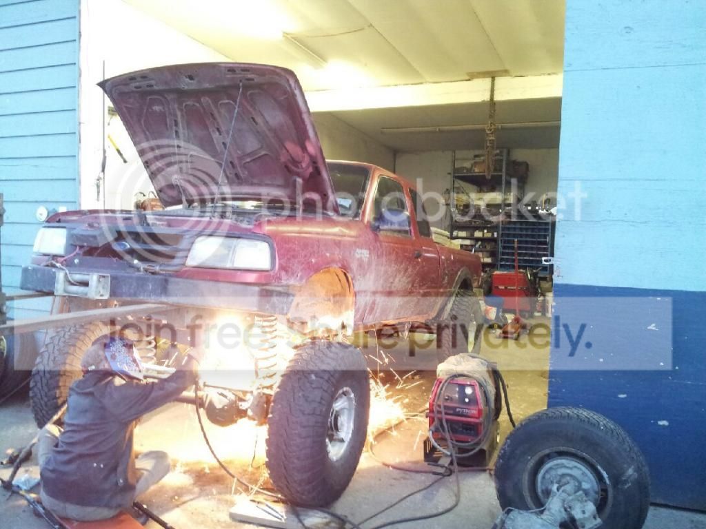

so this week I have been getting some stuff done because I need to get it ready for a camping/wheeling trip at the end of October. So with week I have got the rear axle mounted, the front crossmember cut so the trac bar doesnt hit and my coil retainers in.

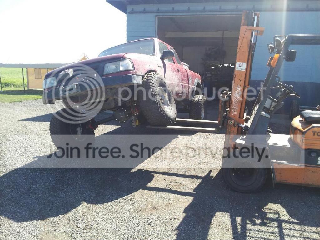

So that means I got to move the truck out of the shop and test the flex on it.
cutting the crossmember

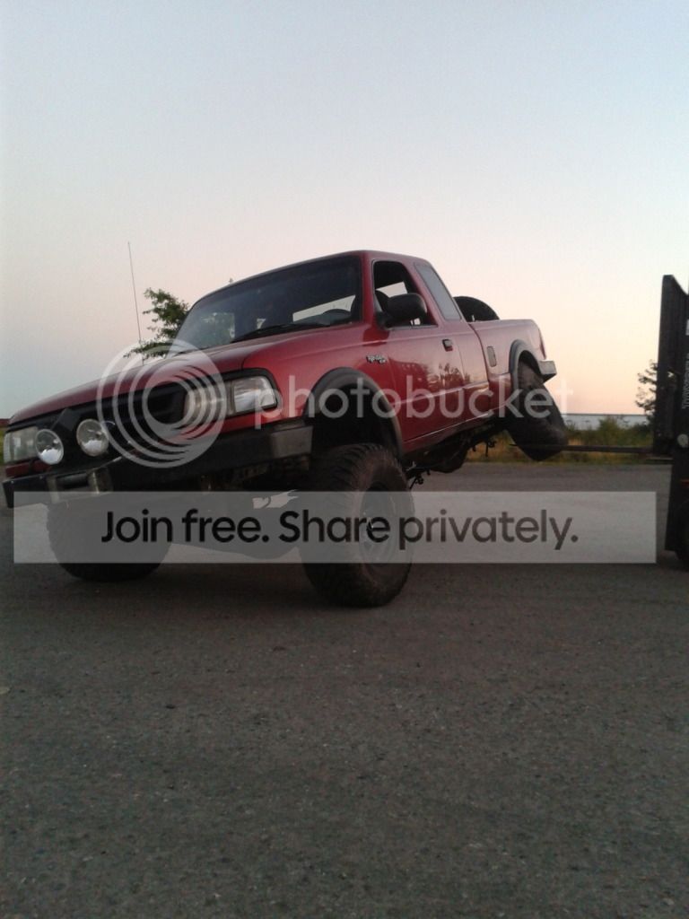

moving out of the shop to test the flex and if anything hits
Im pretty sure it could go farther but I gotta trim the fenders and bumpers first
front stuffed
Rear stuffed
