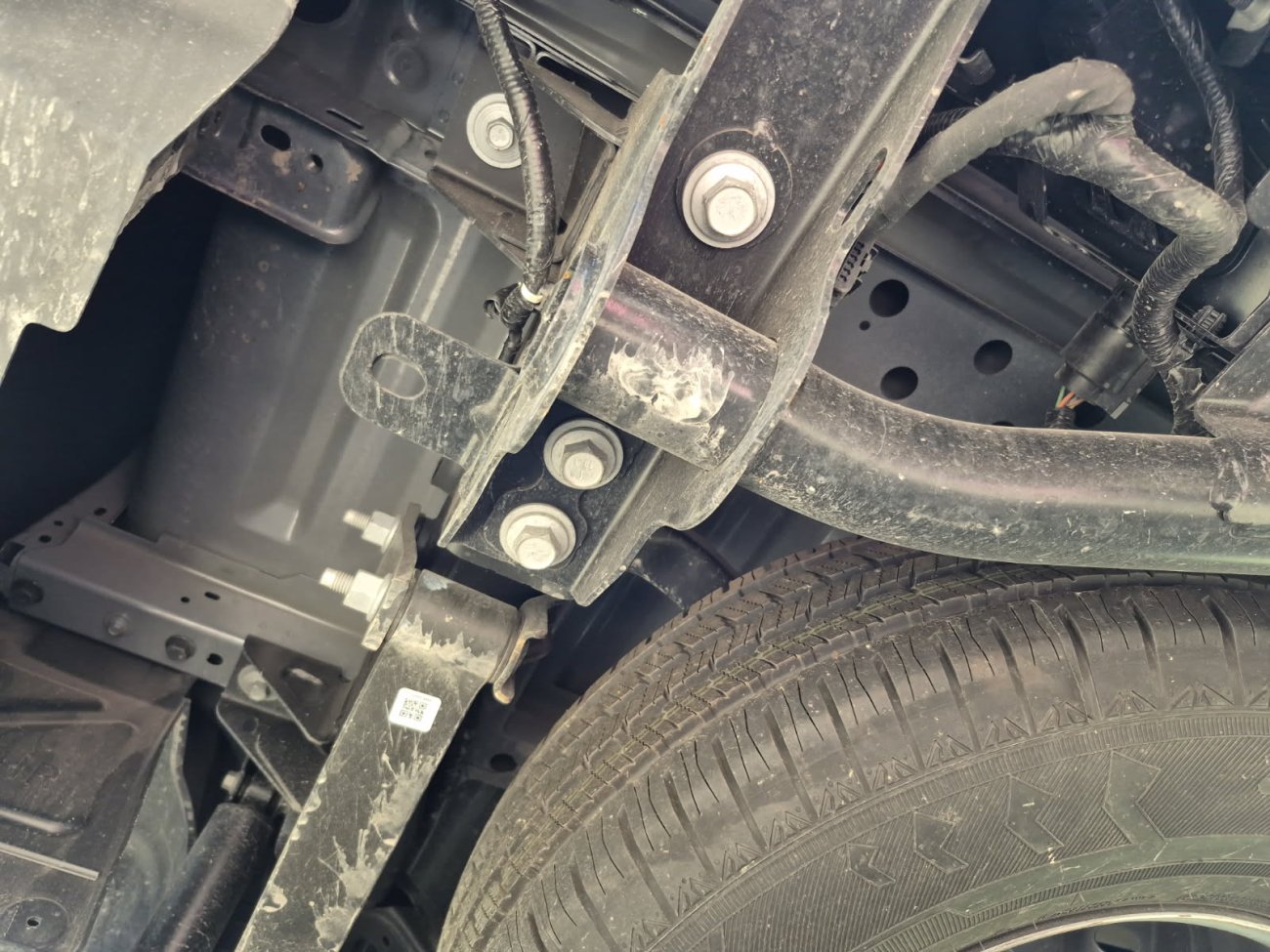

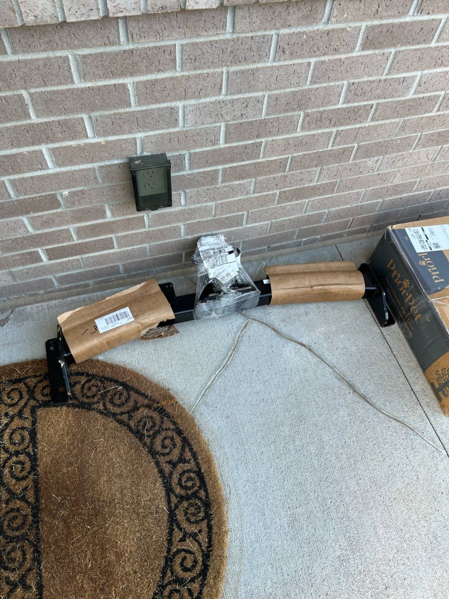

My son has a 2024 stx 4x4 and i have a 2024 stx 2wd. His came with no hitch and mine came with a factory hitch installed.
So we ordered a curt hitch for his.
Since he is in nebraska, i took some pics to show him how my factory hitch is mounted so he could have an idea of where it goes and what to take off.
Buttttt, turns out his frame and mine have different mounts on the back for the bumper and hitch holes. I have three bolts per side and his is like a 19-23 ranger with 2 bolts per side and luckily the curt has two bolt holes per side.
See the pics:
Hitch differences, 2024 4x4 versus 2024 2wd
Curt hitch
2024 2wd factory hitch
