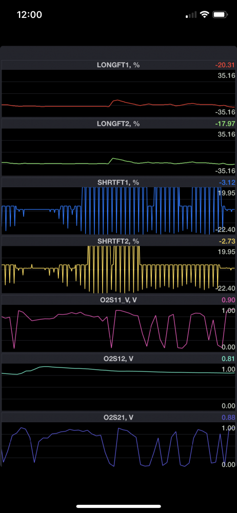

I have a 2000 3.0L FFV that is having high negative long term fuel trims at idle, and I'm not sure what to troubleshoot next. The trims stabilize around -8 LTFT/+2 STFT when driving, but will spike to -15 after pulling off the freeway and idling.
I bought the truck 5 years ago and discovered it was misfiring badly due to low compression from bad valve seats (common 3.0 issue). A rebuilt set of heads fixed the issue and the truck ran fine. Last year, the heater hose coupling failed and I lost all coolant and warped the heads. I resurfaced the heads and truck has been running fine once again. Recently it started running a little rough at idle and I'm trying to track down the root cause.
I've performed the following troubleshooting items:

Driving at cruising speed -

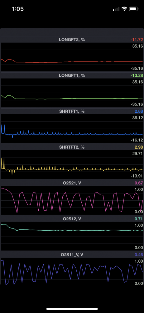

After exiting freeway and sitting at idle:

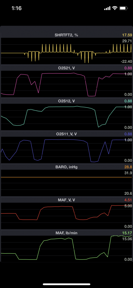

WOT in 4th gear-
